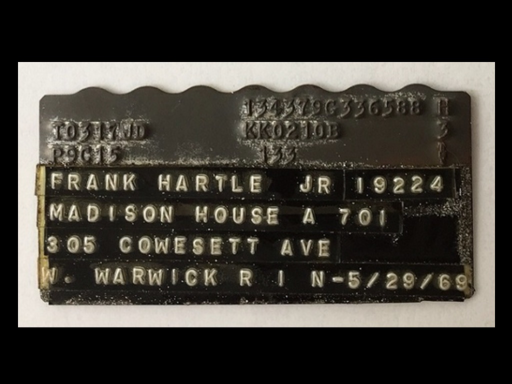

Thank you Steve... I just received my NCRS shipping data report and I have attached the information that they have provided. I believe that the address for dealer was
Norwood Motor Co
1338 Post Road
Warwick, RI

I just wanted to update the information on this car. I have just got off the phone with the original owner Frank Hartle Jr. He is the original owner who bought the car new in 1969 from Norwood. He has also informed me that the car that I own was originally an L89 (aluminum head) chevelle from the factory.

If it was originally an aluminum head car it wouldn't have had an engine suffix code of JD that you show in the pictures, if that is the protector plate it wasn't an aluminum head car from the factory.

Congrats on finding your car's original owner and history. It appears Mel Perry gave your Chevelle some of his modifications before the car went out the door. Keep digging. Hopefully the original owner still has some documentation (build sheet, POP, photos, etc.) to support what options the car was originally assembled with, and the modifications he says were made by Norwood Motors.

The original owner (Frank) said that the engine had been removed and that it originally did have aluminum heads. The stamping on the cars pad looks like it's original? But, may be a re-stamp? The original owner said that the engine stayed in the family and he has reached out to that family member to see what had happened to it. Frank said that the car came with ladder bars and el camino front springs from the dealership. He said that the air cleaner plenum was incorrect to the car and so were the side stripes. He commented on Patrick's post of the L89 because of the obvious similarities.

That is great news that you found the original owner and he confirmed what the car is. I was surprised nobody said anything sooner, both the engine and transmission are restamps. I didn't want to be bashing in a for sale thread or be the first to say something.

Then how do you explain this?
Because it contradicts what the original owner said & looks authentic to me.
