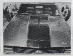

This would be a 'rare' triple COPO. Supposedly ordered out of Courtesy Chev, Sebring, OH. The hood stripe was a single Z/28 style stripe down the center of the hood and upper grille panel.
A ZL2 SS is also known to have the COPO stripe.

[QUOTE=William;1452996]This would be a 'rare' triple COPO. Supposedly ordered out of Courtesy Chev, Sebring, OH. The hood stripe was a single Z/28 style stripe down the center of the hood and upper grille panel.
William .....does the car exist ?

[QUOTE=Charley Lillard;1453115]
I got that WS from the original owner years ago, not very conversant otherwise. He believed it became a full-time race car and was heavily modified last he knew. I didn't get a VIN. Could still exist.
The COPO striping was just like the Z/28, extending to the leading edge of the upper grille panel. This is from an ancient US Camaro Club ad. The owner of the car was looking for others.
I'm sorry Charlie. It just occurred to me you won't be able to sleep until you find one!
