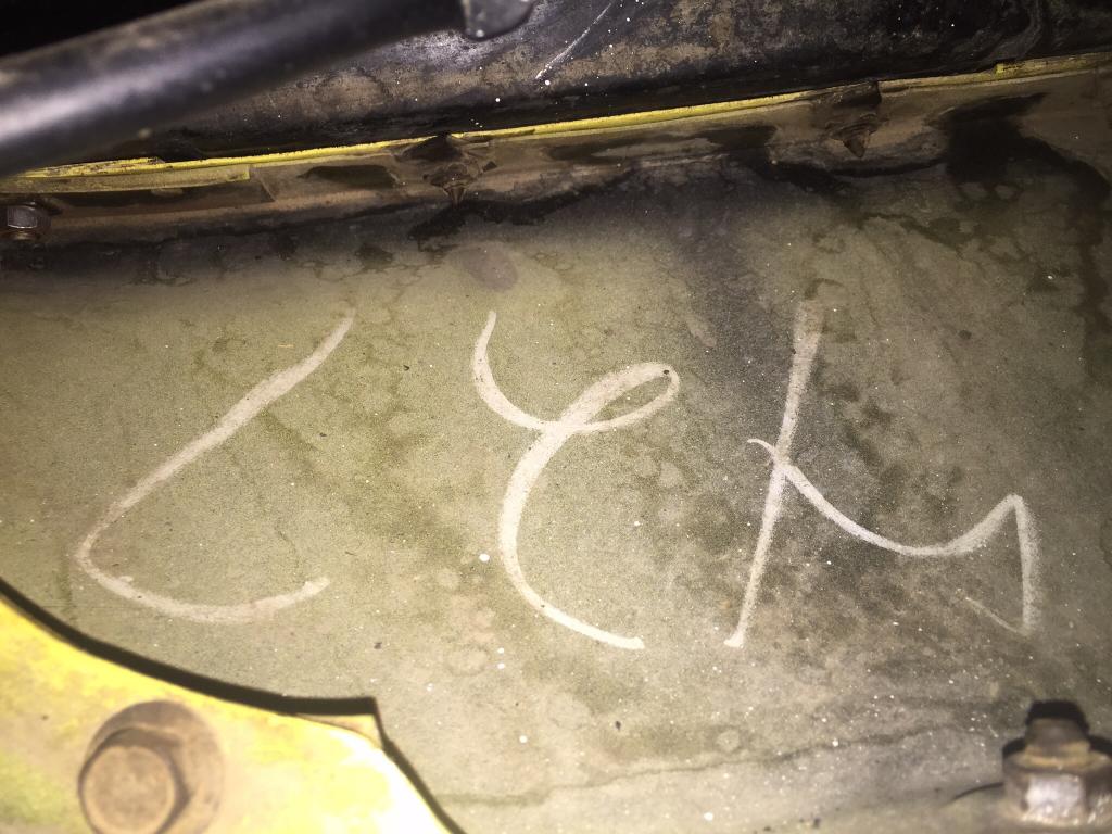

Box 104 on the BBC is for the fender emblem.
Very limited data indicates C for 307, E for 396, F for 350, G for Z/28, H for 327. Wonder why COPOs had 427 written there as they would have the same piercing and no engine ID emblem as the base 230" six cylinder.
Also, COPOs and Z/28s [non RS] have the same YA piercing code. Non HP cars are XA.
The scribbling on the extension may be tribal knowledge.

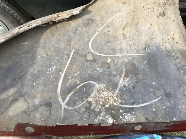

Here's another. This was a true SS with style trim w/o R/S. Fender run number 37. I don't know the engine size. Fender is damaged there...Joe

FYI this is not just on 69’s. Have a few 68’s with R6. I originally thought it was for 396 RS but that is out the window.
If no one else has a spreadsheet going I’ll look for mine in the am.

My memory is failing me. It’s 6S and this was from a 68 SS/RS 396 convertible.
Thanks Bill! I got caught up in looking for fender extension pictures that I forgot this.
C - 307/327
D - L22 L6
E - 396
F - 350
G - Z28
H - 327 (no idea why this car isn't C)
And:
M - Z21
R - RS/Z22
And there's your 69 decoding ring.
