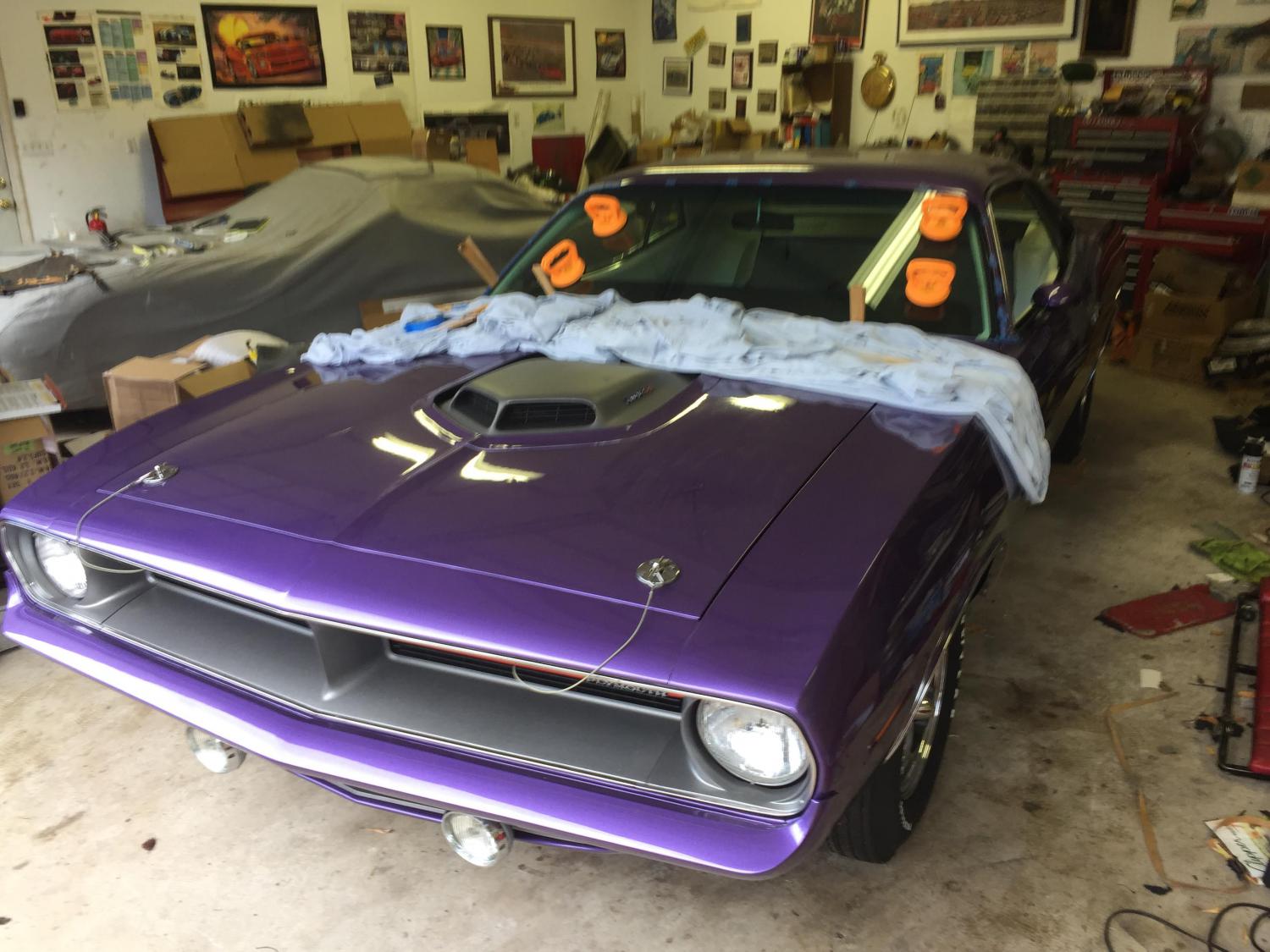

The Boy and I installed the windshield today.
I had him watch around 30 seconds (about as mush as either of us could tolerate) of a Graveyard Cars episode where they had a couple glass guys install the windshield on a 71 Limelight Green 'cuda (and randomly dubbed in a 70 Challenger install during the scene for no apparent reason other than it was also Limelight).
We then wandered out to the garage, stuck the four suction cups on the glass and plunked it in place. I had already placed the 5/16" butyl tape in place last night. It all went in uneventfully.
It took a few hours for the weight of the glass to gradually settle down and seal all the way around. I had to stick in the rubber blocks as well as some wooden shims to keep it fromm drooping down but it seems to be holding now.
The AMD glass is nice and thick, like an original windshield. It even has a Chrysler logo in the center like the originals do.
Sorry for the blurry photo. I did some black friday shopping today for new phones for the wife and the boy. So I can get one of their more modern hand-me-downs when they come in.

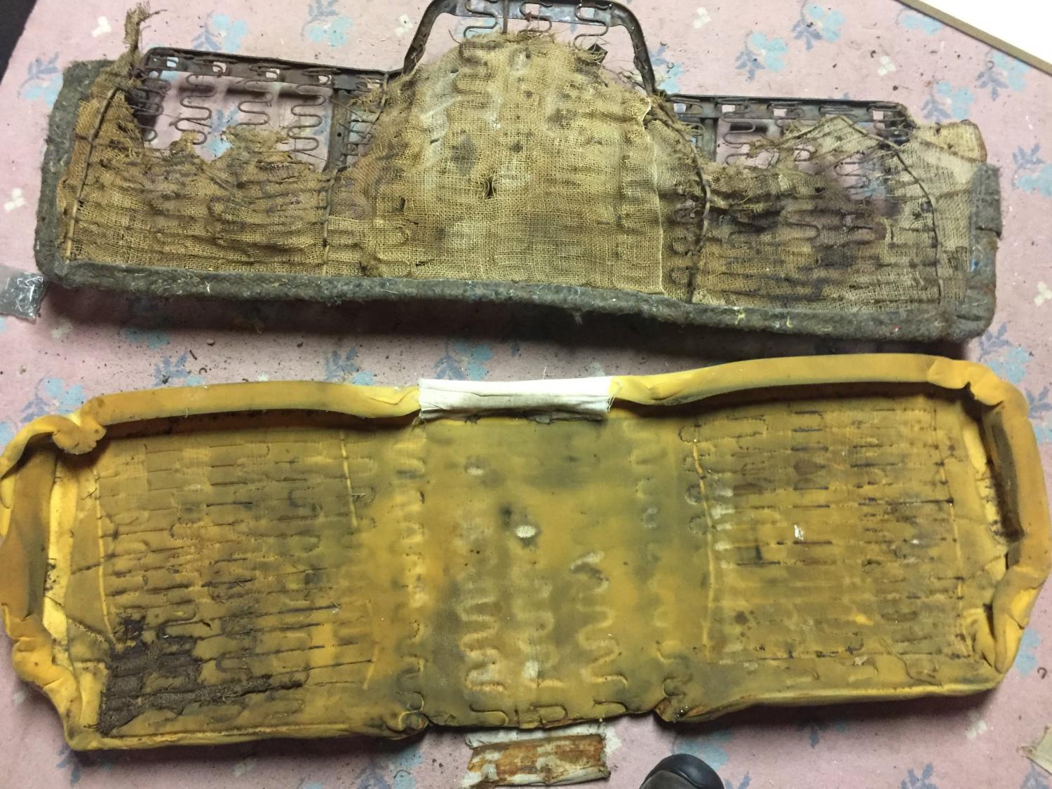

More finagling around today. I stripped all the upholstery off the rear bench seat cushions. Now there's a few hundred broken hog rings flung all over the basement. That was some nasty foam, burlap and stuffing there. And lots of mouse poops. I was surrounded by all three of cats at one point or another during the afternoon while they supervised my work. I guess they smell the mice residue.
I ordered the full rear bench installation kit from Legendary. Thay had it in stock and it is supposed to ship out monday. Sure is expesnive but it does have all the needed material: raw cotten, burlap, muslin, foam, etc., in one kit. They were having a 20% off sale today, too.
