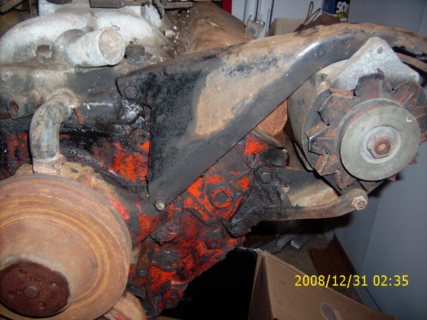

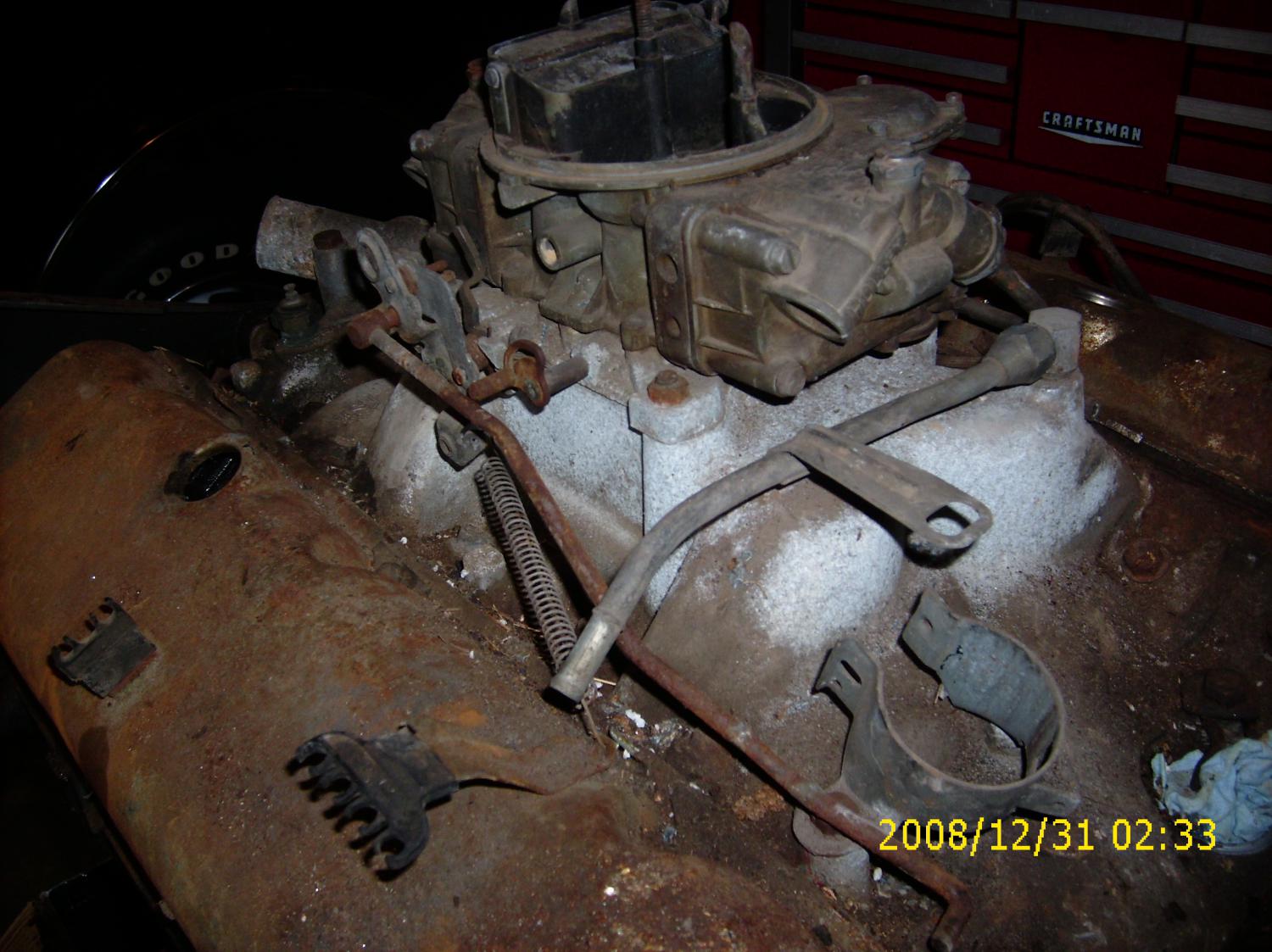

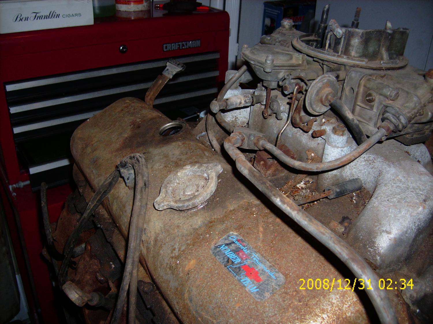

I hope I didn't say or do anything to close that door. It's out of my hands at this point. For now I just need to be content that it's still around and that I know where it is. Here are photos of the engine when it changed hands before being rebuilt. These were shared with me by the current owners.
Jose Betancourt

Look at the second engine pic, the fuel pump to carb line is correct not like most repop ones on cars. Third pic I bet that is the original alt., black fan deep groove silver cad pulley.
Probably the original 3910 on it also. Hope you get it back someday.
The carb date is 724, also note original 67 only valve covers, DG water pump flat rolled loop short dipstick (it's salmon color i have photos of the engine after rebuild). Interestingly, when speaking to the current owner of the engine, he mentioned the casting numbers didn't match on the heads although they were original. I'm guessing it had one 391 and one 840. Although he could have meant the dates didn't match.
Interestingly I know engine 7N212552 also doesn't have matching casting numbers on the heads after speaking with the last owner of that engine. (It is located in a pacer as NOM)

I noticed the correct valve cover. Another good piece is the upper alt. bracket, notice it doesn’t have the throttle spring return bracket on it . 67 Camaro only but I think that bracket was used on 65 n 66 big block cars.
Never heard about mis matched casting numbers on the heads before. Hmmm 🤔
