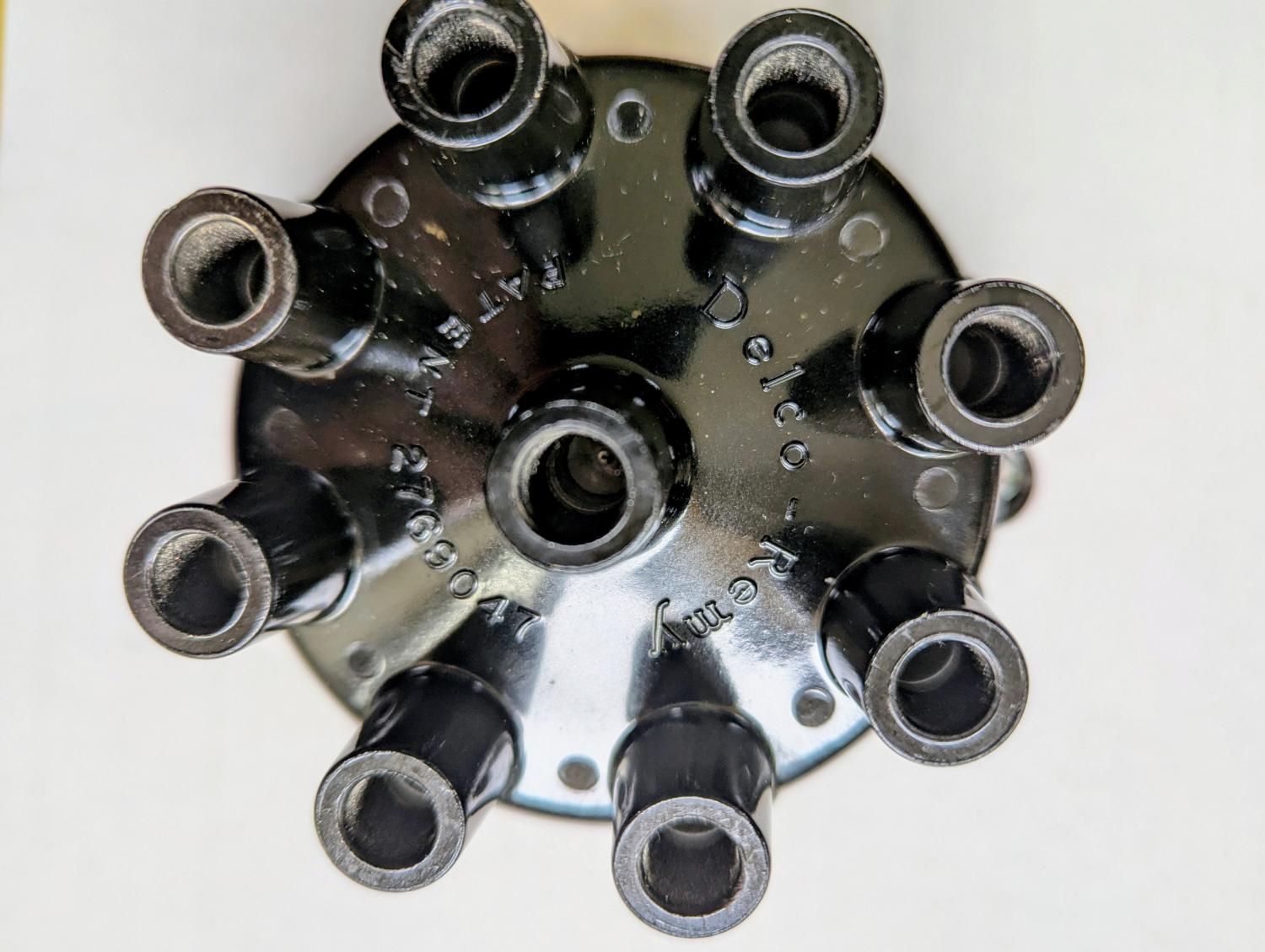

What is correct DELCO Distrib Cap for 1970 Z28 ???
I have this with Delco - Remy R & PATENT 2769047
AND I also have a similar Black Cap with NO LETTERS/NUMBERS
Chuck Sharin
[email protected]
69 Camaro COPO "recreation"
Attachments - The Supercar Registry unnamed.jpg unnamed (1).jpg obrcaptop.jpg obrcaptop.jpg

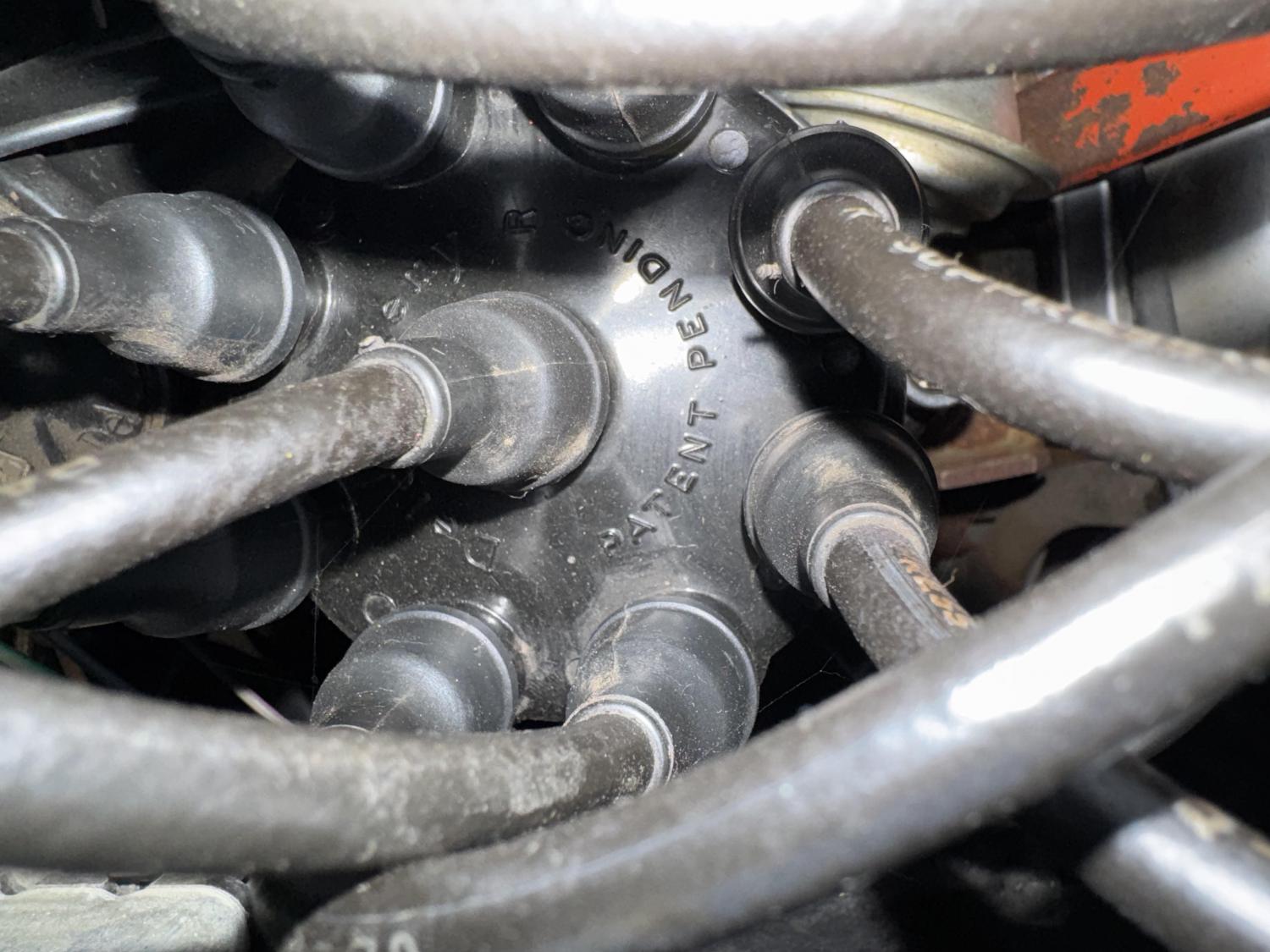

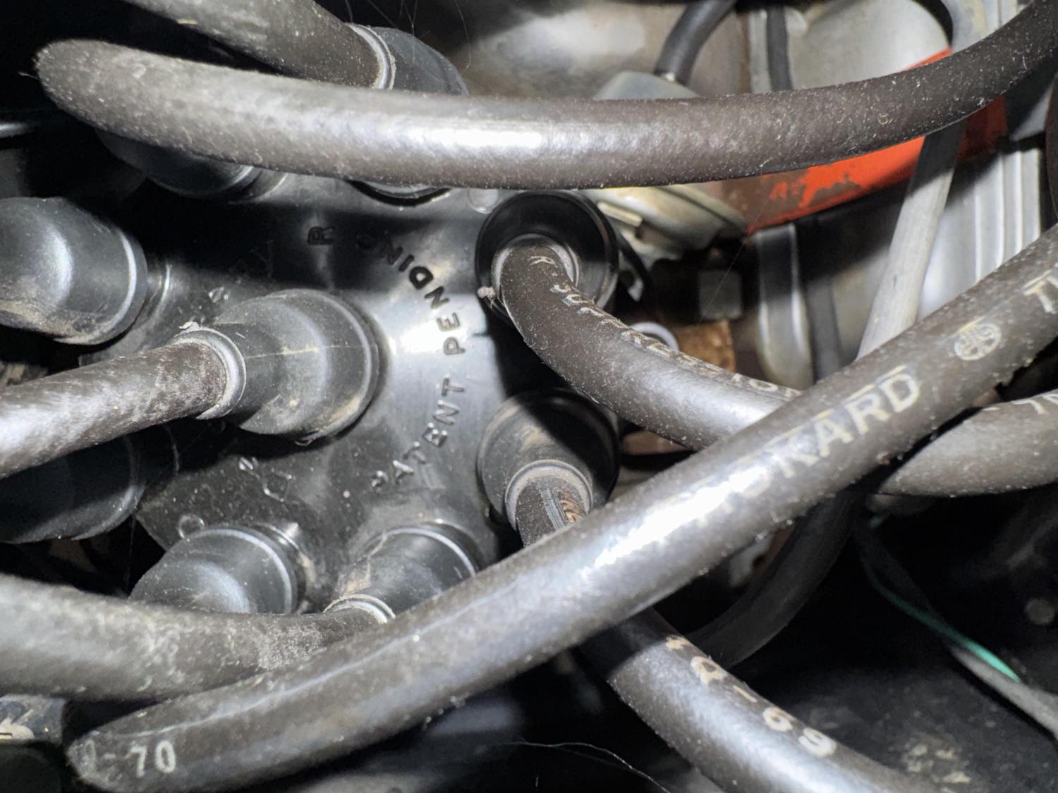

The 1970 Z/28 would have had the "Delco Remy" "Patent Pending" R distributor cap from the factory. The "Patent" 2769047 and the cap without letters would be a service replacement cap.

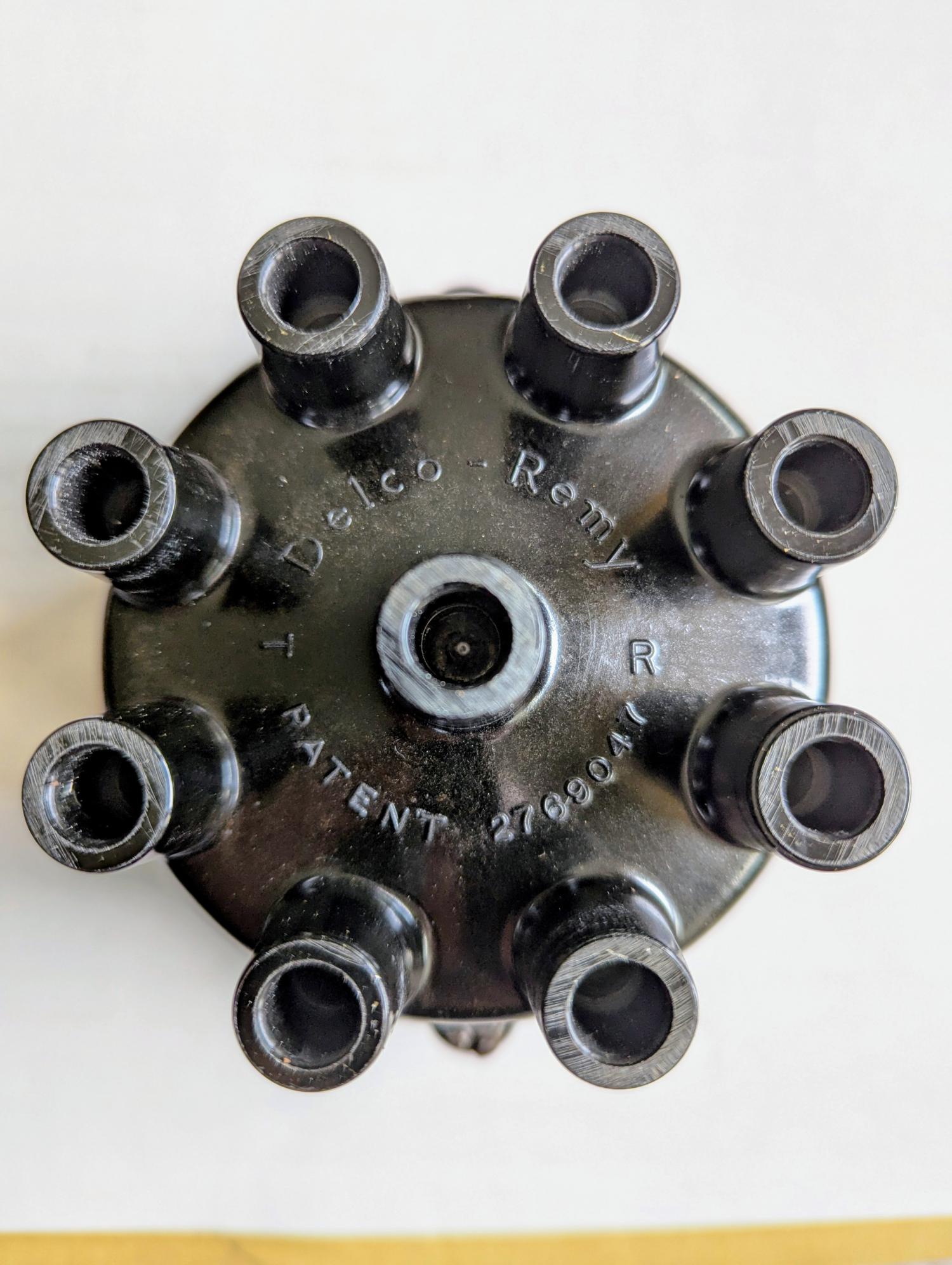

Chuck, the cap you have in the picture is not assembly line correct for a 1970 Z/28. The cap is a later style replacement cap that was used in 1973 production. They made several different versions of this cap. The one you have 2769047 with aluminum contacts, 2769047 R both with aluminum and copper contacts, and some had other letters like T and BH on top of the cap.

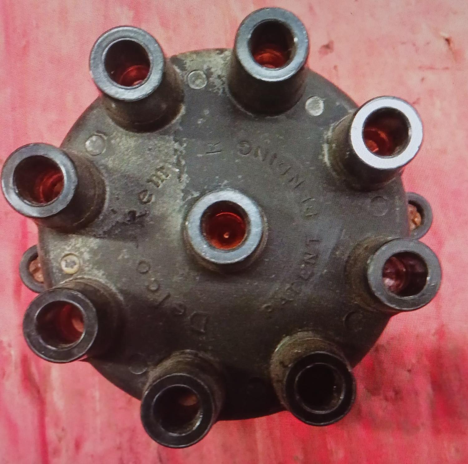

early and late "patent pending" caps.
Pic 1 is earlier type. No "R"
Pic 2 is later type with "R".
They are saying you need bottom type.

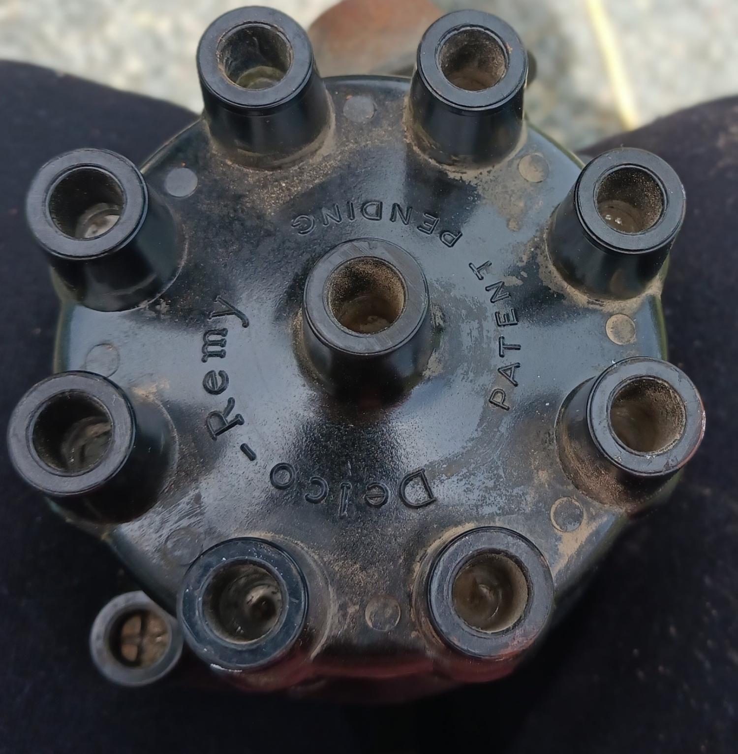

----Part number 19719244 in a GM restoration box with just Delco-Remy and patent pending would be for what years and vehicle???....Bill S

"Patent Pending" cap is for 1968 and earlier for all GM models.
