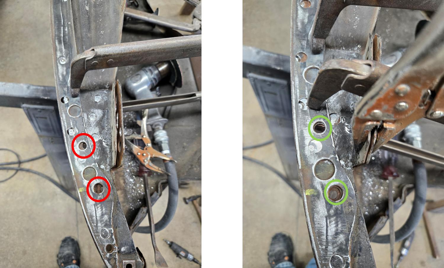

Default NOS Sheetmetal and what to know before buying
So I think i have said before NOS sheetmetal doesnt always mean your getting something new and perfect. In many cases as i have been told numerous parts that never meet production standards were sent to the parts counter.
The passenger side fender i sourced clearly was an NOS over the counter part as noted in the first picture from where a gm sticker once was.
The main brace on the upper side of the fender that you see in the engine bay was installed more than a 1/4 inch off location. The nut for the front valence panel was so far off you couldnt get a screw in the hole.
In the second picture you can see the before and after i pulled the spot welds and moved things around. Even the location pin holes were either ignored or not noticed.
Clean new sheetmetal is great, but there always seems to be something you need to fix to make it right.
