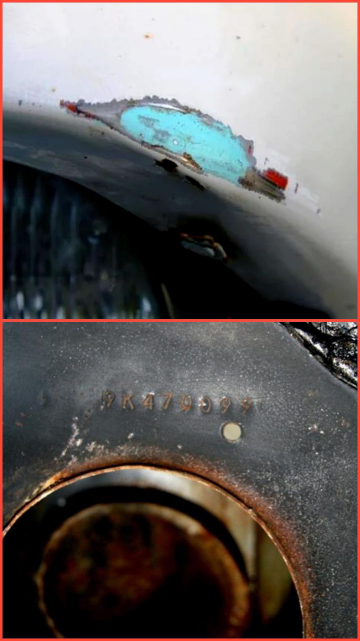

The holes for the SS396 Emblem on the rear panel have burrs and are still bright metal from having being fairly recently drilled. Lots of factory applied Monaco Orange overspray is still present in the interior compartment.
The RF and LF fender are not pierced where an SS emblem would have been installed.
The LF fender does have drilled holes from an old body shop visit - bondo is visible from the repair (not where the piercing would be on an SS fender).
The VIN number found beneath the heater core cover is the same as the VIN plate on the LH side of the dash.
The SS grille is held in loosely with only a couple of screws - most of the clips on the grille are broken.
Remnants of the two black hood stripes are evident on the nose of the car. You will notice multiple layers of Orange and Black . . .
Multiple layers were the result of a shop accident at Bill Allen Chevrolet when they replaced the OEM engine at around 12,000 miles and repainted the hood, top, deck lid and nose piece.
