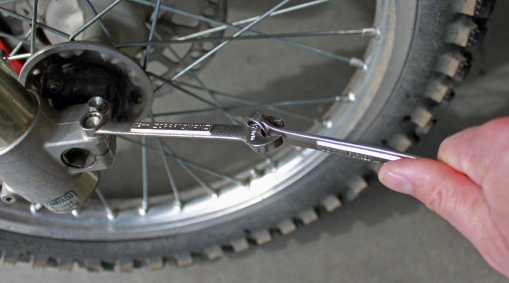

Originally Posted by TimG View Post
I worked on getting the fuel line off of the fuel pump on my '67 427 Corvette. This pump has been on this car since September of 1966 and the original line doesn't want to come off. There's no room to move the line wrench once I get it on from the bottom and it's hard to get leverage from the top. Any ideas from the group would be appreciated. I continue to soak it with penetrating fluid.
Sounds like you can get the line wrench on it from above, but can't budge it. Do you have room to do this?
