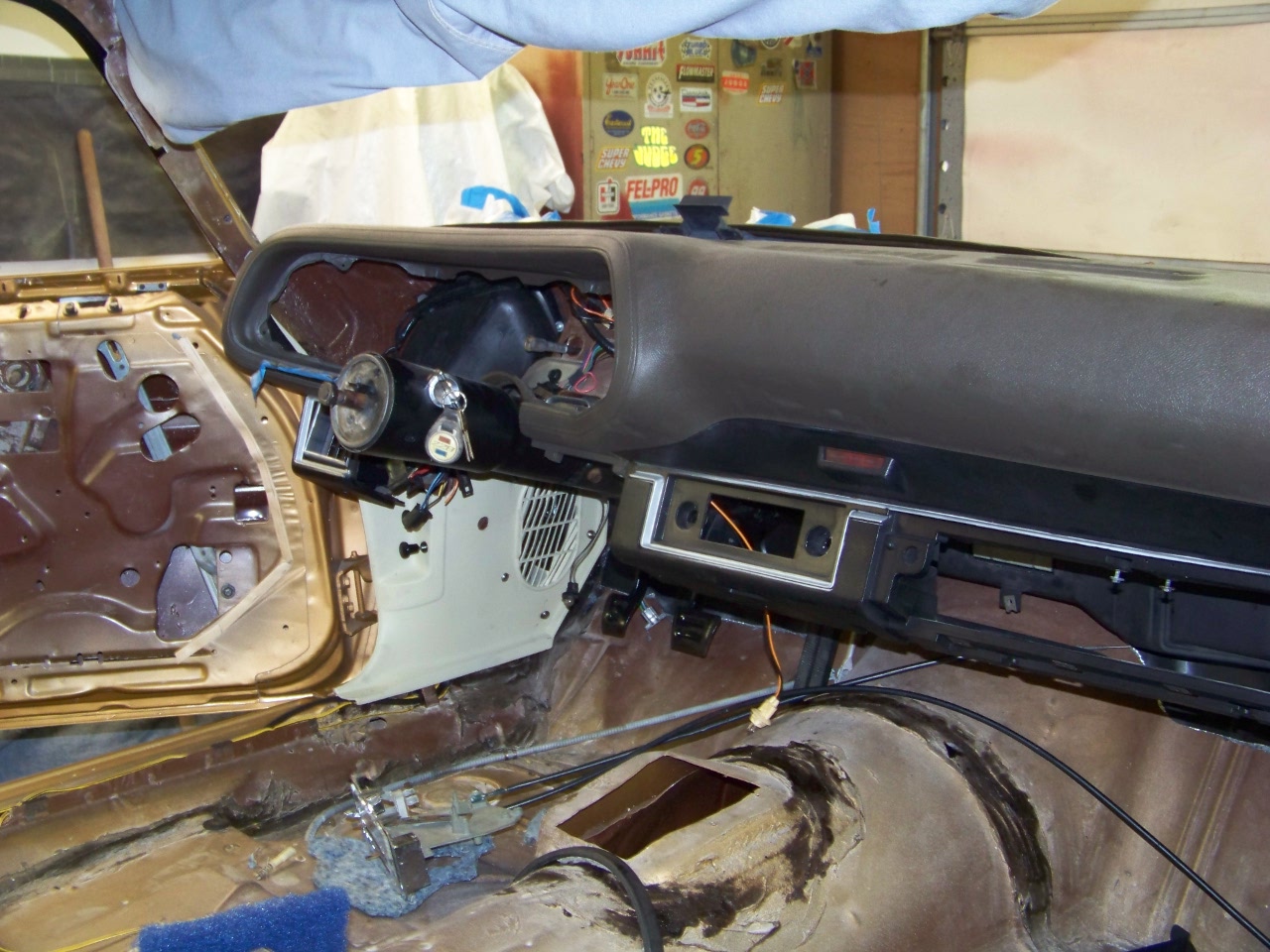

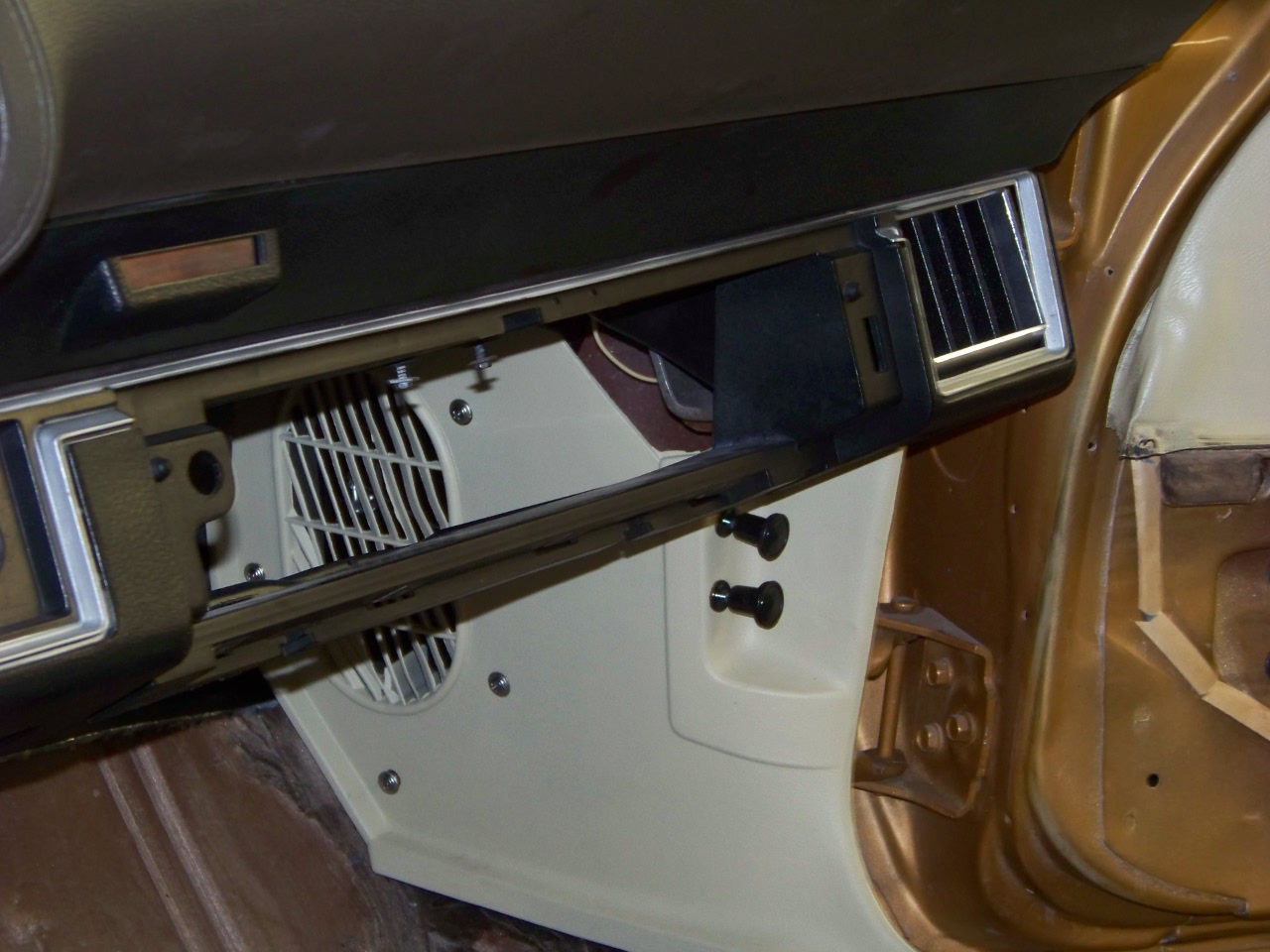

Working away, installed the kick panels, the rest of the vent assemblies and defroster ducting.
Placed a large order for carpet and under-layment, the plug wires, battery cables, rad rubber insulators, tons of misc little parts valve cover rubber elbow, etc...
I am looking for someone to plate the front and rear bumpers using only Nickel Chrome like the originals... Anyone know of anyone?
