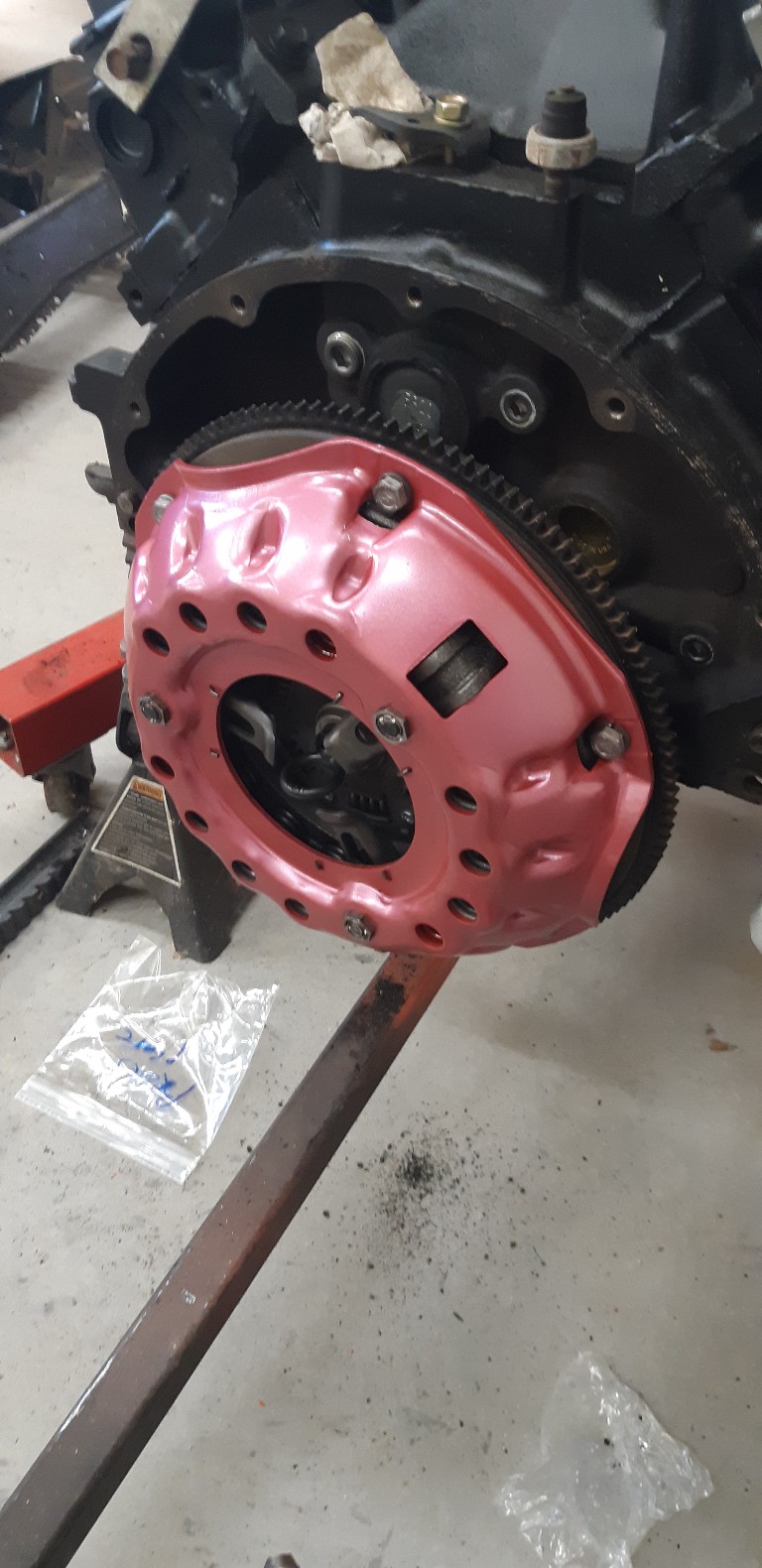

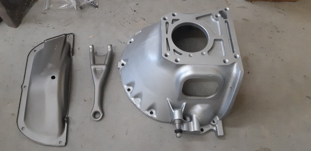

Time to start putting some of these new parts on this buggy! First up was the clutch. Brewer's supplied all my missing parts and Wayne is a great guy to deal with. Let's get that clutch installed!
So Wayne provided me with a roller bearing for the input shaft of the transmission. That came with an instruction sheet. Seriously? Pppffllppp... I've installed about eleventy some clutches.... what's different about this one? Well, lemme read it (paper crinkle sound) "All input shafts on Mopars may vary in length. To verify the roller bearing will not conflict with the non-tapered area A and B on the diagram, bolt the bellousing to the block and measure from the base of the [what the hell are they talking about? ] recess in the crankshaft to the bolt face of the transmission. Measure the distance between C and D on the diagram, subtract the distance from A and B [what's the bolt face of a transmission?] and solve for distance X. If that train left Chicago at 5:00pm traveling at 45mph, then that calculation must be less then first distance, A, that was measured from the train that left Sacremento at 6:42pm"
Ok, so after four stabs of the transmission into the engine, I realized what that all meant. It basically said that the trains collide in Sasparilla, CO.
Now, this just being a driver, I didn't go crazy with the detailing/ cleaning and such that I would if I was getting ready for a MCACN unveiling. But, never the less, I can't fight the factory marking bug!

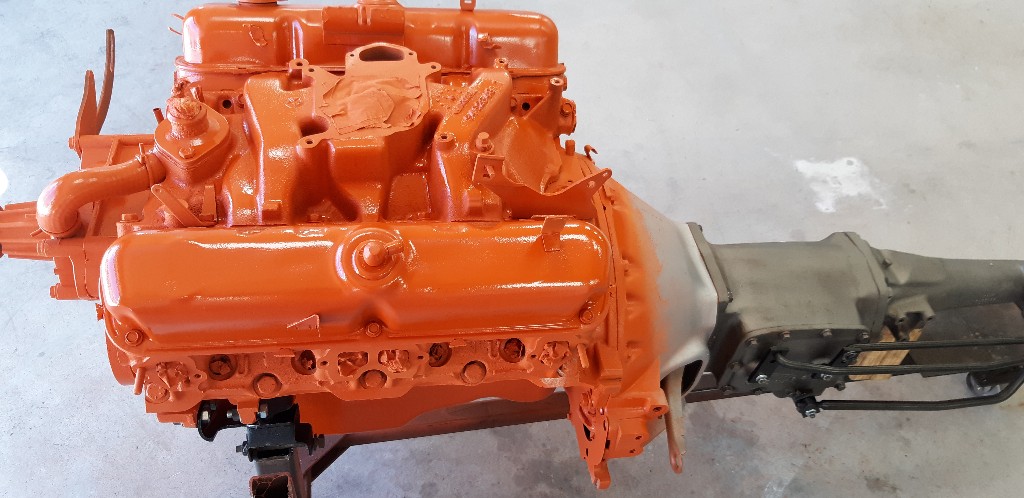

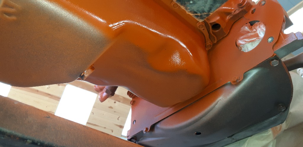

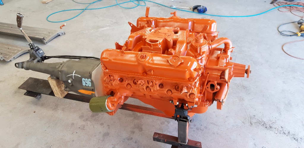

Being close to Halloween, it's Great Pumpkin time! What's a better Jack-O-Lantern than a Mopar motor? With everthing masked off, I sprayed 440 Orange over everything. Yes, these 340s in 1970 were not Hemi Orange... which... after spraying so many Orange things these last few years I can't tell what orange is what anymore! . That spectrum of my retna be blown out!
Now remember, this being a driver I didn't go crazy on the finer details like I will when I tear her down for the real restoration. But, me being me, I had to get some details in there. Overspray on the bellhousing and clutch fork, alternator bolts will have orange on them yet the brackets will be black, bare bottom oil pan, unpainted fuel pump and spark plug retainers. What I didn't do was attach the exhaust manifolds and spray them with the 440 Orange. This being a driver, I don't want all that burnt paint around and figured cast blast would be fine. Although I will be painting the heads of the bolts and studs to make it appear that they were on the engine, painted, and that had already burned off. So freaking fun!!!

Yes, everyone assumes Hemi Orange.....but that was used only on Hemi's....even with that, the Hemi's changed the shade of orange during the 69 model year. 70 340's were definitely 440 orange.
I imagine either those were spares or you will be painting the alternator brackets black.
Personally, I love the smell of burning exhaust manifold paint in the morning!

Yep, Jim. I'll paint those brackets black, don't you worry. I think we touched on this in email, but the vacuum fitting on the rear of the intake: painted or unpainted? From what I have seen, they are unpainted. What makes sense to me is that this fitting would be installed and painted, then if power brakes were optioned, that was removed and the proper fitting installed. But then again, was no fitting installed since it was a small port like the temp and oil sender holes which are unpainted?
Love the details!
Cheers
Dave
Old 10-24-2019, 01:20 PM
RS_COPO_Canuck RS_COPO_Canuck is offline
Join Date: Feb 2015
Location: Toronto
Posts: 326
Thanked 32 Times in 21 Posts
I would say painted on that plug.
Actually, the standard oil pressure sender (non Rallye Dash) was on the engine when painted....and crudely masked off. Seen plenty of originals with some overspray on them.
I should have mentioned it before....but water pump and thermostat housing, where the rad hose slides on....usually gets masked too....but you wont see it once the hoses are installed.
The fuel pump boss on the block....I believe was masked as well.
There is something with the block drain plugs too....they need to be Hex....not square. Also, I have to check my pics/notes....one side my be painted and the other side not.
