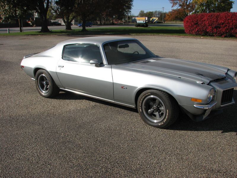

Originally Posted by 70 Forest Green Zee View Post
Rick...having been a big fan of cars that you have restored for many years now I know that when you finish this Chevelle it will be absolutely spectacular! Is you goal still to have the car finished and unveiled at MCACN in 2019?
On a side note....I would love to see pictures of the 70 Z28 that you say you are restoring now when it is finished. You can send me pics directly, pm me for my email address.
Yes, it will be at next years MCACN. Thank you for the compliments. Here is a before shot of the Z. Sweet car for sure and another M22, 4.10 car.
Rick Nelson

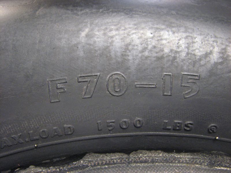

Originally Posted by JoeC View Post
Rick,
did you get any original tires with it?
what are you going to use for tires?
that is the most difficult part to find for a Yenko Chevelle
I did not want to say anything until I had them in my possession but I procured a set of 5 original dated Goodyear Wide Tread GT F70x15's along with 5 1/10/69 dated YH wheels over the weekend after a long road trip. The tires are in amazingly great shape with very low miles on them and most of the wheels are in original paint and in very good condition. They were NOT cheap by anyone's estimate but I want this car to be the best it can be.
Rick Nelson
