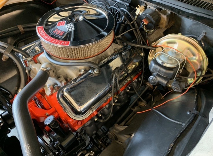

Here is a couple of pictures of the engine that is in the car now
