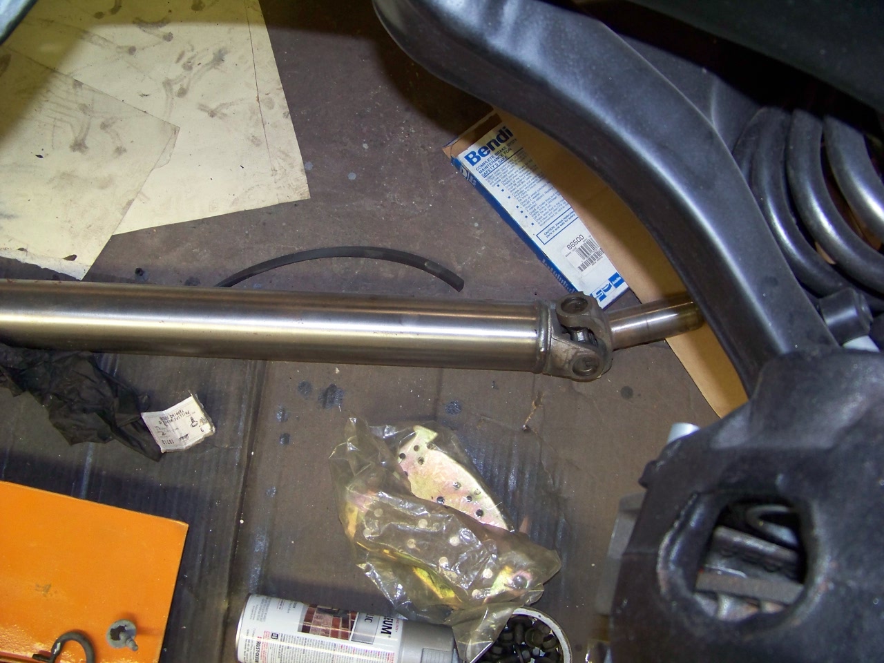

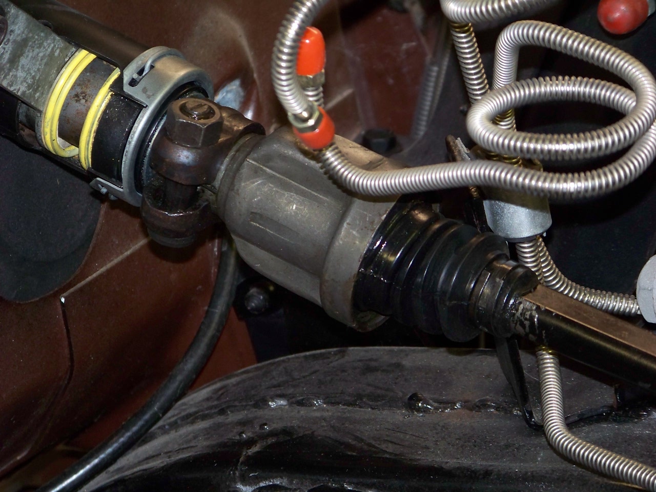

Replated the tail light sockets and replaced the lower steering shaft boot and lower steering column bearing... (same as a Jeep Grand Cherokee)
started putting the tar and jute underlayment in and carpet as well...

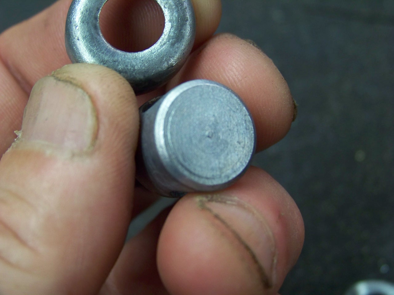

Coming along nicely, I plated more parts... the insert sleeve for the back drive bell crank - stamped with SPI.
