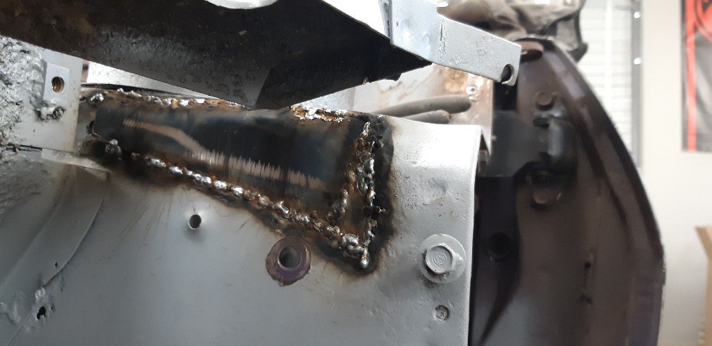

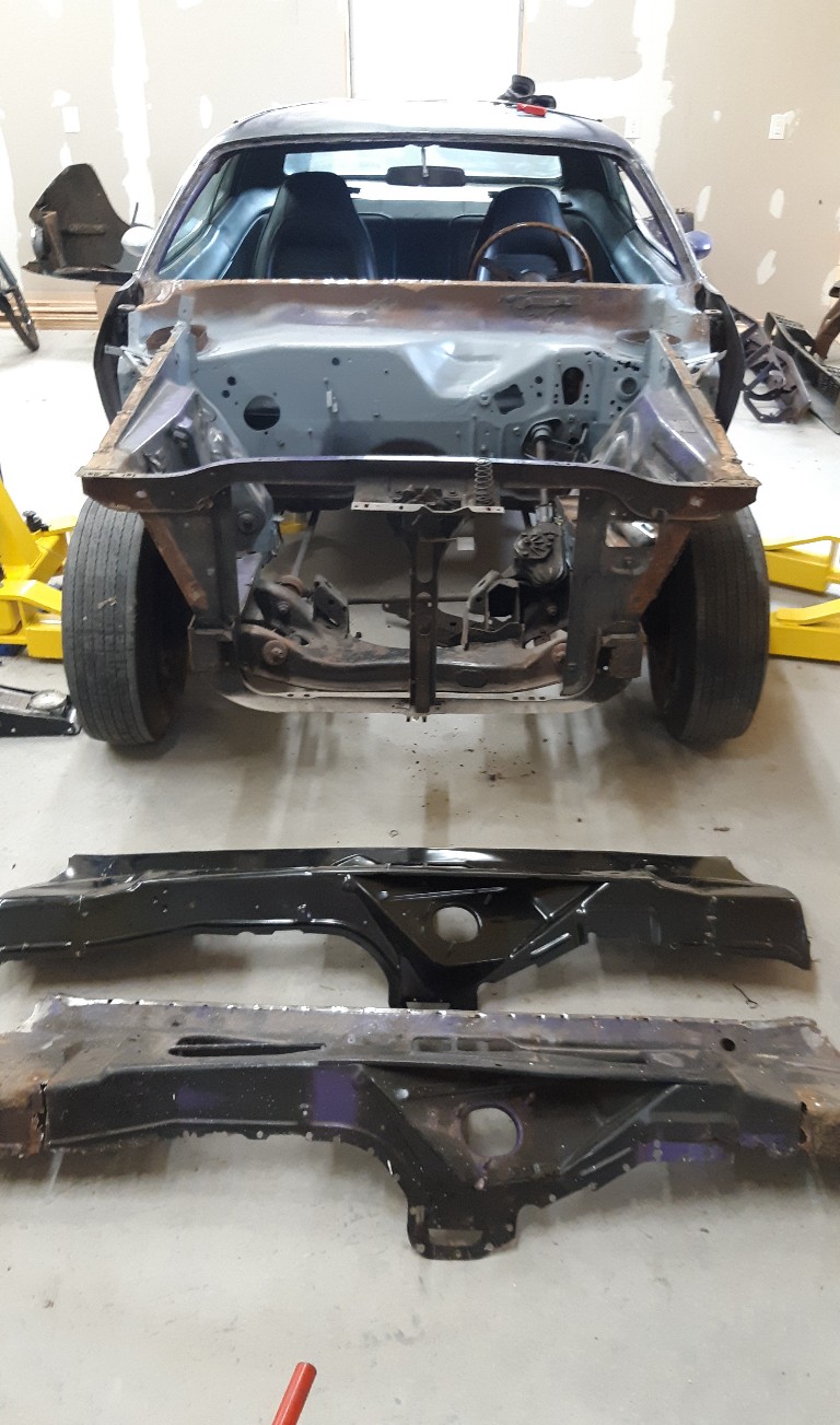

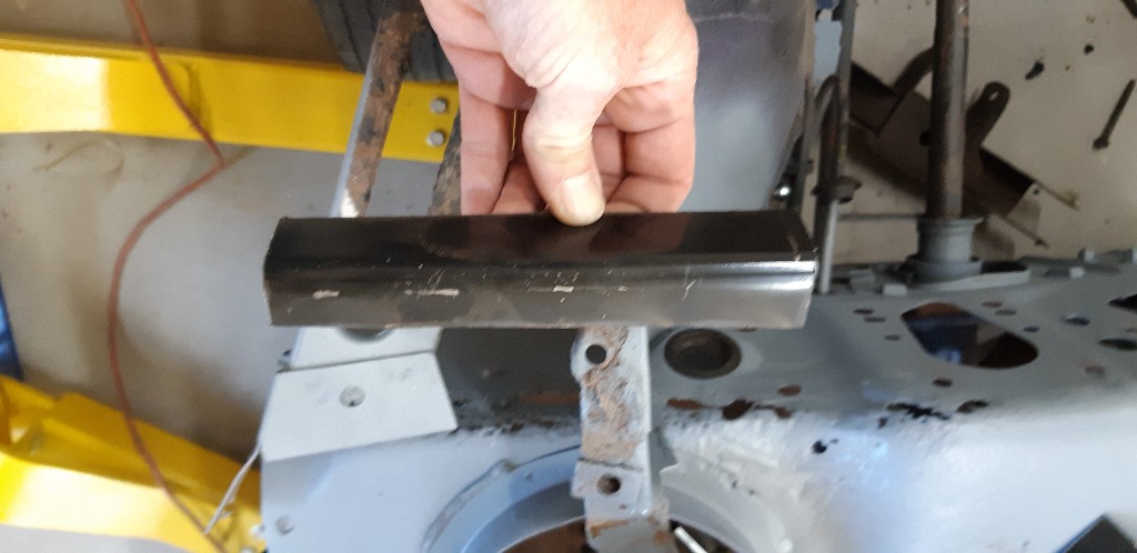

I made the executive choice to fix the original cowl instead of using the aftermarket AMD panel. While nice, there's a few stampings in it that aren't exact. Not to mention the VIN. So starting with the rotted edges first, I spliced in new metal from the donor cowl and next up will be patching the minor holes. Still some more grinding to do, but it's solid again and the areas that will be seen under the hood are smooth. The outer edges have undercoating sprayed on them so you'll never see this work. But that doesn't matter since I have to do it right or it'll bug the crap out of me!!
Interesting thing, there's a remnant of a parts tag around the dash retainer speed nut hole. If you remember from my Beater Bee, I found one if these between the inner rear quarter window brace and the quarter panel on the driver's side, still wearing V2 Hemi Orange. This tag wire still has FC7 on it!
Best part is I'll use the curved pieces of the donor cowl to repair the inner cowl area.

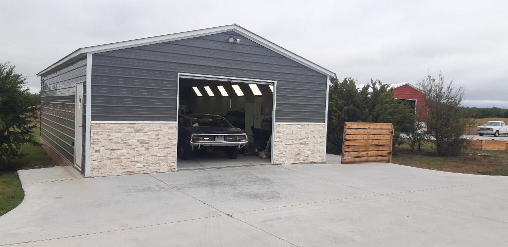

Had to move her over to the small shop since the truck gets the spot where she was sitting. But since it's there, I might as well take advantage and patch up the lower cowl/ firewall then weld up everything before moving it back over to the main shop.
Nothing cooler than a Cuda sticking out of a shop! More next week!

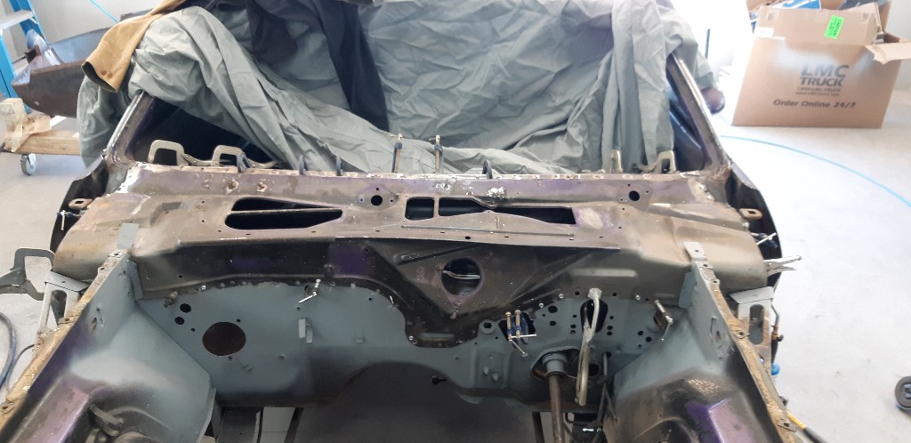

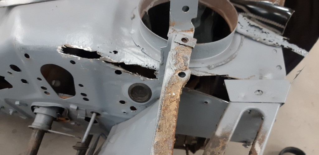

I decided today, while on Reserve, I might as well try to bang the cowl work out and see how far I would get before a call. But first, I sat behind the wheel and made some engine noises. You'll see the the second pic is when I hit second and floored it!
Anyway, first up was the rusty metal repair. I was able to cut and splice everything that needed to be repaired using the AMD panel. I then sprayed the underside of the upper cowl and the lower part of the cowl on the car with Eastwood's Ceramic Chassis Black. Why? Cause that's what I had laying around!
After welding everything up I went back and cleaned up the plug welds. I'll finish this later during the real restoration, but for now, good enough for a driver and it's 100% rust free! Going to dust some spotty FC7 around to give it the worn patina that it originally had and blend it with the rest of the engine bay.
That it! Cowl done!!! Time to get that engine back in!! Then maybe I can make some real engine noises!
