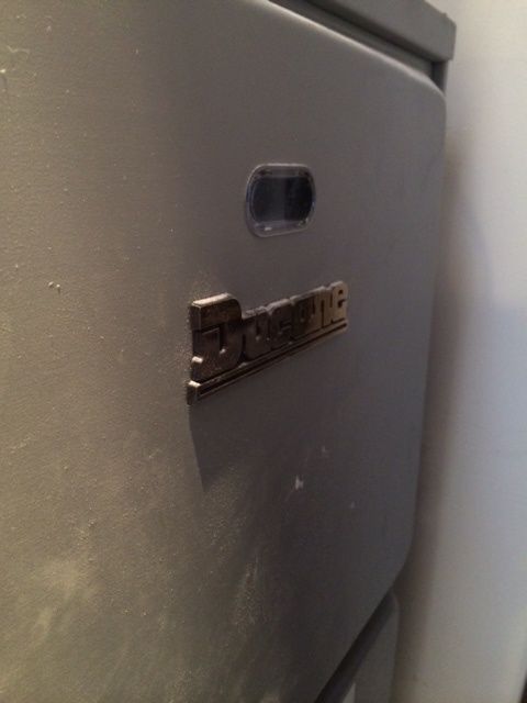

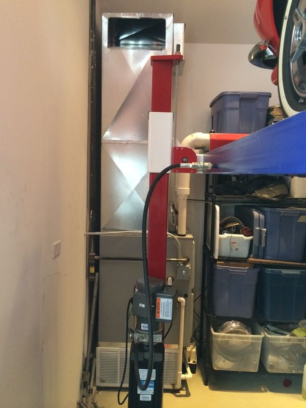

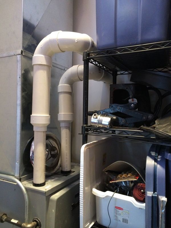

Here is a shot of of where my furnance blows (I hated the ugly ductwork that ran along the top of the wall, it screwed up the open look I had before the ductwork went in). Furnance works FINE without the duct work but I do fear I have too close of an air return path, but <span style="font-style: italic">for now it is fine for me</span>. My garage is essentially 50 x 24~30 and I see no reason for ductwork, it is the same temp all over the garage. I do have plans to install a fan at the top end of my ceiling in the open area (not above car lifts) to create more of a drafting (suction) effect on the furnance. Electric and bracing already there.
I went with a lennox knock off furnance (Dukane) (I think 93% efficient). A local fireman installs these on the side and gets them close to cost. It was stupid cheap for the whole setup, and he had it in under an 1hr before he added the other ductwork I since removed. Furnance has worked well. I did not want a system that would take air from inside the garage for combustion.

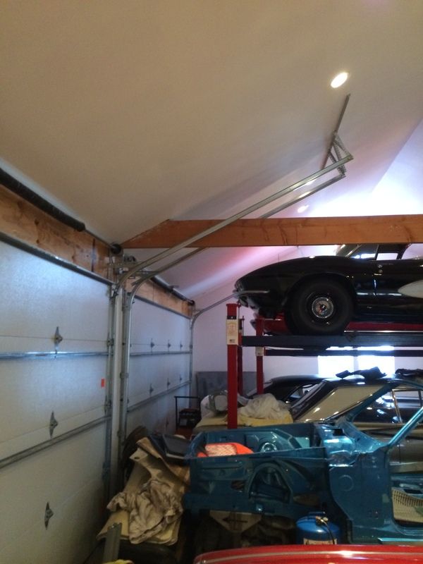

Below are the garage door rails that hug the truss ceiling. I have gotten a lot of compliments from car buddies on that. I highly recommend doing this if you can.

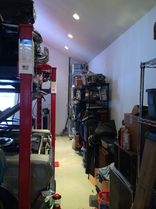

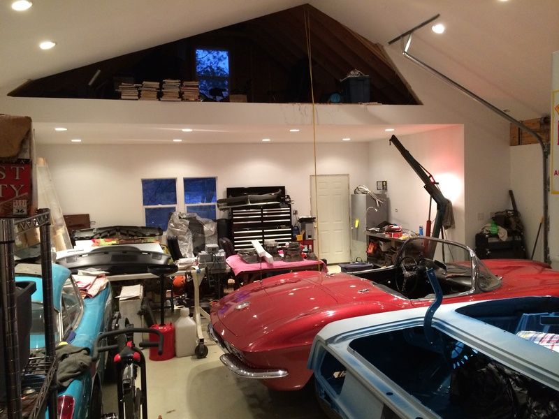

Below is my crazy work area. Only good things are I am actually using the space now. I got a stainless table at cabellas that they sell for meat preparation, that is a TANK! It was only $75 during a sale and I want to get a few more. Check them out, I plan to work on a transmission on one this weekend. Tomorrow my friend brings over the engine for the vette so we can start getting the car 'gone', then I can put 4 wheel discs on the cuda convert. I got my tool cabinet on a black friday sale, so I finally got a clean organized place for my tools! I am very happy with the HD craftsman box.

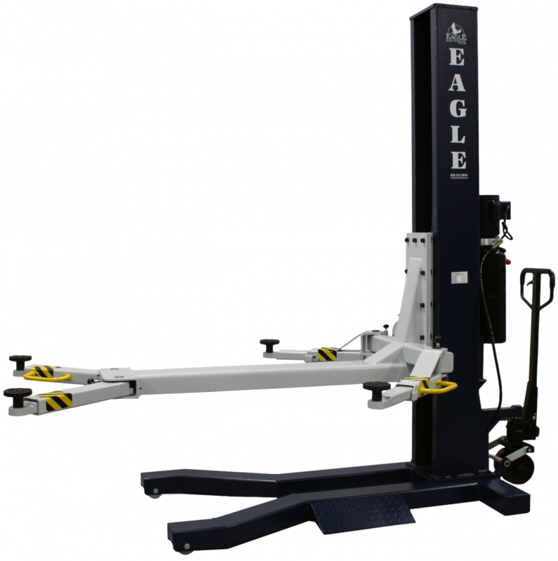

I am now looking at this, with the thought I can maybe make a brace that hooks to the side of my backyard buddy for an extra piece of mind it wont tip over. <span style="font-weight: bold">I did not want a permanent 2 post lift</span>, as it is nice to have the open space to detail or park cars, or to reuse that portion of the garage for kids parties during the summer:

black 69, Love your shop and cars! Looks great.

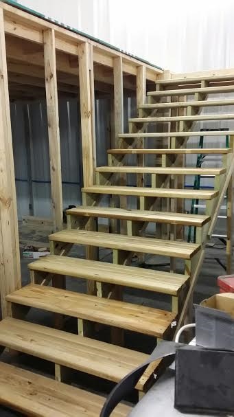

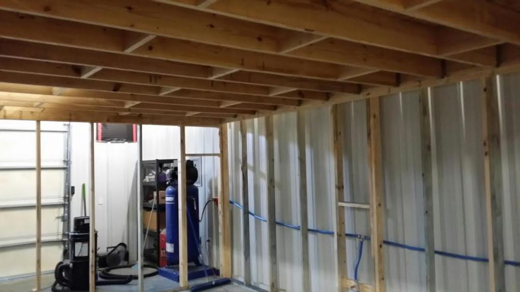

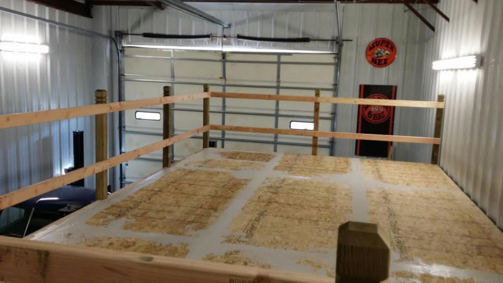

Soooo, with the truck done and the Bee on the horizon, I thought to myself, &quot;Self, sure would be nice to have a bigger paint booth...and a mezzanine for storage....and another car that had maybe, oh, a hundred grand stashed in the trunk!!&quot; Knowing the latter wouldn't be realistic for many reasons, I built this little thing over the past month. The goal was to make it look like an old Gulf Service Station (well, in my mind, anyway! [img]<<GRAEMLIN_URL>>/grin.gif[/img]) and I'm just about done! These pics show the framing, running the air pipe, and stairs. I used 2x8 joists and everything is bolted to the floor and the wall so in case I drive into it (with that new car with the $100K in the trunk) it won't move. And, I can use that $100K to sue myself! [img]<<GRAEMLIN_URL>>/hmmm.gif[/img] !Enjoy! [img]<<GRAEMLIN_URL>>/cool.gif[/img]

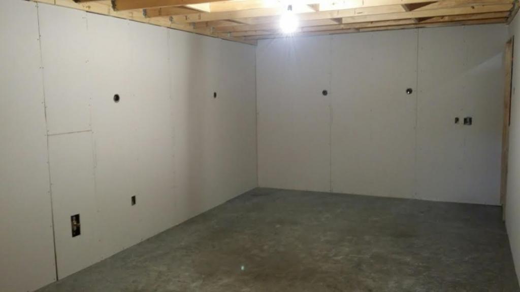

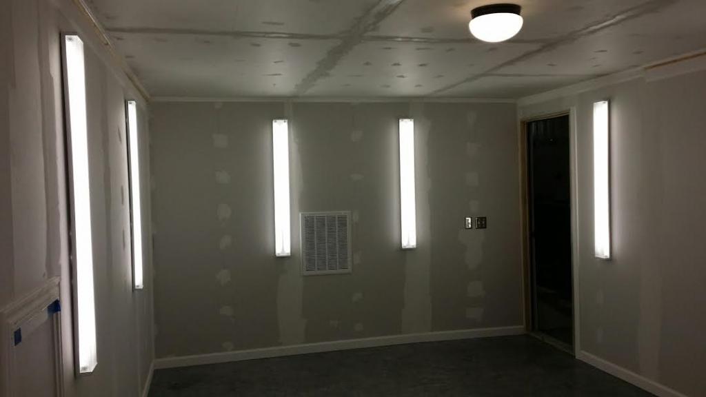

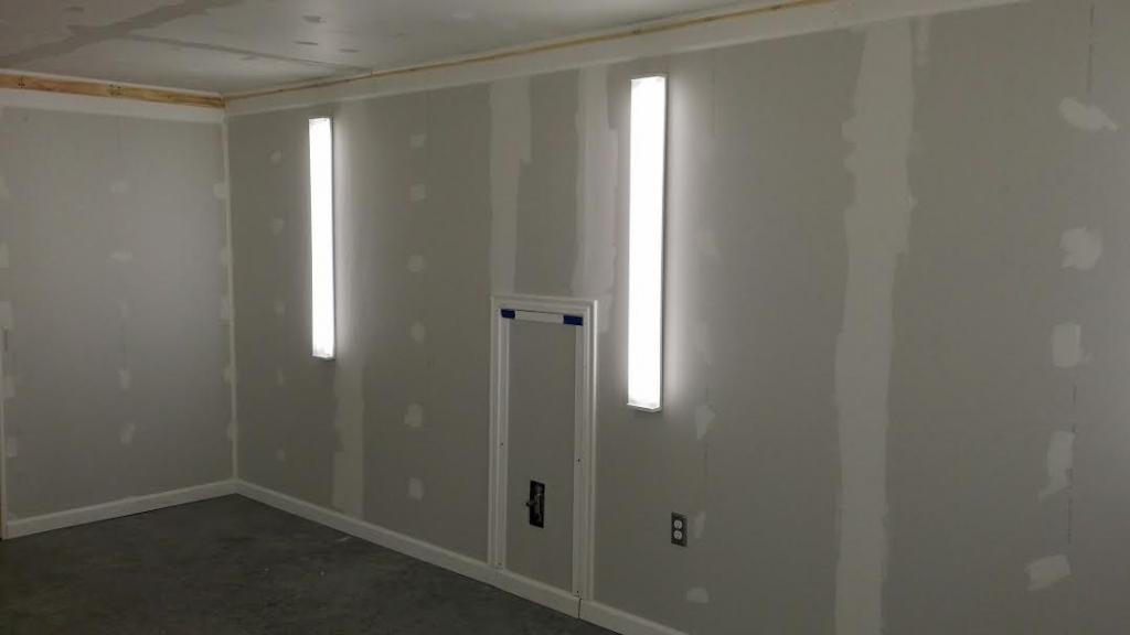

Drywall up, electrical done, lights on!

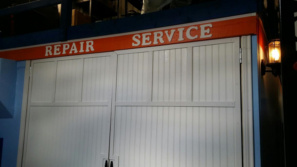

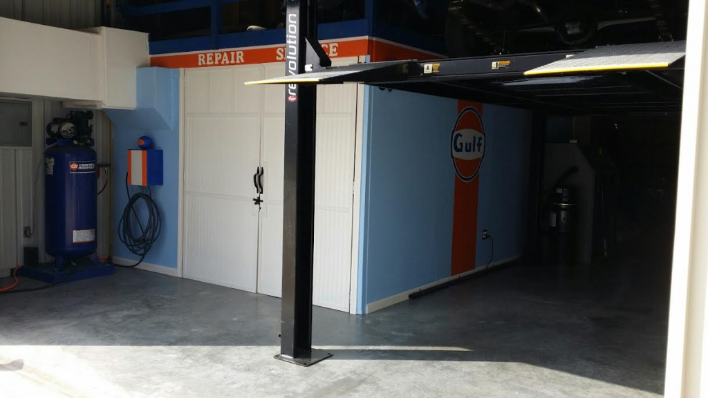

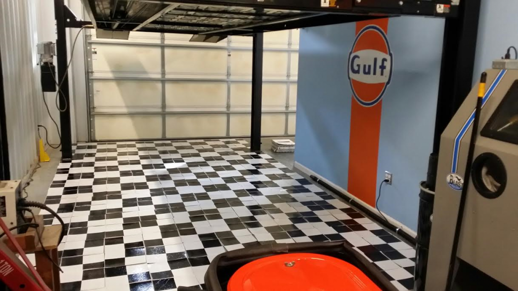

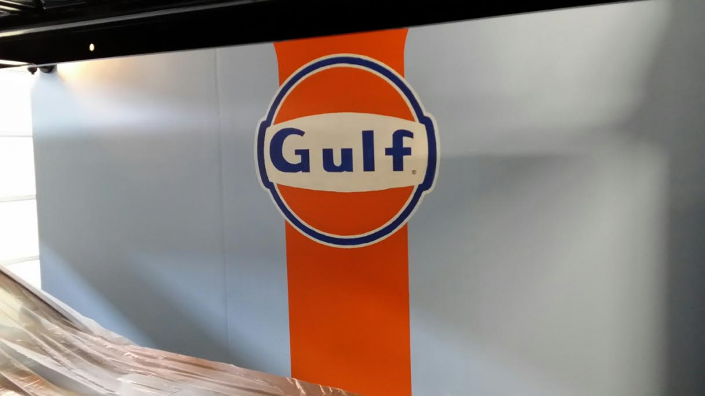

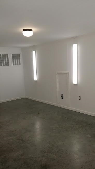

So, the final outcome with my custom art touches. I couldn't find a large enough Gulf sign locally, so I painted one myself! And I painted the whole building in the Heritage Gulf Racing colors, since this is about the closest I'll get to owning a Ford GT in those colors. I made an antiquey-style air stand that I still need to detail up. And it actually works! The exhaust fan is belt driven so the motor is up and out of the paint fumes. It goes through a series of filters then exits the door through a port to the outside. One filters intake and two filtered exhaust ports. The last item is to stick the tile down on the floor since here it's just laid out to make sure the pattern is correct.
Time to start painting!!!

I did everything you see here, except the electrical work. I figured that an electrician would be able to do it way faster than I would. Plus, knowing Mikey and the razzing I'd take if for some reason I turned on my fan motor here in TX and his house went dim up in OH, I'd never hear the end of it! [img]<<GRAEMLIN_URL>>/hmmm.gif[/img] [img]<<GRAEMLIN_URL>>/biggthumpup.gif[/img] So with the electrical fee, supplies, etc., this whole booth project was $4,652.17. I coated the upper floor with that decking surface restoration junk that Lowe's has. It leaves a hard, textured surface and fills in the gaps on the OSB board. Came out great! I have some left over and will probably hit the stair treads with it too. The floor inside the booth will have painter's floor covering paper on it that's disposable, so when done it'll go into the trash and the booth remains clean. Plus, I can keep a car in there when not in use. You know, that one with the $100K in the trunk! [img]<<GRAEMLIN_URL>>/dunno.gif[/img]
