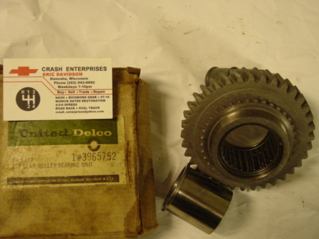

I was looking thru a box of N.O.S. Muncie sycro assemblies and one box looked different...
I found the N.O.S. M-22 rollerizes 1st gear I know a had, but didn't know where it was...
Thanks... Crash

That is very cool Crash. [img]<<GRAEMLIN_URL>>/biggthumpup.gif[/img]

Wow! I didn't even know they Delco made a rollerized first gear for a Muncie!
