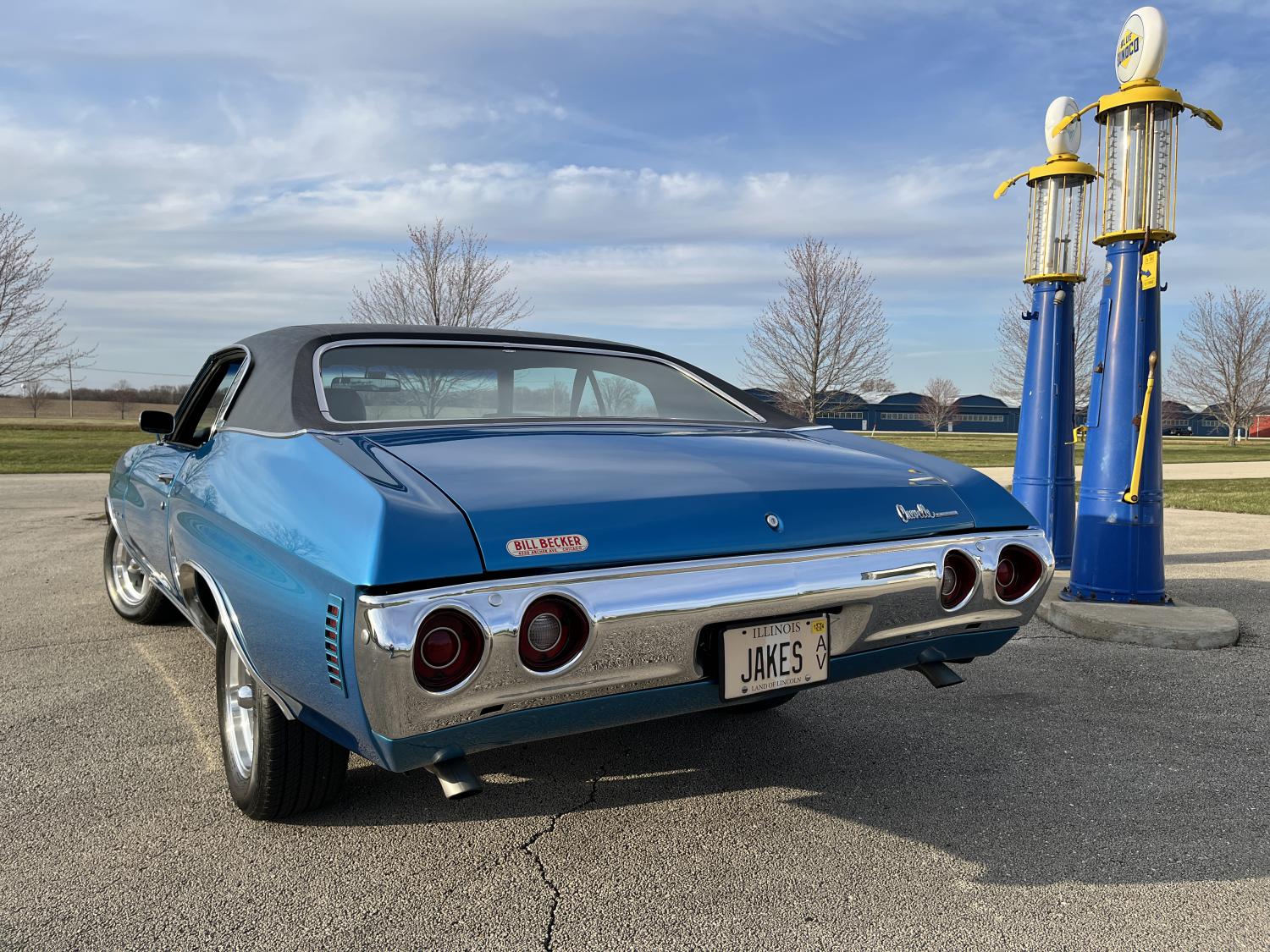

Finally back on the road - went over to the airport museum next door and snapped some pics with the evening sun.

Looks and sounds great Jake!! Now it runs as good as it looks!

Wow !! The pics at the airport are way cool !! The car looks great...
