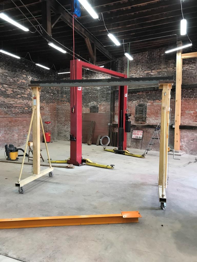

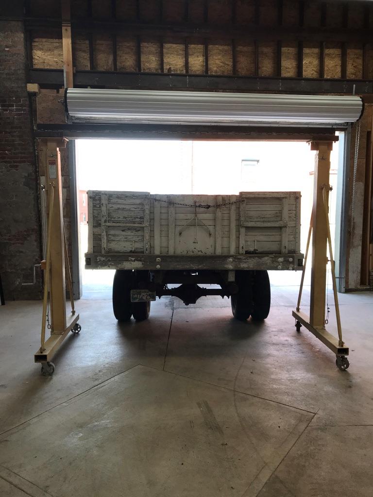

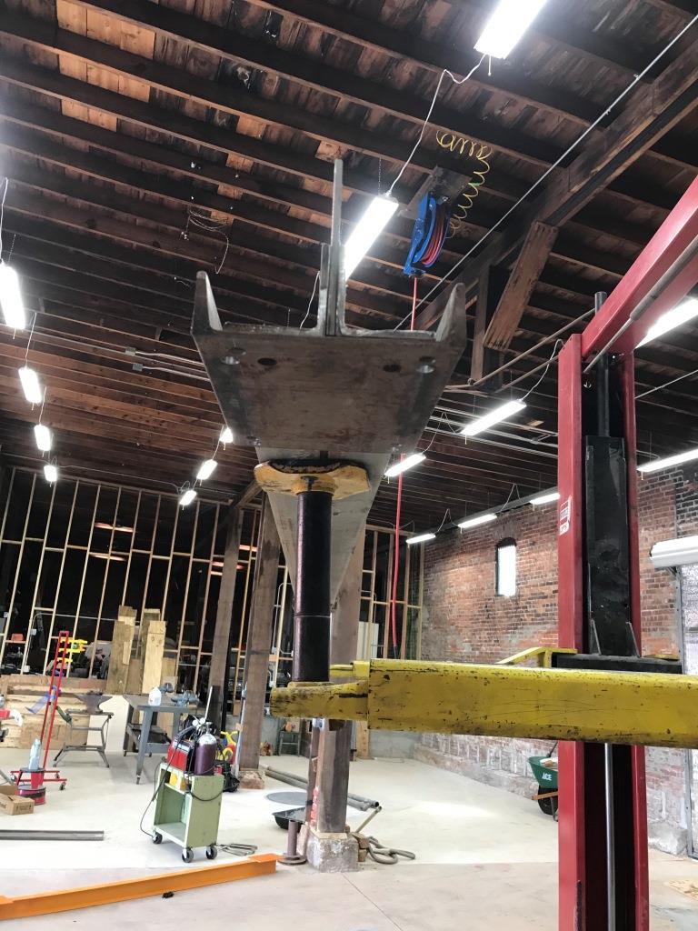

Have a gantry crane that is really handy. 10 x better than a cherry picker for pulling and installing engines.
But... it wasn't quite wide enough to fit either my car hauler trailer or my 49 Studebaker dump truck under it. Couldn't find a small I beam to replace the 9 footer. So, I bought some 1/4 inch thick 3 inch angle iron. Already had some 1/4 inch thick steel plate in 20 foot lengths. Cut pieces to 130 inches long. Welded the plate between two pieces of the angle iron. Then I welded on two end plates cut from the end or some C channel I had left over from a previous project. That means the new "web" is 3/4 inch thick. A bit of overkill, but it is what I had available.
Got it done last Sunday. The pics will probably post sideways, as they were taken on my cell phone. Even though I load them on my computer and rotate before downsizing and saving, they still come out sideways most of the time.

I haven't seen pics of your shop in a year. It looks good and all those LED lights ready brighten it up.
The crane should be more usable now.

Almost like daylight, and very well spaced, so no shadows or dark spots.
70 lumins per sq. ft. of floor space. Draws the same amperage as two traditional 300 watt bulbs.
