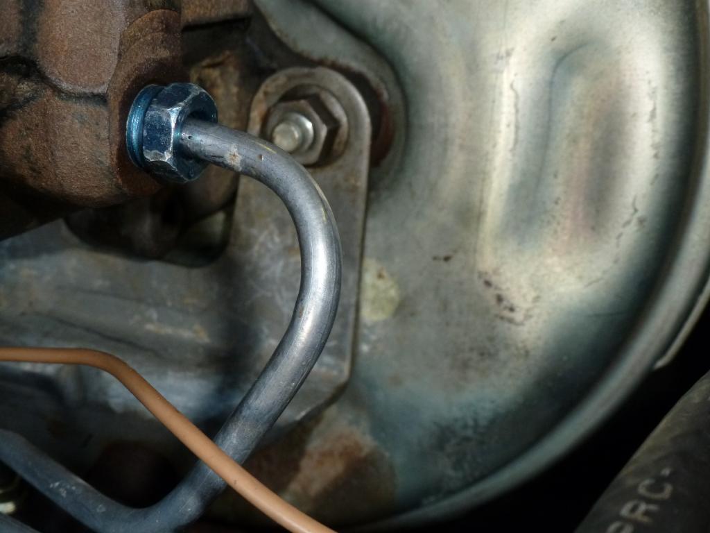

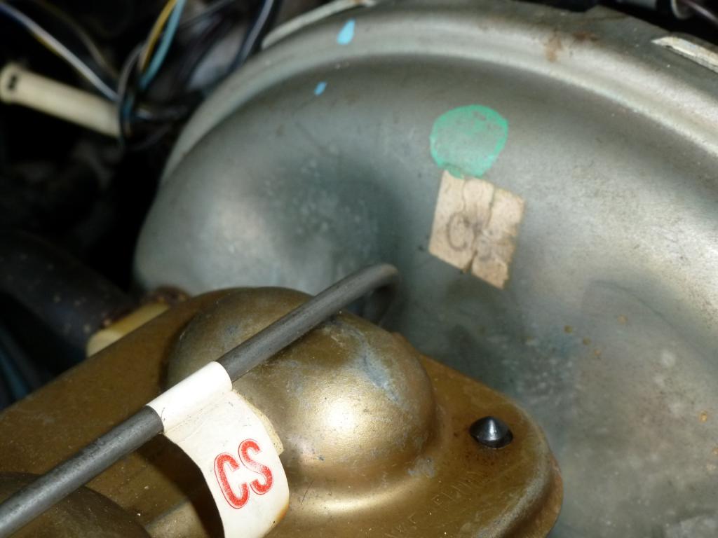

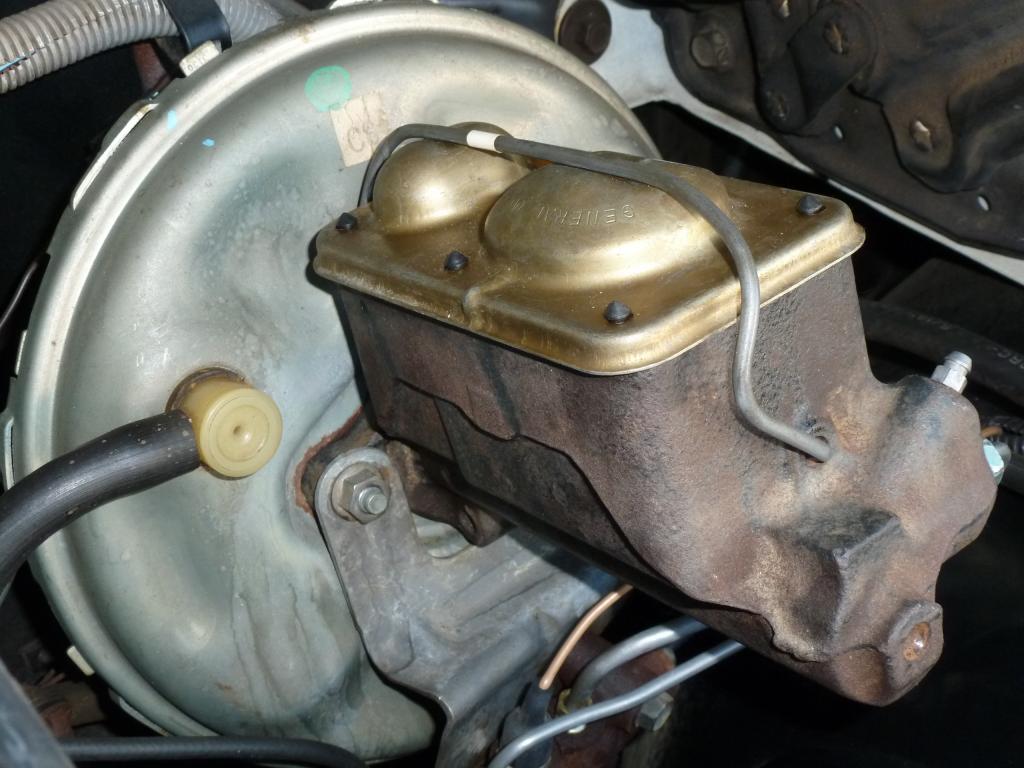

I just got the original master cylinder back from Whitepost Restorations who installed a brass sleeve and rebuilt the internals. If you notify them beforehand that your master cylinder is from a survivor car and that you don't want it repainted, they will honor your request and leave the finish as they found it. I was very happy with their service. Got everything hooked back up this morning and I then bled the system. Looks good as old. [img]<<GRAEMLIN_URL>>/biggthumpup.gif[/img]
And some close up shots of the stamped part number &quot;CS3190&quot; and the various paint markings and stickers.

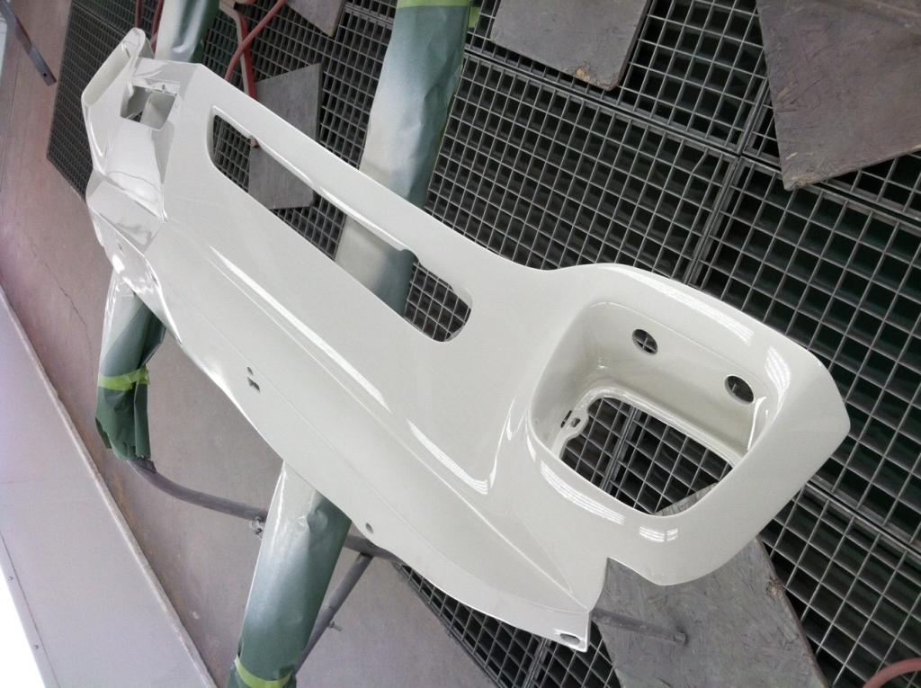

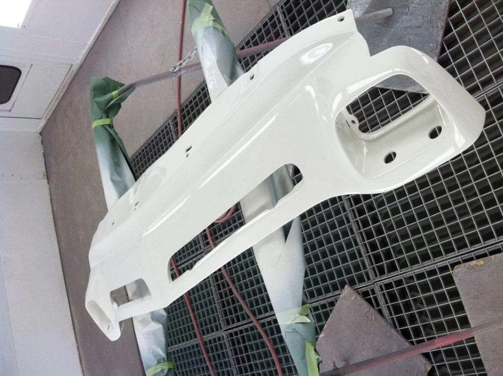

After the three hour Votech class last night both sides of the valance are painted and ready to go. I got to wield the paint gun myself for this, so it was rather satisfying to see it go from broken pieces, to primer, and on to paint all by my own hands. [img]<<GRAEMLIN_URL>>/grin.gif[/img]

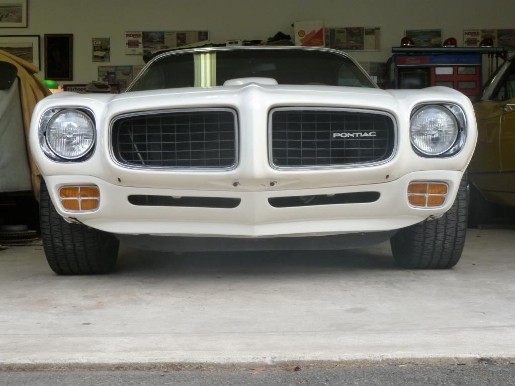

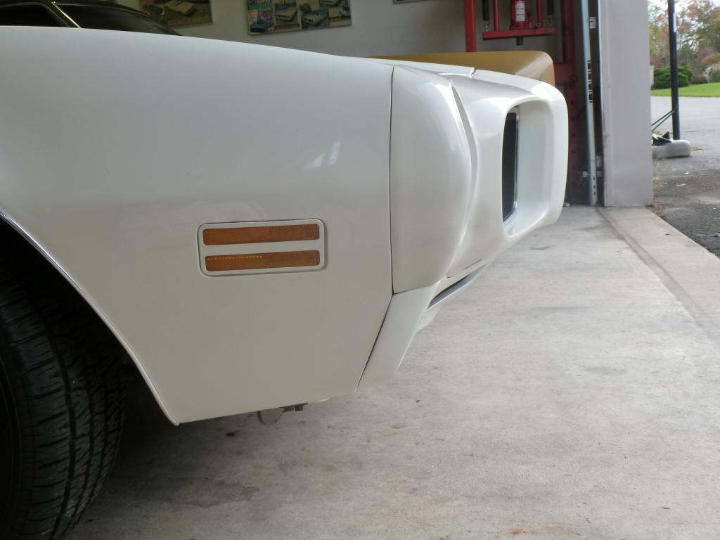

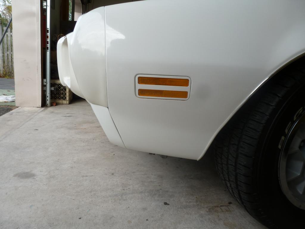

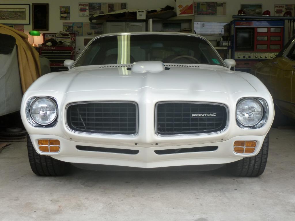

Got the finished polyethylene valance installed today. It was reasonably uneventful. I made sure that all the lower mounting bolts have the large flat washers in place and are finger tight so the valance can move and flex with the nose. The upper mounts use #14 screws with attached washers. These, I wrapped in Teflon tape and finger tightened as well. The Teflon tape allows the screws to remain in their position even though they are not fully tightened to spec.
The front end sure looks a lot more streamlined with the polyethylene valance than it did with the warranty replacement steel valance that was installed by the dealer when the original poly valance shattered.
Before, with the steel valance:
And after:
In this shot you can really see the difference in the hue of original paint on the bumper as compared to the front fenders. The flexible nose/bumpers were painted by the manufacturers and installed on the cars in their prepainted configuration, while the body sheetmetal was painted on the Norwood/Fisher Body assembly line.

Just a suggestion in the spring I would take the valance off and leave it i the sun every once in a while and let it weather up a bit to match the fenders. The valance look a touch whiter than the fenders but that could be my monitor. Excellent job on making it fit so well and the paint looks real good.
