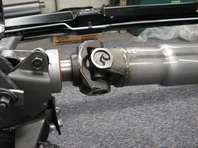

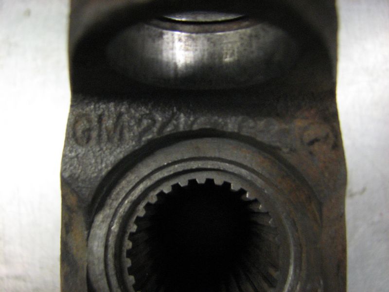

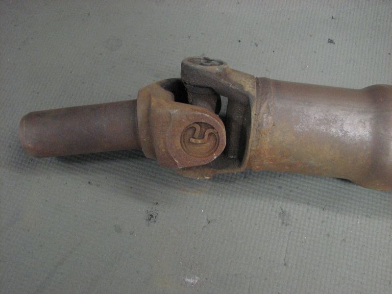

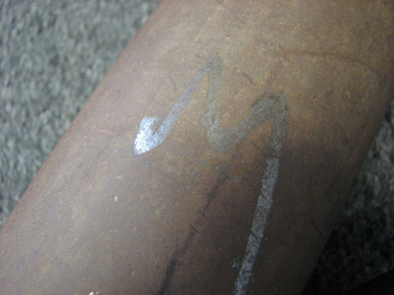

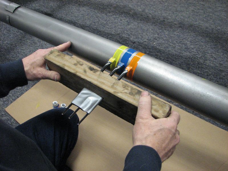

Long weekend! After considerable research, help from Grady, Phil and Mike as well as a few others I was able to determine what actual colors our stripes were originally. Going back over several photos of the original and comparing them to others that sent me photos I think I got it right. Off to the paint store to find the correct color paints, purchase the correct width brushes and then making a jig I was able to replace the old incorrect stripes I had recently put on with the correct colored stripes. Since doing this I deleted my old posts so there would be no confusion. I also looked over the photos very closely and came up with what I felt was correct for the green check mark and yellow "M" or "3" that I found on our shaft.
Rick Nelson

OMG , I am copying your jig. Did Annie turn the drive shaft
Mike
Old 12-24-2018, 04:10 PM
SS427's Avatar
SS427 SS427 is offline
Location: Pleasant Plains, IL
Posts: 10,304
Thanks: 3,036
Mike
She spun the tire which in turn spun the shaft.
