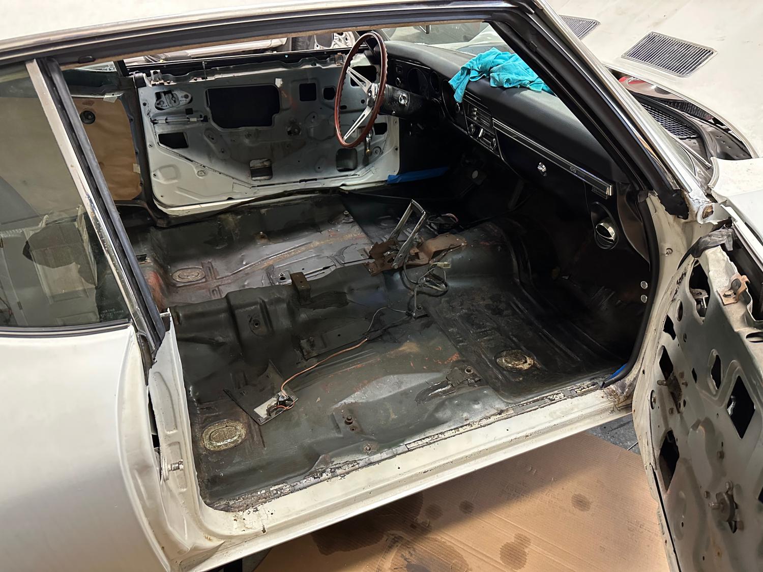

Still working on the car & trying to get it repaired (not restored) and in good running condition. I didn't see any rust holes in the floorboards, while under the car cleaning, sealing, and painting any bare metal .... but I wanted to check the floorboards inside too.
There was some light surface rust - but no holes. Everything is solid, even when using a screw drive to poke and scrape.
The carpet will have to be replaced, and the console is broken in so many places, it will probably get tossed too.
The red/rust color you see in the picture is a glue that someone used I think when they put in the carpeting I took out of the car.

I ordered a 1/4 driver side front floor board section - going to go ahead and repair the floor where it was cut out for a manual transmission.
A friend of mine will be coming by the evening to start the repair. Then I'll replace the shifter cable with one that has the floor sealing gasket on it.
You may be able to see where a piece of metal had been pop riveted into place in the above photo.

My friend got the floor pan cut out where someone had put a hole for a 4-speed years ago, smoothed it all up nice and cut and welded in the new piece.
Looks real good - and will be a lot better than the way it was.
