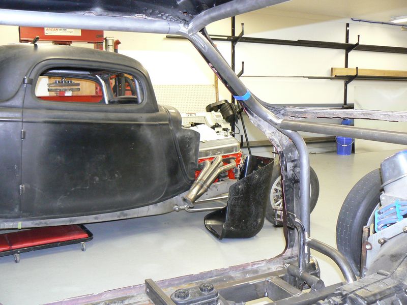

After removing most of the mild steel &amp; bubble gum; Fab Man has had enough!! [img]<<GRAEMLIN_URL>>/no.gif[/img]
More later.

So you are saying that you would have preferred the beads to be complete AND even? [img]<<GRAEMLIN_URL>>/dunno.gif[/img]
Good stuff Dicky - keep it coming!!! [img]<<GRAEMLIN_URL>>/beers.gif[/img]

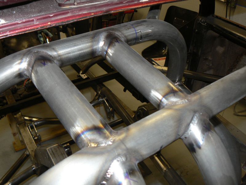

<span style="color: #FF0000">Lets lay some new <span style="font-weight: bold">PIPE</span></span>
Every time I used that term, my Fab guy would come unglued &quot;it's TUBING, and don't forget it&quot; [img]<<GRAEMLIN_URL>>/mad.gif[/img]
Dicky [img]<<GRAEMLIN_URL>>/haha.gif[/img]
