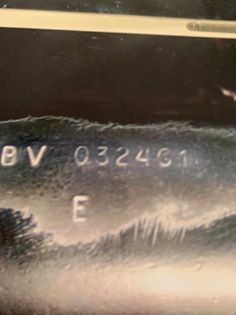

i believe thats an m-22,correct?

Post M-22 trans...
The 'C' is for M-22...the rest of the stamping indicates January 21st, 1969 assembly date. So, does that VIN stamp match the deck stamp on the block and does the date line-up with cowl tag??
Maybe this is an original big block car that someone installed a small block
I would like to see the listing and the photos...
That would explain the trans and rear gear, although the BB engine code would be on the POP (if real)
Maybe a possibility they could order a M22 trans through the dealer request? I have heard of stories like this people asked the dealer if they could add something that was not listed.

Posts: 20,897
Who's taking these pictures?

the sellers pictures,a small muscle car dealer in texas.i will give dealers name if anyone wants it,its on a facebook page. says engine numbers correct but wont show pictures of it.does the trim tag look weird too?

Axle in my 03D Z28 is the day after this car

69 nova SS, All Numbers Matching, 34,000 documented actual miles with copies of titles to prove, 350 / 300hp V8 engine, Muncie M22 Rock Crusher 4-speed manual transmission, Original vinyl top, Original sheet metal, Factory tach and console gauges, 12 bolt BV code rear end, Aluminum intake is an over-the-counter part sold in 1969 and 1970, 410 gears. All Factory!! Azure Turquoise in color. This is one of the finest novas you will find! Truly a flawless example! $40,000
