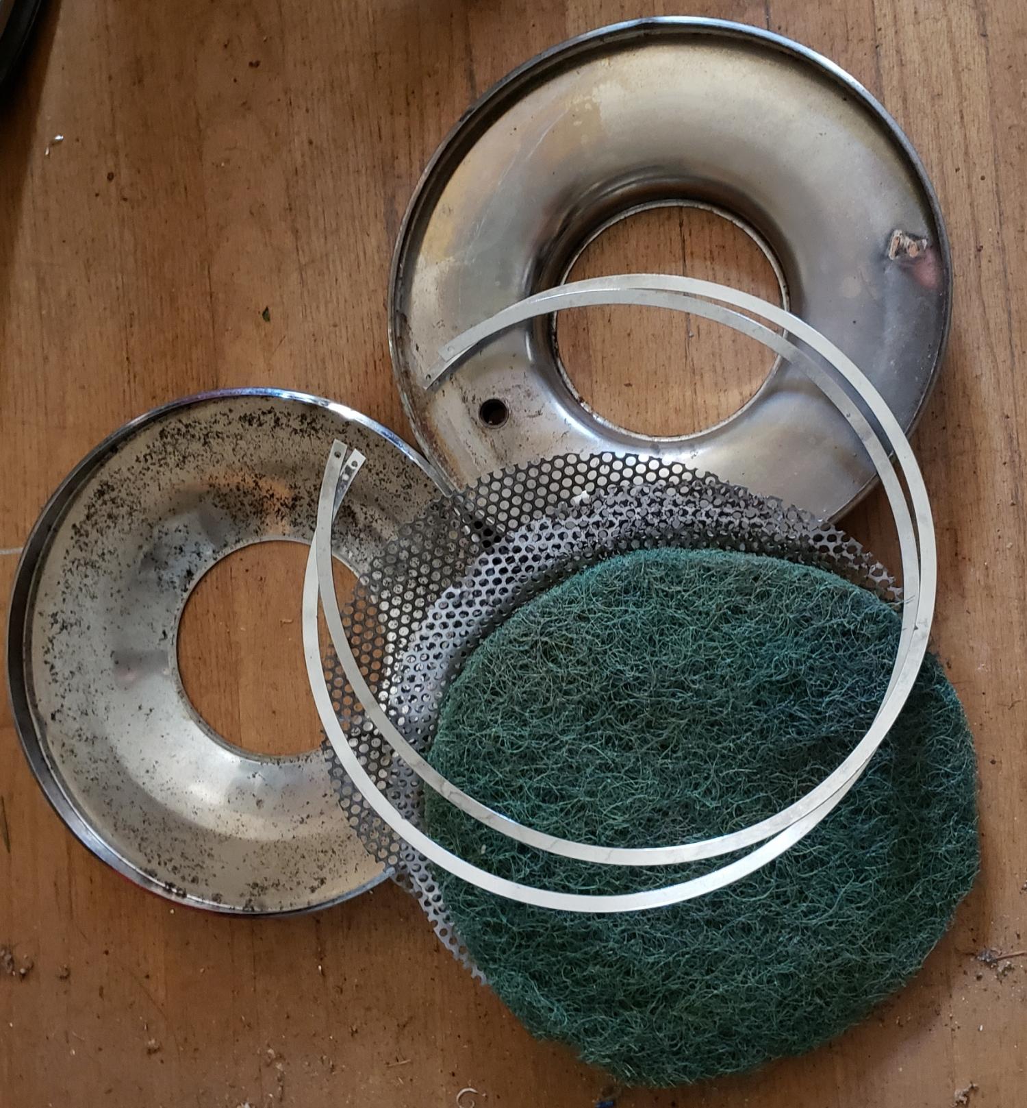

theres alternatives to the factory mesh element... my friend came up with a way to use a K&N filter element.
the snap ring style was used on Mr Gasket fly eyes and some knock off brands
the zig zag wire was used on Cal Custom Fly Eyes...
the Cal Custom Fly Eye is actually slightly larger in diameter then the others and the screens and retainer rings do not interchange.
some had a vent hole in the bottom and some didnt , ive seen this on all different makes.

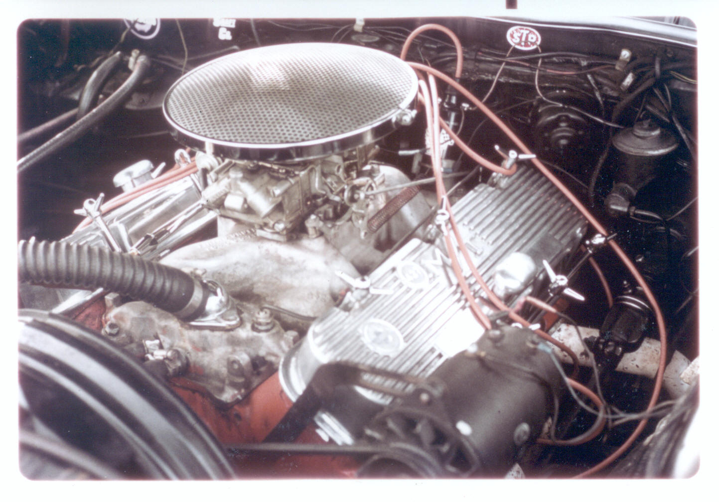

For what it's worth, this is the one I had on the 396 in my '62 in '69. I bought it from Joel Rosen at Motion. The filter gave up fast after a few carb backfires.

I have seen a lot of different fly eyes
the size and shape of the chrome base is different on some
different hold down snap ring or wire
different screens
different vent tube styles
here are some pics I saved
the old Motion car pics show the snap ring

The earliest Mr G had a giant snap ring around the entire top and was bolted together. Rarely ever see these.

That early style Mr. Gasket was the one I bought from Joel in '69. The element was a gray foam.
