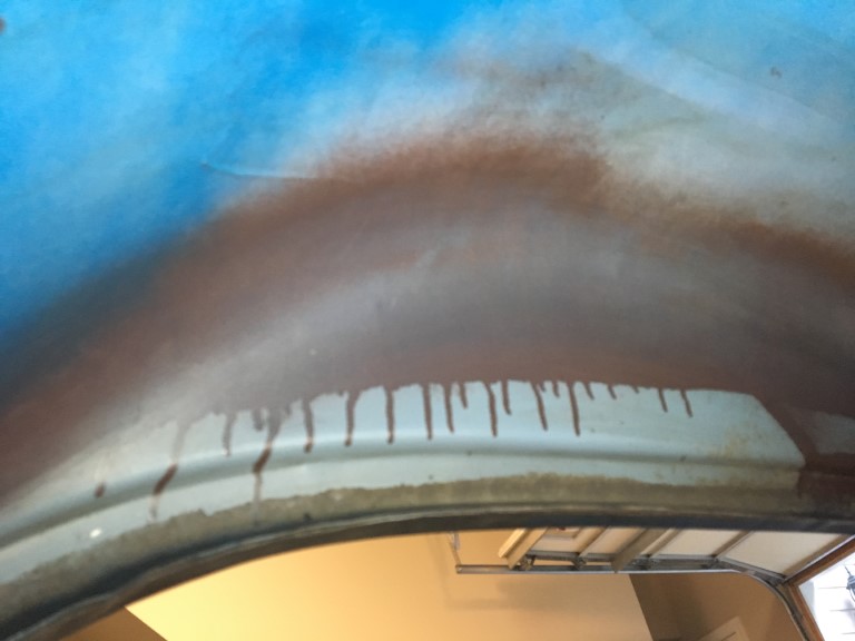

Was the first primer gray, and other in corrosion areas red? Might explain this. I haven't asked my painter to reproduce the runs ...
Attachment 172273
Rob, although reports say that all cars received a gray primer-surfacer before being baked, I've been told by multiple people that different color primers were known to have been used between light and dark colored cars and have shown up on many survivors? Many of the dark colored cars have been found to have a red primer used under body color in some areas? Not sure if that was from the beltline down or just the wheel areas???
The Following User Says Thank You to NorCam For This Useful Post:

There may be truth to that NorCal, I'm not sure.
Mine being a Frost Green car, has grey primer that is very visible around the trans tunnel and when I removed the gas tank just about everything under and around the gas tank was grey primer. I've never found a spec of red primer anywhere on the car.

My understanding was LOS/VAN Nuys cars were all gray primer. Norwood body , red oxide then gray. I do not believe the front clips got the red oxide, just gray ? In the first picture the trunk lid was closed when the gray primer was applied.
Third shot is a LOS car, no red primer.

My Lemans Blue car had a lot of exposed gray primer along the front edges of the toe boards, inside the rear frame rails and all along the rear valance under the tank. Lots of black was sprayed up inside the differential tunnel, trans tunnel and covered all of the main floor boards.
In talking to a couple people with original paint cars, I was told a few have been found with red primers here and there but I think that was mostly found on dark colored cars. Who knows, maybe they ran dry of gray and pulled a tank of red into finish some productions? On this yellow car, it's most if not all gray primer underneath with considerable yellow over-spray. I'm really not seeing much of any black being applied anywhere?
I think I will stick to the original plan and do it like I first intended which is pretty near to what Mike D had done on Grady's Copo. Black out the main areas and keep some gray inside the center of the tunnel and under the tank. Can't go wrong there.
