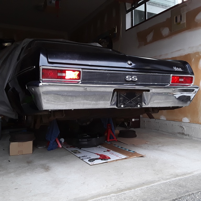

Looks like a very nice original Nova. You can also try a little heat from a torch to break those lines, but not too hot.
