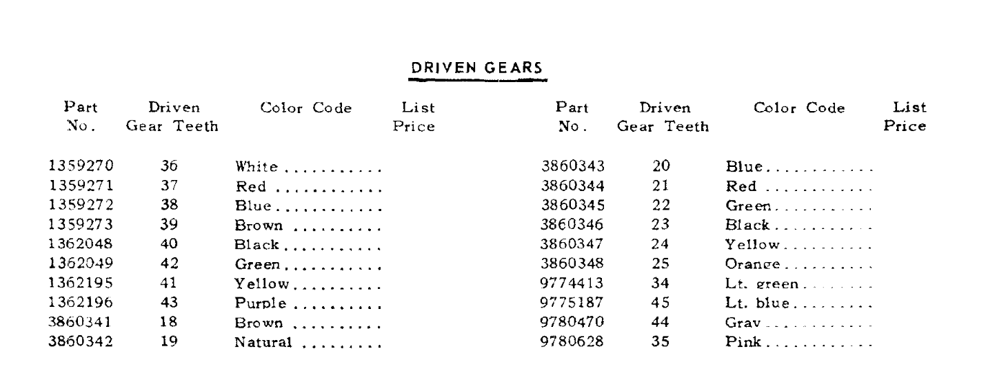

Here are the teeth counts and color based on speedometer driven gear part number.
Jose Betancourt
67 Camaro L78
