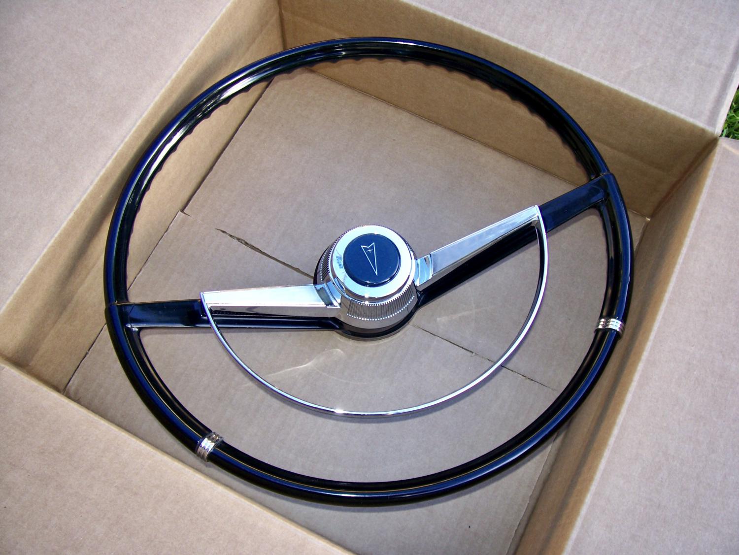

I have seen this ‘64 shown a couple times over the years and have my doubts, especially with this advertised mileage.
Many items are incorrect.
1) It has a 1965 horn bar and center cap.

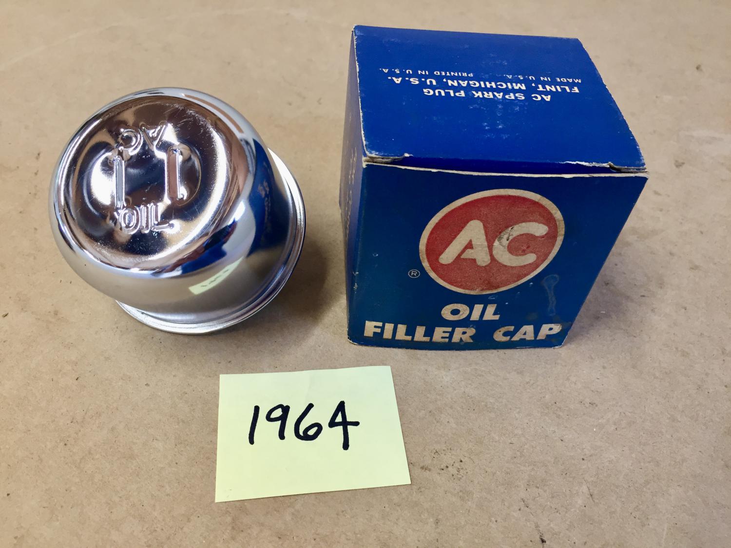

4) The chrome 1964 oil fill cap had “trapezoid” breather holes on the bottom.
This cap has round holes, wrong.

Below is a 1965 steering wheel, horn bar and center cap.
Also a 1964 oil fill cap shown below that does not have crimps around the parameter and has the correct Trapezoid breather holes.
