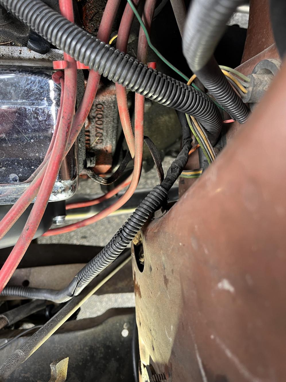

BTW, I am really interested in knowing the casting date on this one when you get around to checking it out.

Check the casting date. If it is pre March 13, 1969, I believe it will be the earliest known 010 block out there. I have never seen one dated prior to April, 1969. Not saying they don't exist. Just haven't seen one.
Should get the truck back from repair shop and try to see back there today - truck was just purchased last month - had sat a year and little maintenance done over the last decade or two. Changing all fluids, belts, hoses & tune-up parts. Had the town carburetor guru revive it this week:
Adjusted carb - set timing - rejetted - was way rich at idle - and way lean at RPM - both conditions fouling the plugs.
Valve train checked good.
Compression checked good:
1 - 175 .... 2 - 165
3 - 165 .... 4 - 170
5 - 180 .... 6 - 175
7 - 175 .... 8 - 175

OK - Took 8 tries and some flexing of my 65 year old body but here is the date code. E 20 9 appears to be.......

Difficult to read, but looks like E 30 9, which would be May 30, which makes sense for an 010 block as they didn't come into use until mid April.
That means, even if the stamp wasn't in the wrong place, and even if it had not been decked, it could not have been assemble in March.
