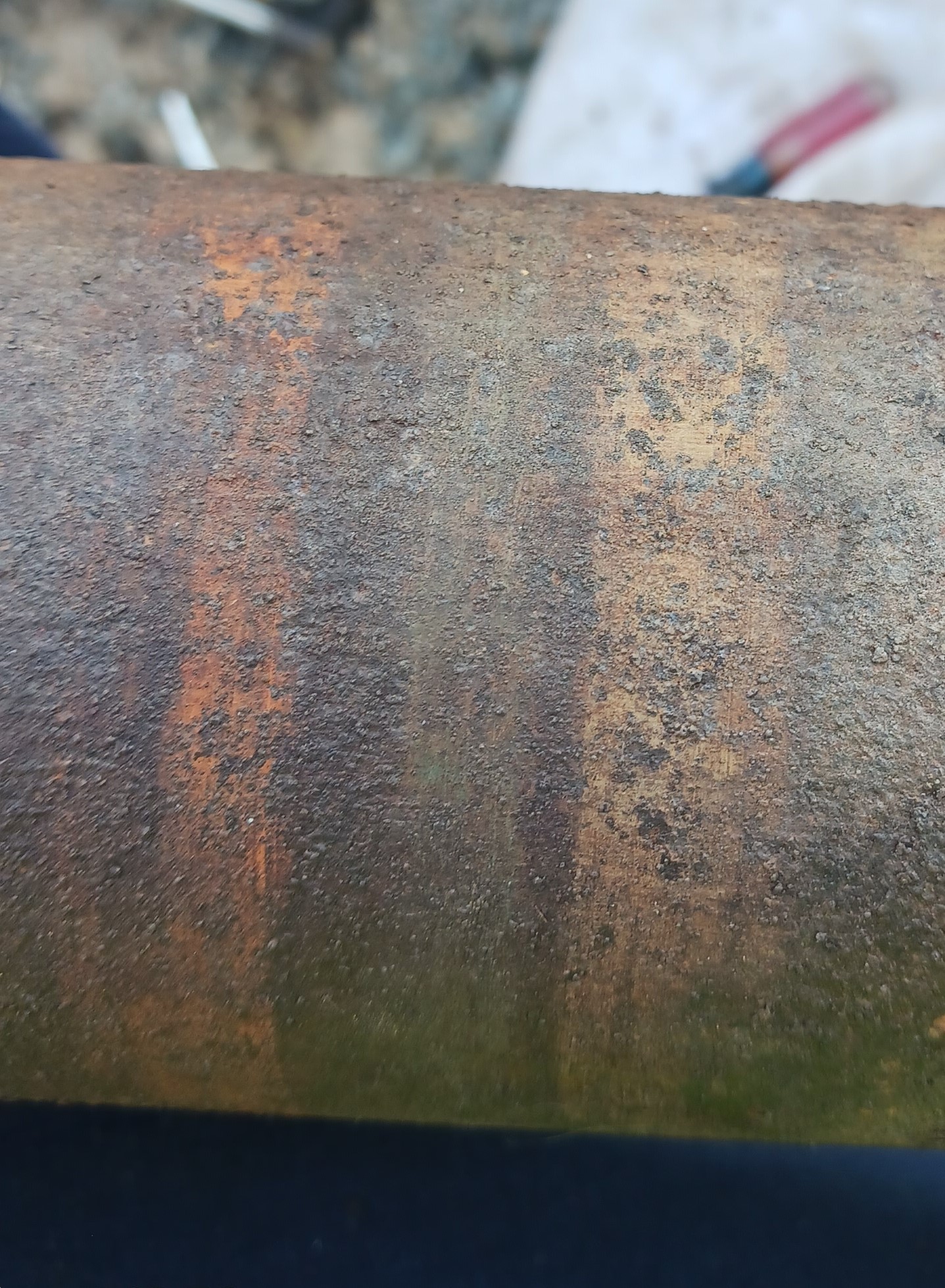

Different colors and closer together but sure looks similar.
Do not think this was a precision deal.

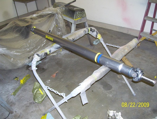

This is mine for the '69 L78 chevelle coupe. I did what's been suggested with brushes but I did it with tape guides and several swipes around the tube. Didn't touch the tape, just used it for a guide.
