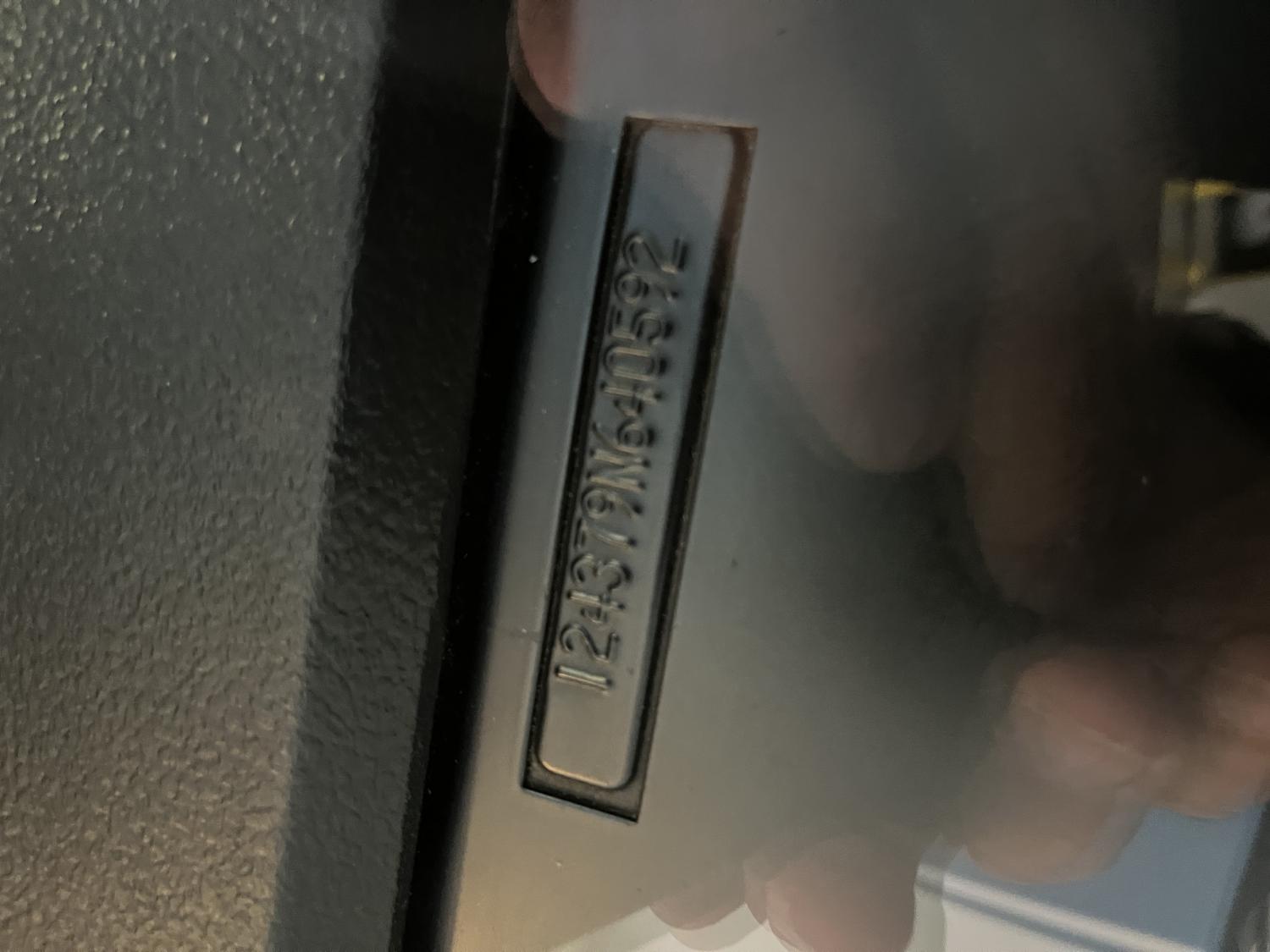

which website did you run the VIN on that said it was a COPO? I know of one site that is falsely identifying pretty much any Camaro VIN inquiry as a possible Copo. Cant think of it of the top of my head right now

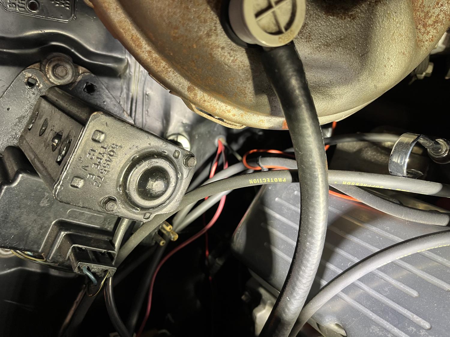

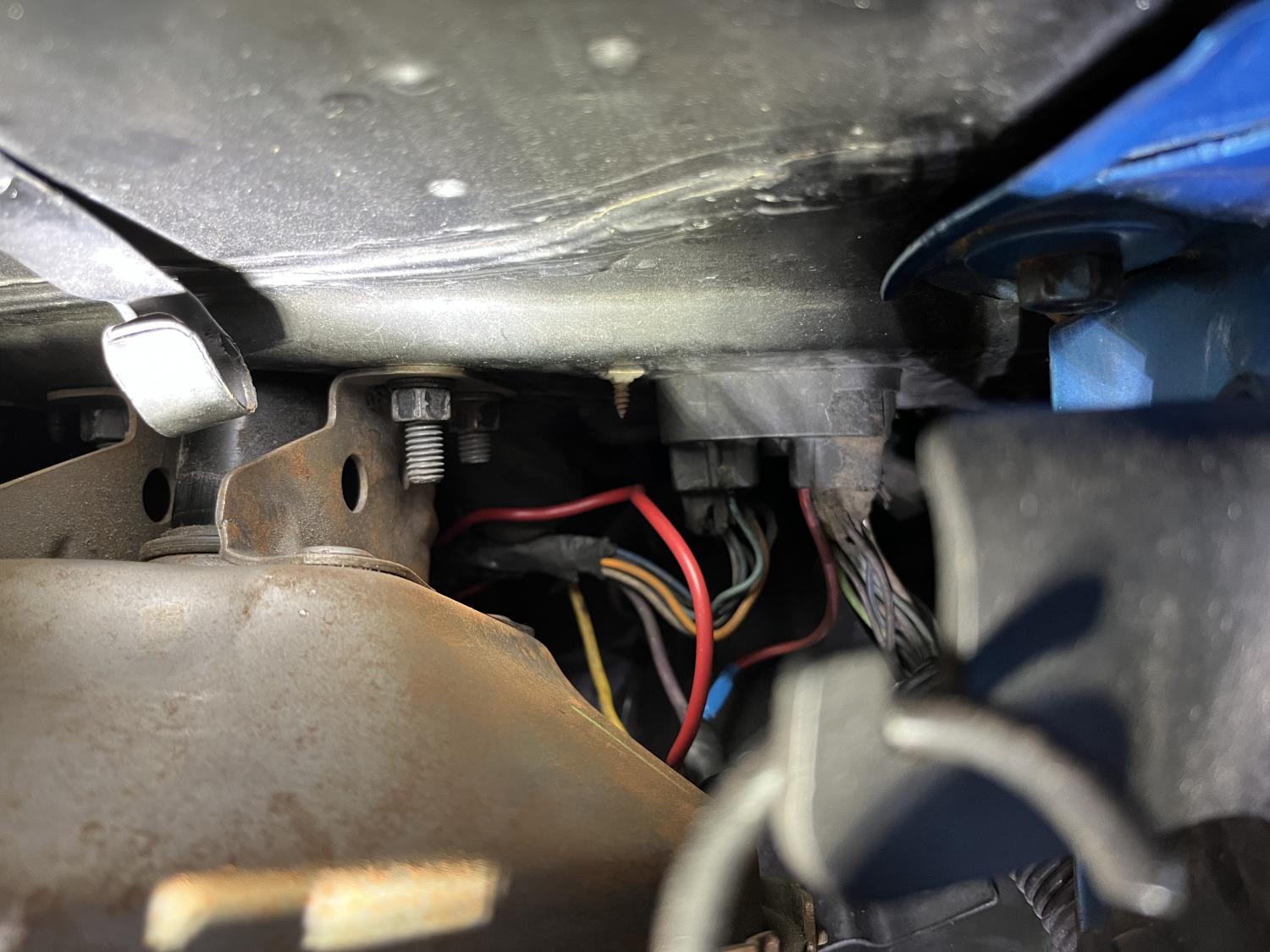

I see a small block heater box and no hole that I can see where the cowl induction solenoid would attach to the firewall.

Pictures are very dark. Take a picture of the firewall behind the brake booster.

Doesn't look like it has the ZL2 hole above the bulkhead. Aside from COPO question, you might want to check the hidden VIN under the wiper panel (top of cowl on passenger side) to see if it matches the VIN plate. It appears that the top of the dash panel was replaced, which is usually due to past rust issues, yet you have a perfectly crisp VIN plate which might suggest something was changed/replaced there.
