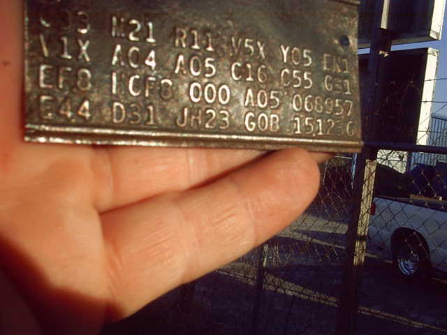

hey guys this fender tag was in the glove box can you help me de-code it??

heres another pic.

That tag belongs to a plain-Jane, green, 318-powered 1970 Challenger hardtop. I hope it doesn't match your car's VIN.

thanks for the info steve, luckily the vin does not match the tag!!!i just called john and had him check it.the guy john bought the car from had parted out many mopars back years ago and the tag ended up in the glove box of this car. i am going to a race out of town so when i get back i will get over to johns to take some pics,thanks dave.

Good catch Steve, You took the words right out of my mouth when I saw that tag..

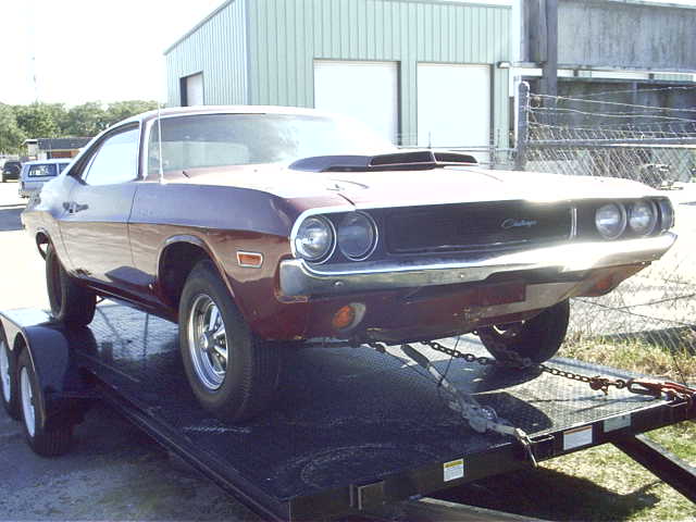

pictures finally!!! sorry guys for the wait.

next...
