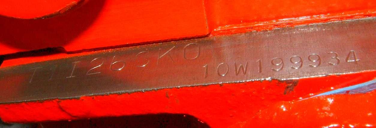

That is early,but not impossible as these cars were built very late,and most likely the blocks were just sitting waiting for the cars awhile.
What's the Tonawanda build date before the CKO code on the Pad behind the Alternator?
Is the VIN# stamped there,or is it down by the Oil filter?
Do you see an external Oil cooler provision above the Oil filter Mount to indicate a 4-bolt block?

Thanks. I'm going back and I'll get pictures.

Also a couple of quick questions of mine (great input guys):
I just hopped to 2gcog to double check my info on that block stamping and am now wondering if there were 2 possible stamps for the block? Are both CKO and CJK valid for the '70 Camaro?

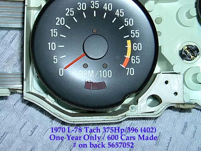

Man, I am wondering how that L-78 402 can breathe through those tiny snorkels. An open element air cleaner could free up a lot of power on these engines.
At least the LT-1 350 has larger openings to draw air from. Anyone have any performance specs or road test data from the 70 L-78 Camaro. With the low rise intake and restrictive air cleaner, I would think it would be slower than the LT-1 powered Z-28.

Looks like a super find and certainly rare being 1 of 600. I still own one of these and have owned three. Is the three piece rear spoiler original to the car?
