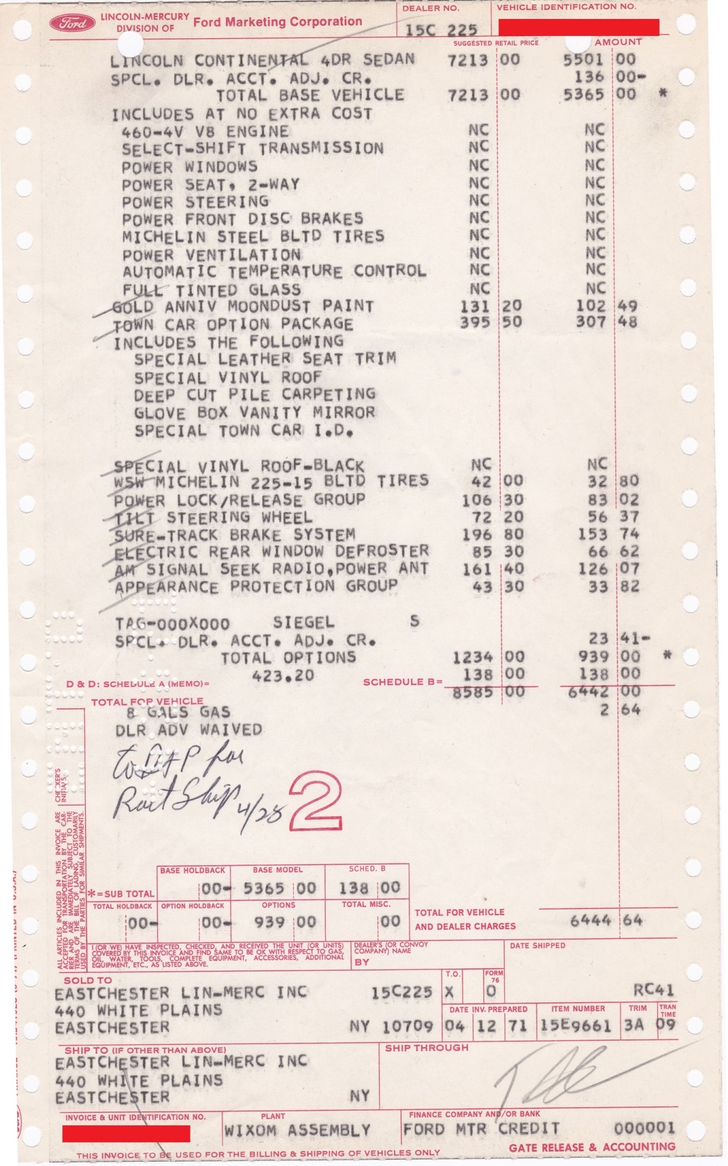

Thanked 2,827 Times in 867 Posts
I received the ORIGINAL invoice from Marti Auto. They have the original invoices from specific assembly lines and will sell you your original document as long as you provide them with a copy of the title or registration to prove you have the car. Look at that window sticker price: $8,585 !!!
