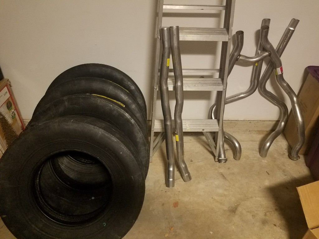

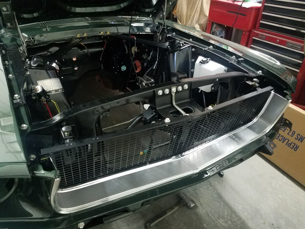

Now, you's guys know me. If I'm going to do this into a Hero Bullitt look-a-like, gotta do it right! So in the parts bin are Firestone G70s, stock 2" pipes through the resonators only with straight pipe out the back, 67 Grille, no emblems on the outside, covered back up light holes on the rear valance, blacked out gas cap, 67 Shelby GT500 steering wheel wrapped in black leather, Hurst shifter.
Now, the plan is to make this all reversible, or bolt on,
so when the car gets a new owner it can be bright back to stock easily sans an interior redo. For the rocker moldings, I'll take the car to the vinyl wrap place and have them vinyl wrap them instead of paint for durability and easy removal. Also, I'll have them do the edge of the trunk lid filing the emblem holes but removable later. Fender emblem holes will be filled with painted plugs... again... easily removable. One option my car came with was the center console which won't be reinstalled. The Am 8-Track and the uber rarer convenience group in the center dash will be reinstalled.
Under the hood it'll be stock with all the correct details for a 68, but no Thermactor and no stock air cleaner. Although I'll have these parts for ease of restoring to stock if preferred later.
I gotta tell ya.... I'm really excited about doing this! Of course, all the assembly line details will remain with markings, techniques, finishes, tags, paint blops. In the end, I think it'll really pull together nicely. And if not... you heard it here first when it makes the news as the biggest flop in Automotive Restoration History!!
So.... here's some parts and a 67 Grille installed. More this week!!
Cheers
Dave

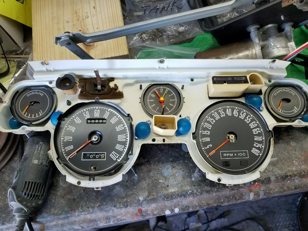

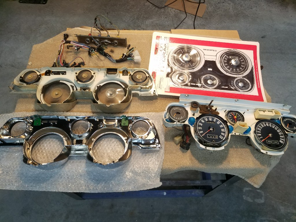

My car has the 8000 RPM tach and as such, came with a tripometer. Bullitt did too. The clock will be rebuilt as well, but the faces of the gauges are in great shape. And look at those original miles!!

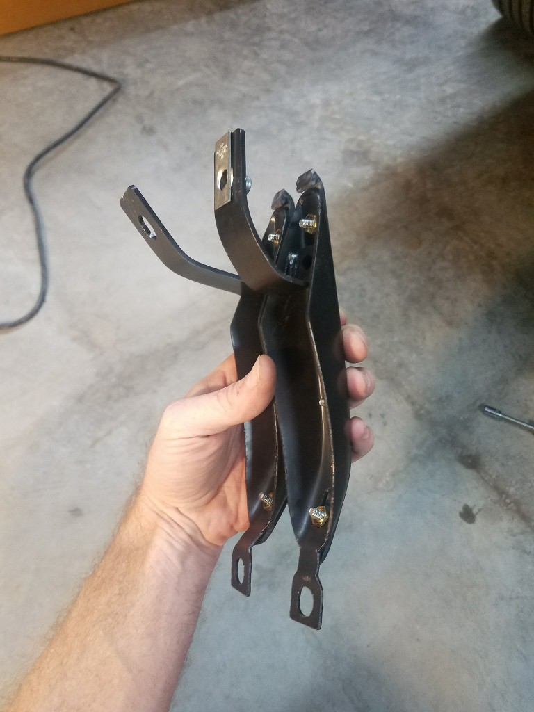

And this is why it takes 5hrs to install 3 parts. The radiator to hood seal.... the got the ribbing right and then failed on the length. Interesting thing on mine.... usually this is stapled to the metal support but mine was clipped on. And enter the winner for the Worst Designed Part of 2018 so far [ I haven't seen the rest yet ahs the year is still pretty early so I expect this to Award to be usurped] are the rear bumper guards. The closest one is the correct fit and the lower one is how it comes.

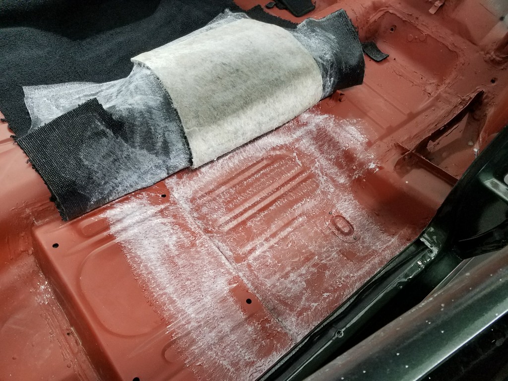

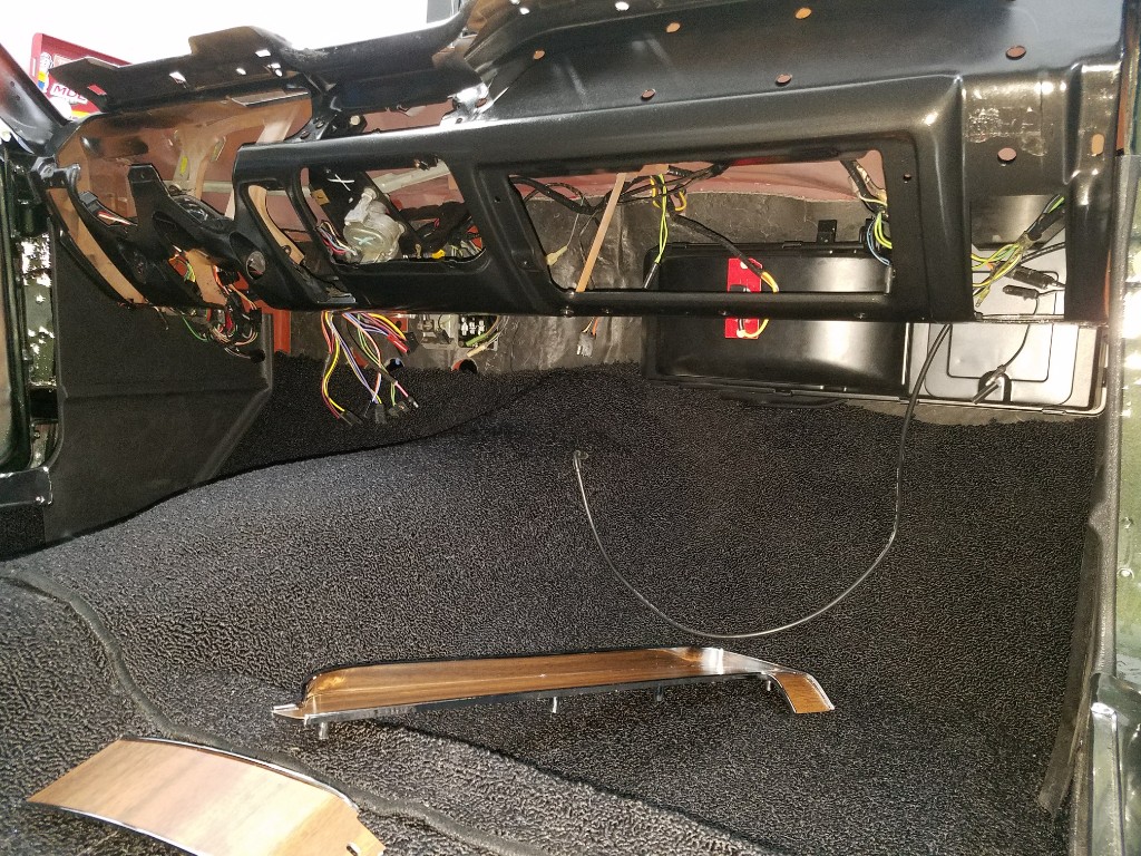

Yep... when dealing with parts made 6500 miles away, sometimes some "persuasion" is in order! And carpet installation 101: 1. Lay out the supposedly, molded, carpet and see how lousy it fits. 2. Wonder if Taka or some other make made a Mustang model since this carpet doesn't remotely fit a Ford Mustang. 3. Get out a lot of glue and go to town! 4. Position carpet wrong and realize directions mean what they say about "instant bond". 5. Sell car to Phil unfinished with strategically offset carpet permanently glued down.
But seriously.... yesterday was Heater Box restoration day and the carpet and side sills are in! I also went with the Accessory Panels to really make it pop when you open the door. More interior work to come today!

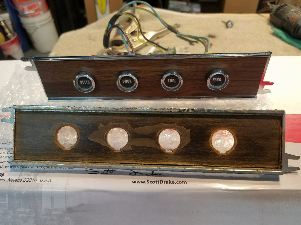

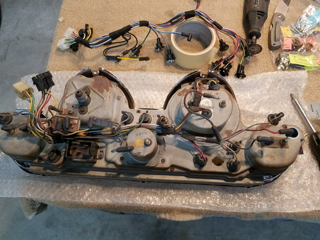

Moving right along.... I'm into the interior. Step one was to mask things off and spray the Metallic Black funk down on the dash frame. Red Oxide visible on the underside and firewall and notice the inspection markings on the wiper motor. Also, the pivot transmissions had yellow and green marks on them, much like the suspension markings do signifying L and R. Will anyone notice this? No... but I will! Once that was done I turned my attention to the instrument cluster. I went with a Scott Drake clock, bezel, and lenses. Extremely happy with the quality of these parts. I left the factory installed surface rust on the back of the cluster housing for sentimental reasons. After all, much like freshly painted car waiting for its first ding, I'm heading this confrontation off at the pass by leaving this little bit of flash rust on the car so no other rust forms!
Heater Box, main wiring, and today defroster vents, dashpad and bezels go in. Notice on the instrument cluster the "Brake" light is not installed. Since my car has the uber rare convenience group, that's incorporated into that panel and instead of "Brake" it says "Park". Another neat thing is the seatbelt warning light says "Belts" yet the aftermarket lens you can buy say "Seat". Why they can't get that right is beyond me, but I kept the original bezels and lenses.
More to come!
