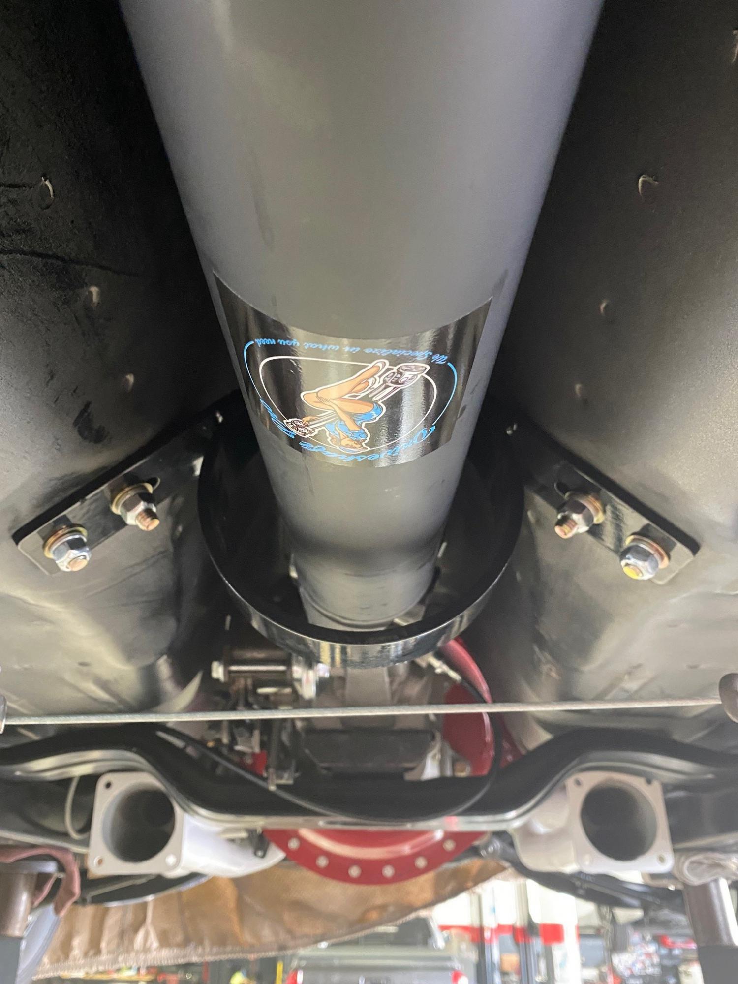

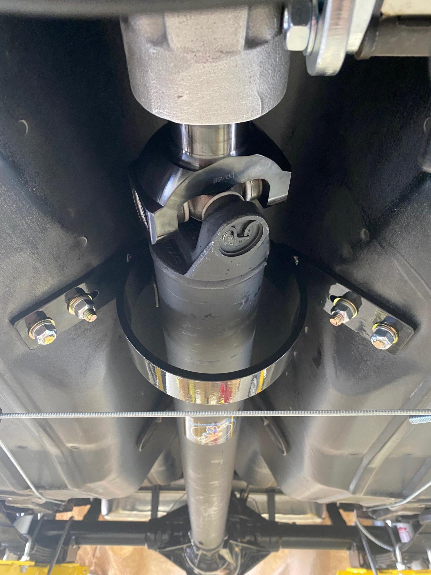

I got my driveshaft built by a local shop here, Driveshaft Pro. 3-1/2" steel with Sonnax slip yoke and 1350 Spicer u-joints. I was reluctant to add holes to my virgin floors for a driveshaft loop but decided it was for the best. I had an old Lakewood universal loop but didn't like how it fit, seemed too many mods to the floor would be needed and there wasn't much clearance with the larger than stock u-joint and drive shaft. I ended up buying a loop from Metco Motorsports which mounts to the tunnel instead of the floor. Lower profile and more clearance as it is perfectly round and has a 6-1/2" diameter.

Loop install...
