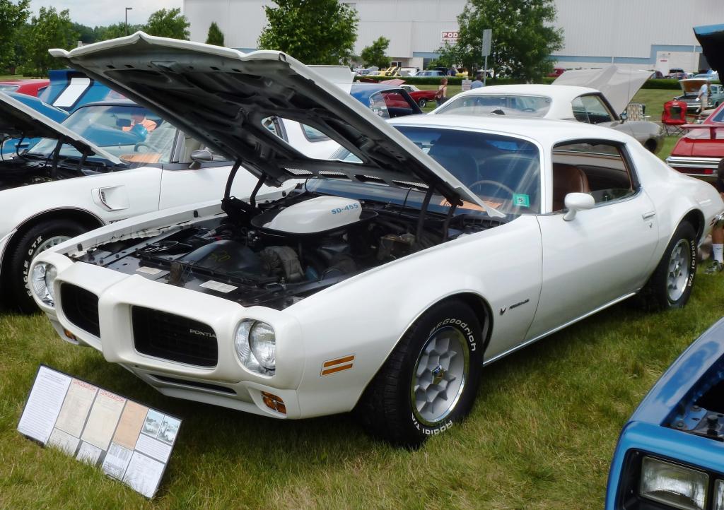

My son and I drove the white car out to PA to the Performance Years show in Hatfield. It is about 40 miles but takes over an hour as it is in the middle of no-where. We had a bunch of fun. He has been looking for a 1998 to 2002 Trans Am and spent most of his time touring that area of the show. Nice to see that he is getting in to cars at a young age - gives us hope for the next generation of carguys!
Here's the white car on display in the field:

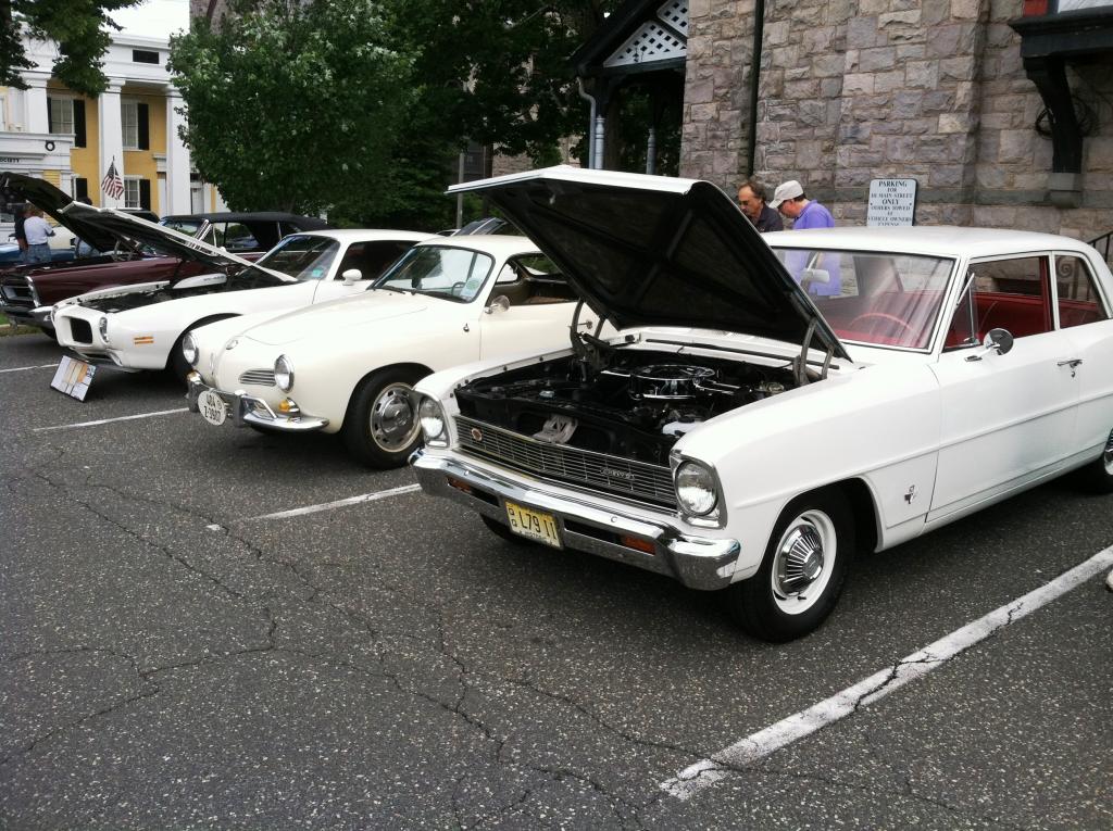

And on our way home we stopped at the local cruise night in Flemington, NJ. Another eclectic bunch of cars showed up last night. What's the odds of parking next to a white Karman Ghia and a white L79 Chevy II?

Cool pics Steve! Car looks great [img]<<GRAEMLIN_URL>>/headbang.gif[/img]
