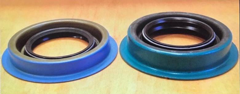

The truck seal does work in the car housing. It puts the rubber lip in a different location deeper in the housing. As long as it's not too deep it will work with no problems. Some of them are made too deep and will cause problems. You just have to be sure that you check it when you install it and be sure that the rubber is not making contact with the bearing.
Freddie
Old 09-12-2023, 05:39 PM
RPO LS7 RPO LS7 is offline
Join Date: Dec 2008
Location: Ont. Canada
Posts: 116
Thanks: 129
Thanked 41 Times in 13 Posts
Thumbs up
Agreed, Fred. I post this photo solely for future reference.
