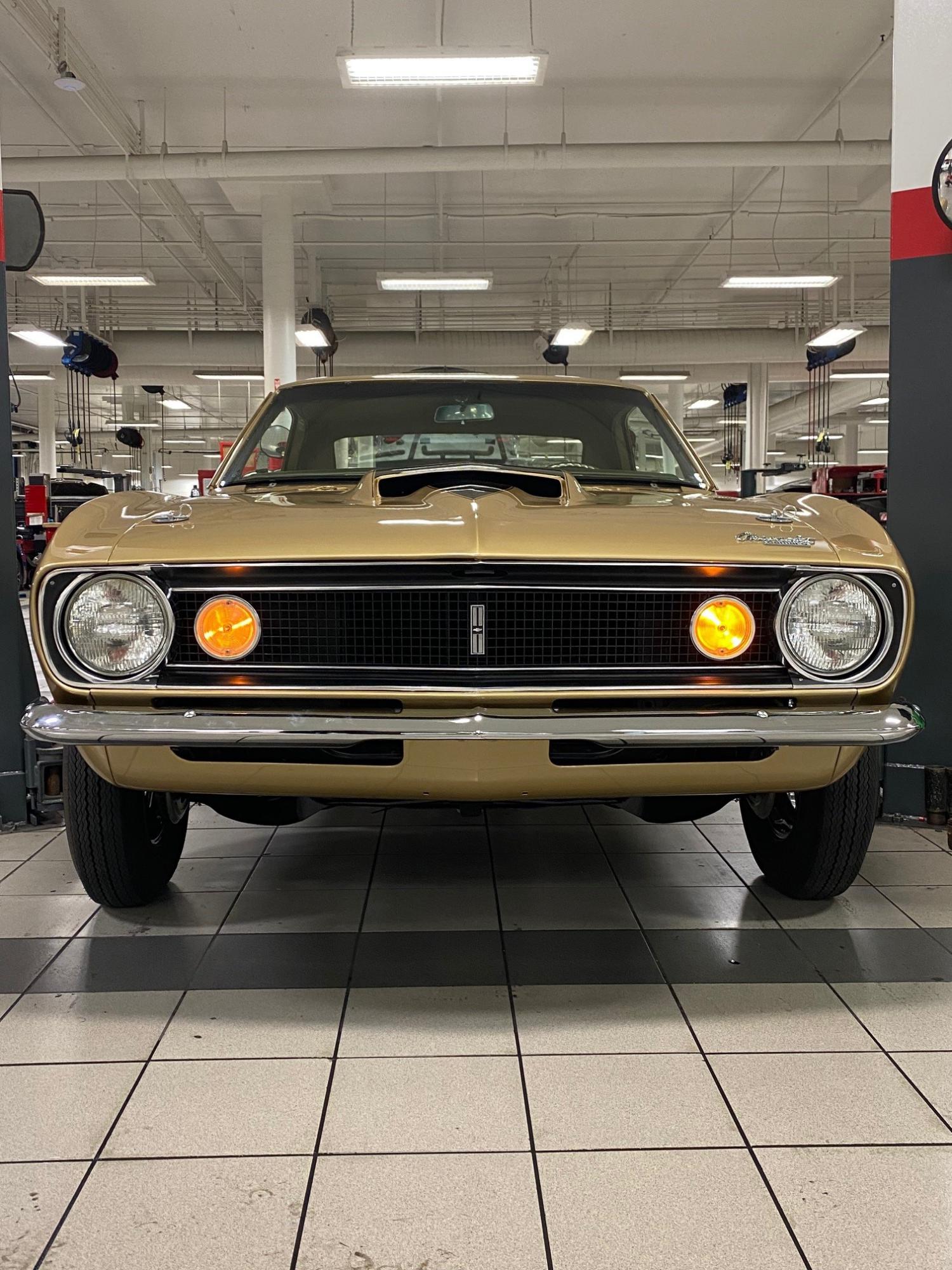

Finally got an NOS GM lower valance. It fits pretty good. I really wish I would've tracked down an NOS grill and grill moldings. The grill and grill moldings are reproductions from Heartbeat City, not sure of the brand. Driver side headlight molding is an NOS GM piece and passenger side is an OER piece. I was pretty impressed with the fitment of the OER piece. The headlights are reproduction T3s and the parking lights are the originals, amazing how nice the aluminum cleaned up with a little elbow grease! The grill molding is installed to the lower valance using the correct rivet method.
The front bumper is also the original piece and was rechromed by Meclec Plating in Fresno, CA.
As with everything, the original hardware was reused even the original headlight molding screws which have a very small E on the head of each of the 6.

Your car looks killer Chuck!! You nailed the stance!

OK Mr. Goldfinger...I gotta ask?
When do you bring it home? Or does Goldfinger get to live in that big fancy shop forever. Oh and I see a couple drips and some dirt on the floor there. Don't they have automatic sweepers and floor polishers to clean those floors every hour?
Must be nice to have that kinda storage buddy.
