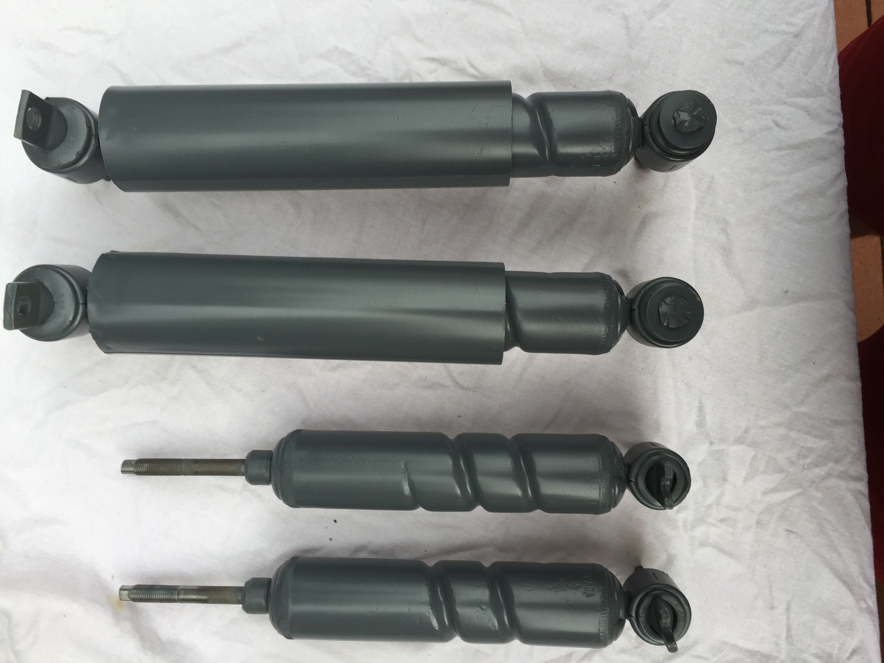

I've being collecting parts since 1997 when I bought it. Carb, alternator, distributor, p/S pump, fuel pump, thermostat housing, starter, water pump, 4 blade fan, manifolds, all pulleys and brackets are 100% date coded. These parts have not been cheap by any means.
Most difficult to find were the shock$$$$, they are currently being restored by Dan. Should be done by next week. Lots and lots of other correct date coded parts throughout the chassis. Amazing you can find part numbers or stamping on the smallest parts.

Here are pics of the restored shocks.
