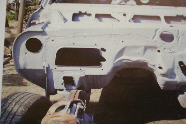

Here are pictures of firewall of the car in question. How many things can you see wrong or missing on the March '69 Norwood built ZL1 # 48 firewall???

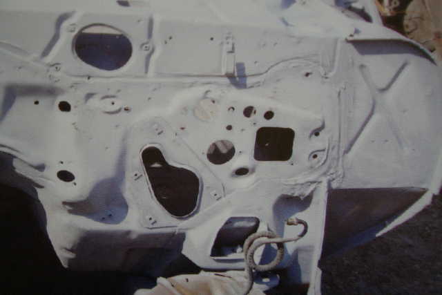

Default Re: ZL1 # 48 coming to Barrett-Jackson
Closer pic...

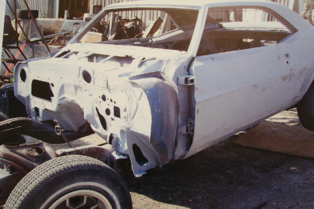

Another pic...
Side pic...at least it was blue...

<div class="ubbcode-block"><div class="ubbcode-header">Originally Posted By: camaromb</div><div class="ubbcode-body">Another pic... </div></div>
Here is why I am asking. If that is the car in question, and if #48 had no console guages, and #48 had a tach (yeah, I know, three &quot;ifs&quot then there is a problem. Should have a 17/32 hole directly under the fuseblock hole for the tach wire.
Like this:
