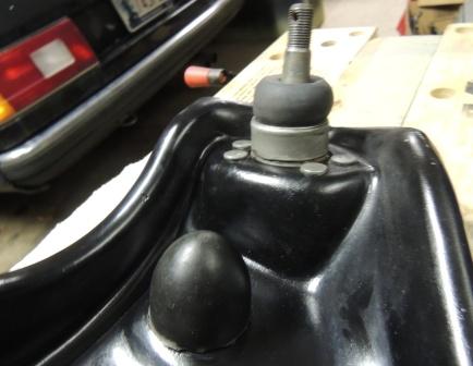

Upper control arms are going back on for hopefully the last time.
There was zero wear in my upper ball joints, so I just cleaned them up and replaced the boots. Went a little nuts detailing the rivets and ball joint, but at least they shouldn't rust! I actually did the control arms about 14 years ago. Shot some synthetic grease in them (that's why it is red).
Installed NOS snubbers. I believe they are maybe 1/8 too long, but that is OK with me. Using some springs that are stiffer than stock and bring the front down about 3/4 of an inch overall, so distance from snubber to frame should be just about right. My old snubbers were hard as rocks.
As I said, I am using quite a few aftermarket bolt ons. Went with the graphite impregnated poly bushings up front. These and the springs (and the Koni adjustables) would be very easy to change out if I decide I need it 100% stock. Still have some original Z springs.

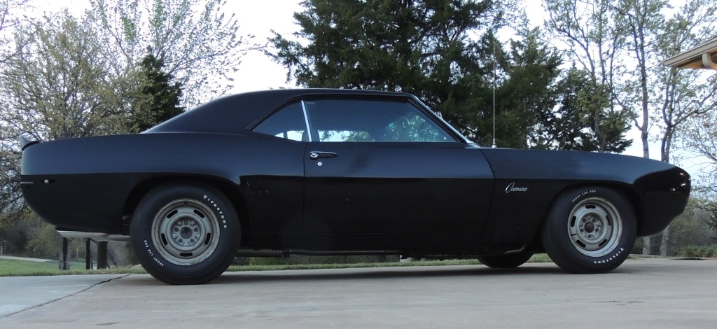

Now have 50 miles on the car!!!!
Guess I should put headlight in it. All the rest of the lights are in. Tail lights are old and crappy, but I will have to pull them out to paint the trunk anyway.
Other than a few glitches like stuck posi clutches(see here: https://www.yenko.net/ubbthreads/ubbt...hes#Post525372) and a stuck horn relay (runs the batt down pretty fast), I am very pleased overall.
Took my camera to the shop yesterday in anticipation of taking some good detail shots, but ended up sidetracked (buddy brought his just finished 68 Z by and we went for a ride, etc.) and spent all the rest of the day getting the exhaust on. Had to hurry home before dark (see above).
Will get some shots this week. Sits great. Stock rear springs, with a about a 3/4 inch drop in the front. Maybe a little less. Have the adjustable Koni's set about 80 to 90% firm so it is nice and stiff.
I had also planned on tuning it yesterday, but ran out of time. I had just eyeballed the points, set the timing by ear, and haven't even set float leves yet!!!! I don't even have a dwell meter or timing light at the house. Still it runs very well. Punched it while rolling in 2nd gear and the rear tires went up in smoke. Will get things dialed in this week.
Then all I need is stripes, a day or two wet sanding and a good buffer. Oh, and playing with wheel combinations, restoring the YH ralleys, ..... on and on and on I guess.

Think I have the mechanicals all worked out, other than the posi clutches still being stuck. But, waiting on some big tires to put on the rear and will go do some figure 8's. Not sure if these E70 15 bias ply tires can overcome the stuck clutches.
Set it up to sit 5/8 inch lower in the front. I used 1970 big block Chevelle springs with one or two coils (can't remember which) cut off and a 3/8 hard rubber spacer under each spring. I still have my original Z springs in very good condition. They haven't been in the car since 1977. The extra firm springs along with the Koni's adjusted 80% firm make for pretty stiff, but still tolerable ride.
I have the ability to lower the rear by 1 inch in about 15 minutes without lowering blocks. I may have to when I put the 275 60 15 tires on the rear just to keep the stance the same.
