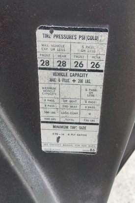

But that chart isn't correct you posted either. Plenty of 383-2bbl Chargers out there with AC. I owned one. Here's the tag.....
69...383-2bbl, G-Code. [img]<<GRAEMLIN_URL>>/grin.gif[/img]
Unless that means 383-2bbl 4 SPD cars, and in that case, I haven't come across any 383-2bbl 4spd cars, much less ones with A/C. [img]<<GRAEMLIN_URL>>/dunno.gif[/img] And I believe the reason for that, no 383-2bbl 4spd cars that is, is that the 2bbl exhaust manifolds do not clear the Z-Bar for the clutch linkage. I know this because I converted that car to a 4spd and had to add HP exhaust manifolds. That 2bbl log dumped right where the Z-Bar mounted.

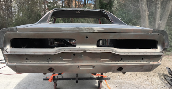

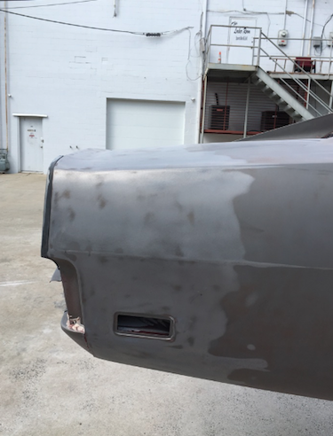

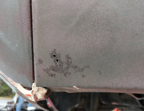

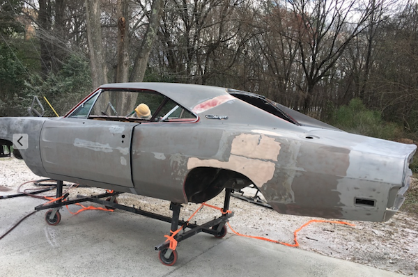

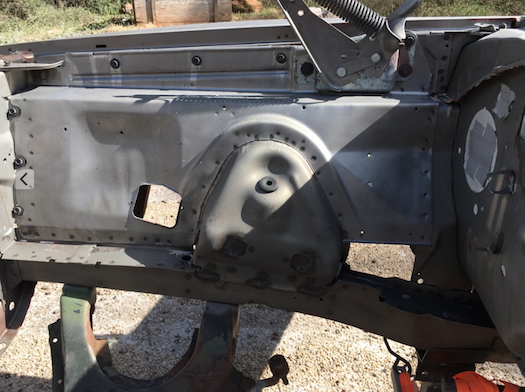

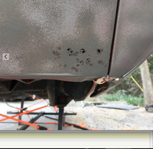

Here are some pics after the car was soda blasted. A few spot areas will be sand blasted but nothing major. The ole' girl was backed into or something similar based on the bondo on the left rear quarter. I knew it was there so no surprise there. Also knew of the front right fender above the bumper getting tapped. The only real surprise is that the front left fender had been replaced. Apparently back in the day best I can tell it is a Chrysler piece. Also there are a few pin holes in the corners of the lower valance, but thankfully nothing major. The trunk pan is questionable. Just the center section needs to be possibly replaced. I will let Ronnie the painter let me know his thoughts.

I want to try and save the original headliner. Maybe a mistake?? That is the reason the Charger emblems are still on the sail panel. The painter was going to remove the bottom of the headliner and then remove the emblems. We will see, maybe just install a new headliner?

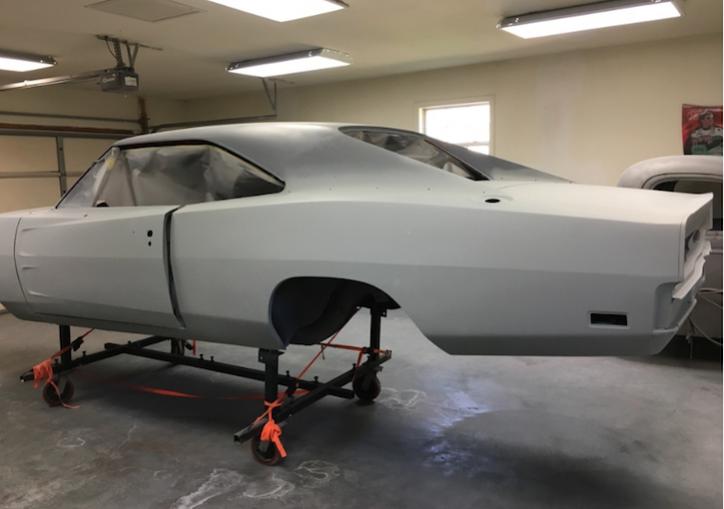

The body dings are fixed and the paint process begins.
