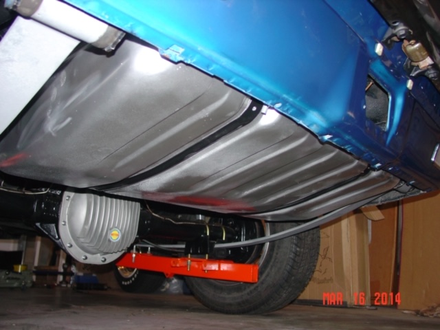

Tank straps are painted black, not sure if 30 or 60% gloss. Photo of my strap below, original black paint evident where the strap was tight to the tank.
