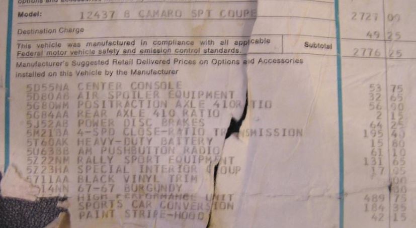

This would be a 'rare' triple COPO. Supposedly ordered out of Courtesy Chev, Sebring, OH. The hood stripe was a single Z/28 style stripe down the center of the hood and upper grille panel.
A ZL2 SS is also known to have the COPO stripe.

[QUOTE=William;1452996]This would be a 'rare' triple COPO. Supposedly ordered out of Courtesy Chev, Sebring, OH. The hood stripe was a single Z/28 style stripe down the center of the hood and upper grille panel.
William .....does the car exist ?
