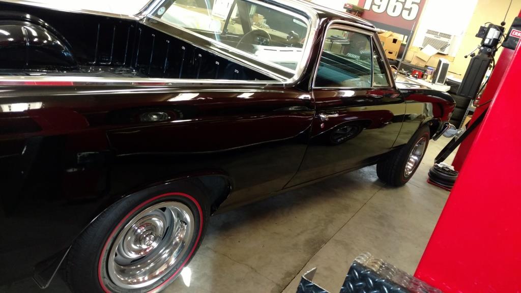

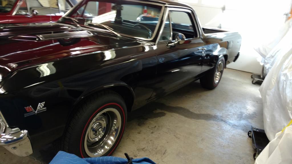

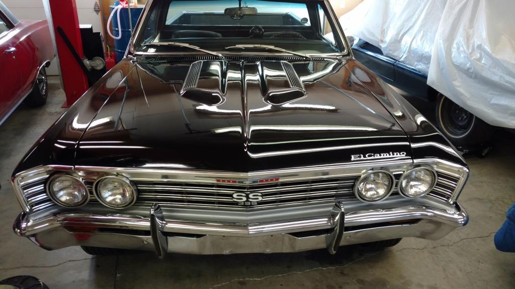

Before

The body was about as straight as one could hope for. The Malibu side trim had been removed, bucket seats added, an SS hood added, and some SS emblems. Re-opening the oval side trim clip holes in the exact correct locations and shape took some very careful work by Terry Davis, but he handled that flawlessly! And all the floor pans were in immaculate condition (other than the holes drilled for bucket seat bolts, which were an easy fix). The only rust repairs required were at the bottom corners of the back glass, and behind the right rear wheel.

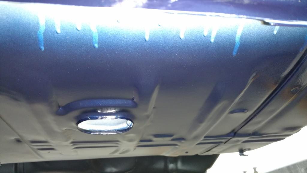

- We put visible runs on all the parts where the factory did. We dip-painted all the control arms and all the front inner sheet metal (even the bottom of the hood) just as the factory did, and hung each part from the same hole as the factory to get the runs going in exactly the correct directions.
- The tear down revealed the typical KC plant green primer along the inner rockers, which had huge runs going down onto the floor pans. We turned the body upside down on the rotisserie, painted the green where it belonged, then nuked that seam with green and quickly spun the body back over, which achieved an EXACT duplication of the factory runs. Then when the deepwater blue overspray was applied to the floors, it gave an EXACT duplication of the way the original runs looked, being bluish green on the side toward the rocker, and all green on the inside side!

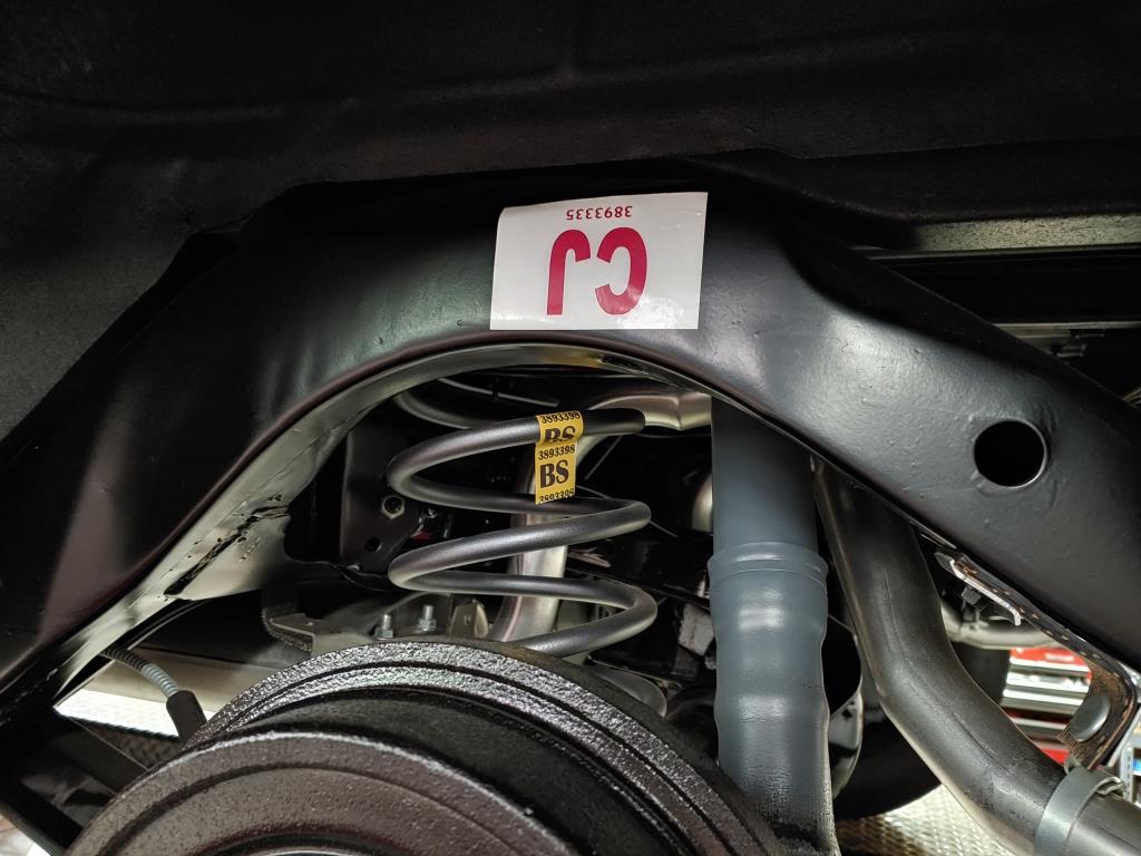

- Frames were dipped at the factory too, hanging vertical from the rear crossmember. But I could not afford (and was not quite crazy enough) to build an 18 foot deep vat and buy that much paint! So Terry borrowed a friend’s boom truck and hung the frame vertical from the rear, built a 20-foot high scaffold beside it, climbed the scaffold and painted it hanging that way to recreate runs that are now horizontal to the ground!

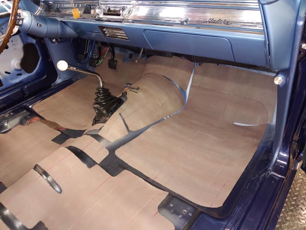

- Original KC floor sound deadener had a brown paper top layer, not black like the repros. So I dyed the repro the correct shade of brown, and added the red lines that are present on originals. Yes, most of it is under the carpet now, but I also cut the carpet to factory specs so that there is no carpet under a large portion of the seat. So if you lean in and look under the seat, it is like looking at a picture of a brand new Chevelle taken in 1967!

I also made all my own frame ID sticker, spring tags, wiring harness tags, and various other ID tags and stickers, which are EXACT duplicates of originals with the EXACT correct numbers and codes (not the generic font / generic code junk sold by the repro vendors).

Some of the crazy stuff
