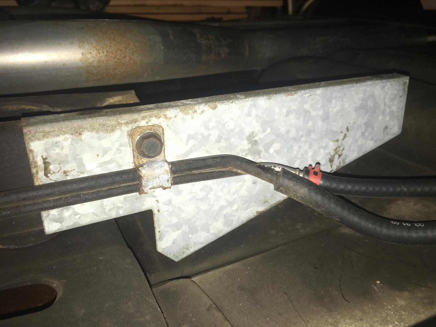

ive noticed things like coil brackets to be galvanized. there some stuff unique to corvettes that were also galvanized....

Olds (which I deal with primarily)....same thing...galvanized coil brackets, etc. Not A LOT of pieces but indeed distinct.

This is mid way on the sub frame, I cleaned it w/ WD40, you cant bead blast Galv.
