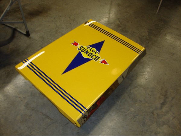

Default Front & Back Panels
My Painter Jeff R. did a great job, I then polished the corner stainless steel trim Vintage Logo from VIC's66. Both panels required "body" work & weld repairs to get them into usable condition.

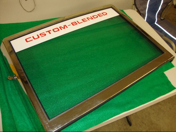

Default Window Glass
Worked on the upper access door glass, local glass provider supplied new cut and radius glass, Decal found on line, Rubber channel Trimmed then installed with Wayne glass channel plastic guides and steel retainers.

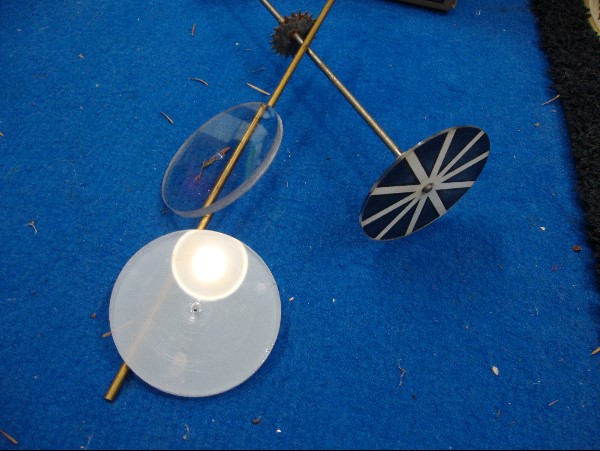

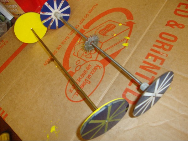

Default Fuel-flow rotary indicators
When I got the pump it was missing the premium fuel flow indicator, So I used Dad's old Atlas lathe and cut down some 1/4" sheet plexiglass & brass rod to Fab a likeness attempt. Missed the mark on a few details but It is hidden by the pump Computer facade and very little is visible. It will work for now.

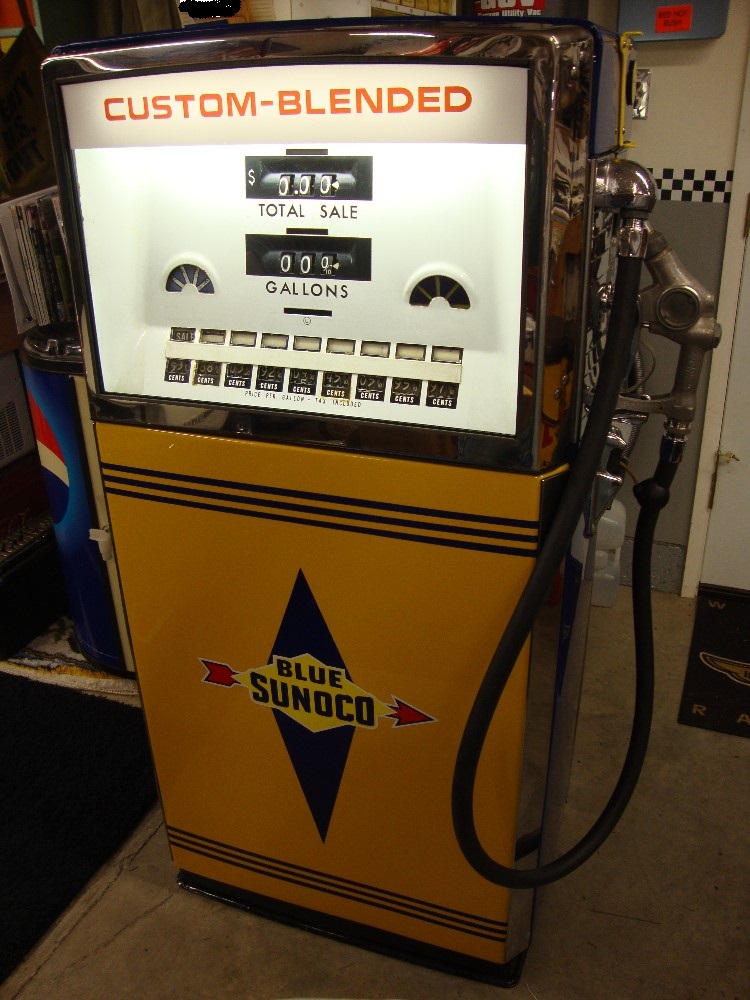

Finished; Mounted the Veeder & Root Computer, Front Facia reveals, Internal Switch.
Done
Poll: Globe Modification or Not<?>
JIM
*Note: The Computer was Solid with critter and hornet MESS, resulting in a rusted solid works. Impossible to animate with dual external dc motor drives to make the pump indications operational. I SO wanted to rig a set up that would display & learn the computer op's. Static it Remains.
