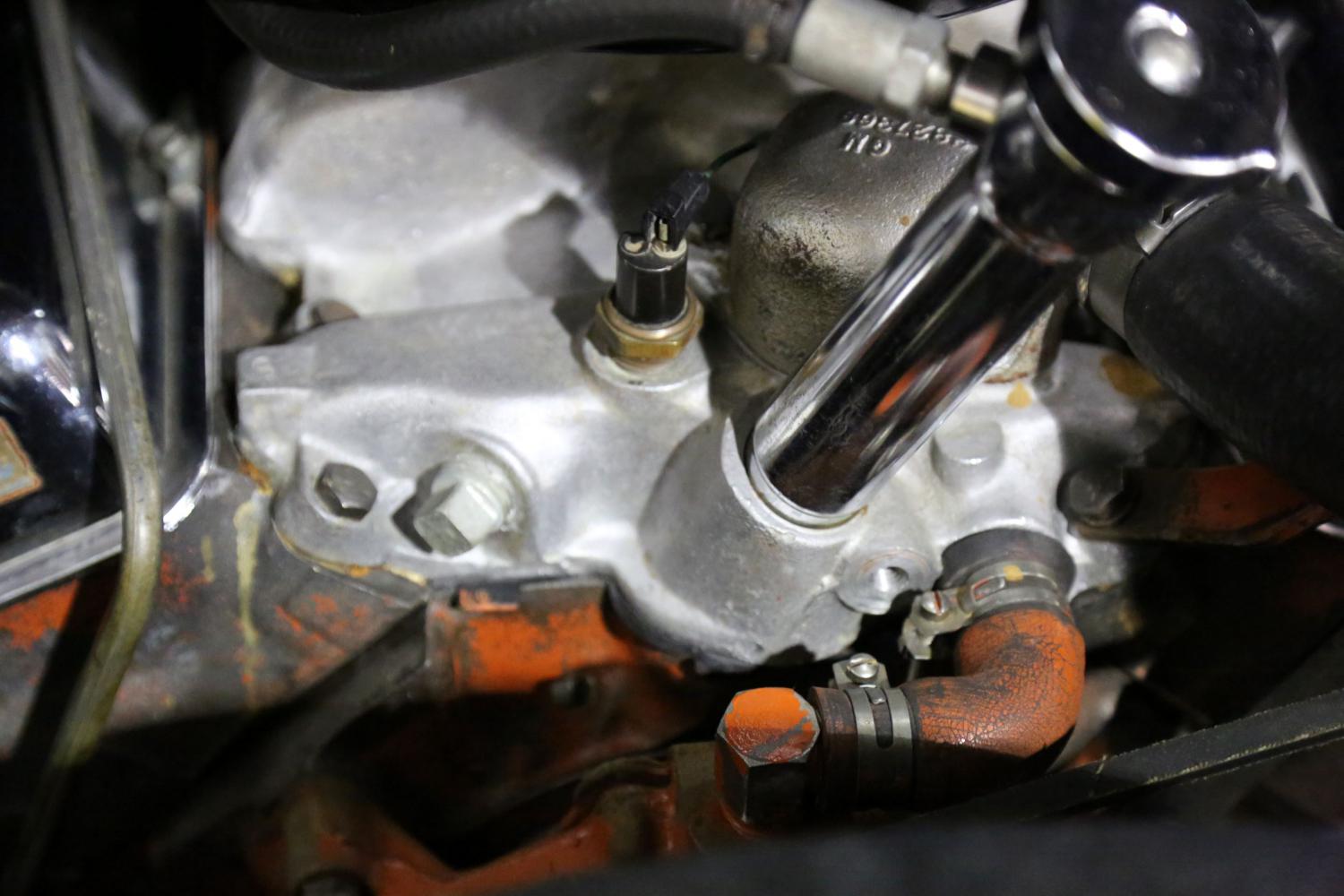

This 67 Z28 was awarded Time Capsule. It was optioned with ultra rare cowl plenum and headers.

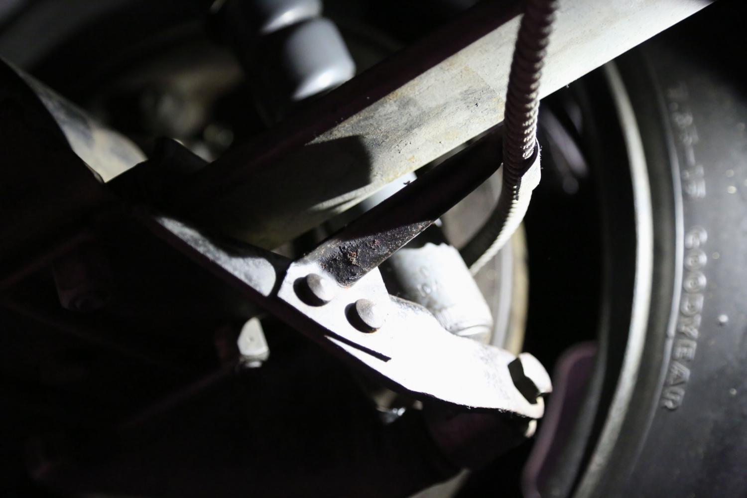

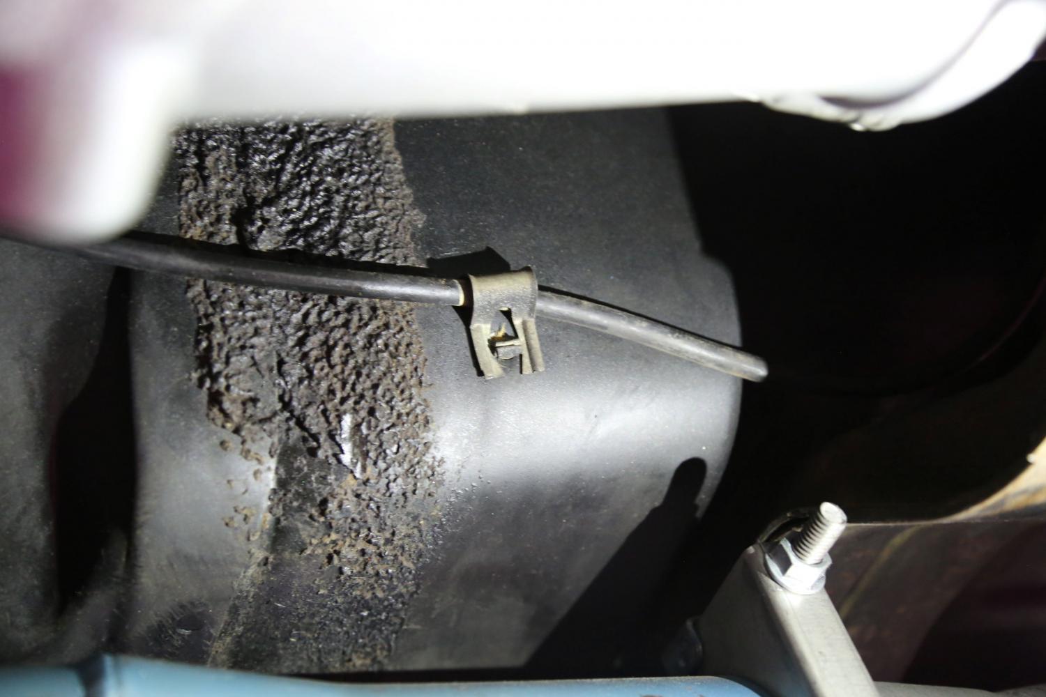

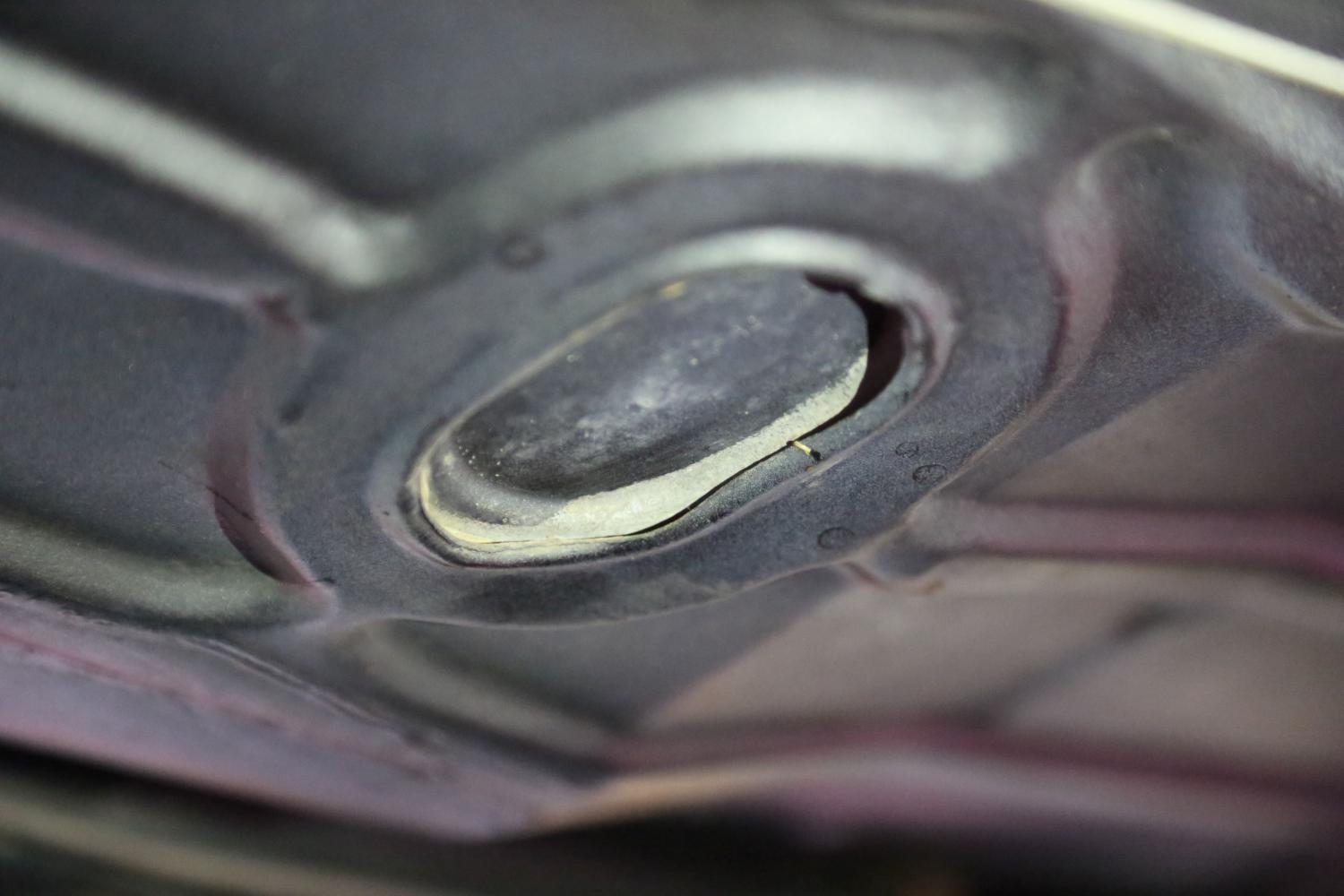

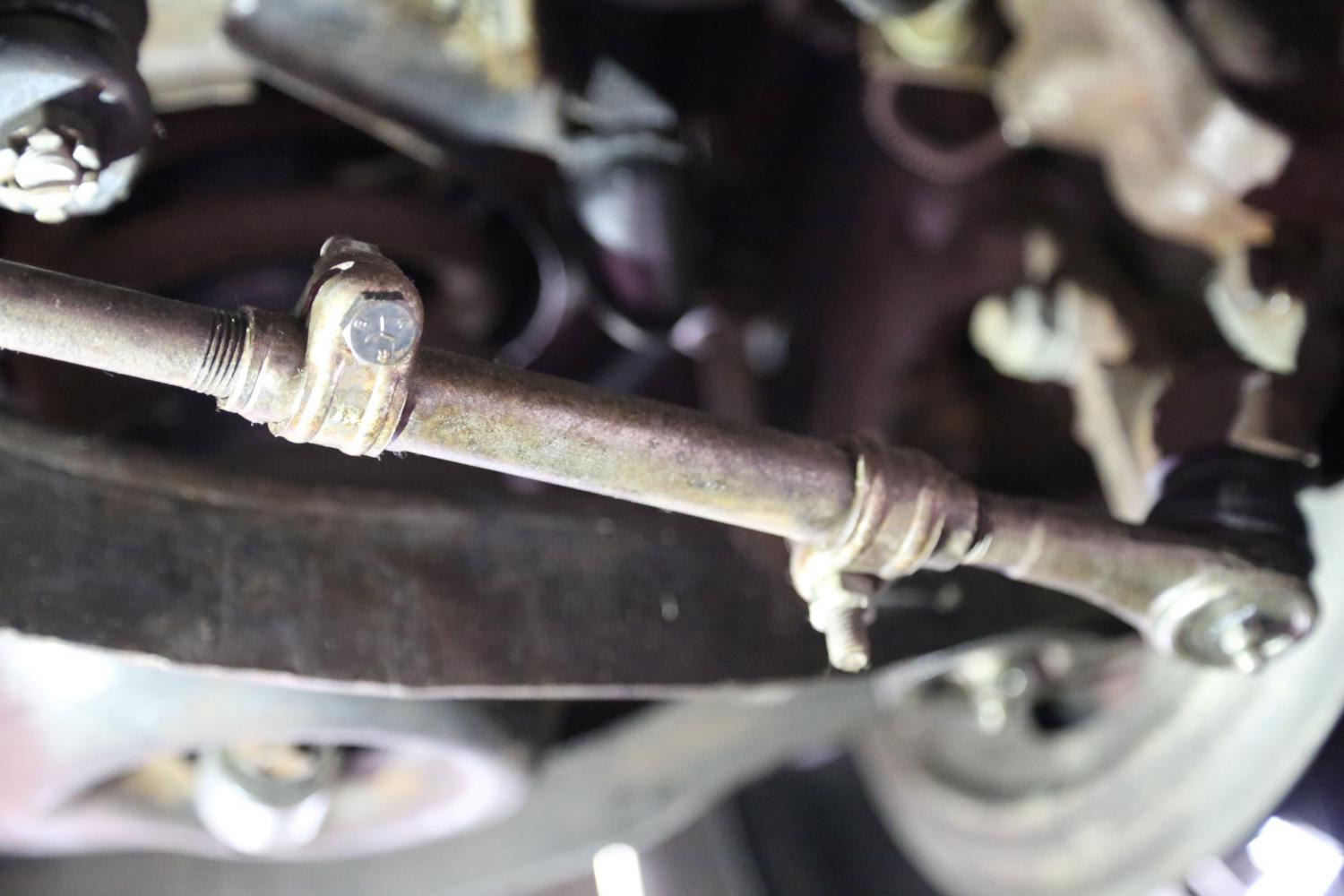

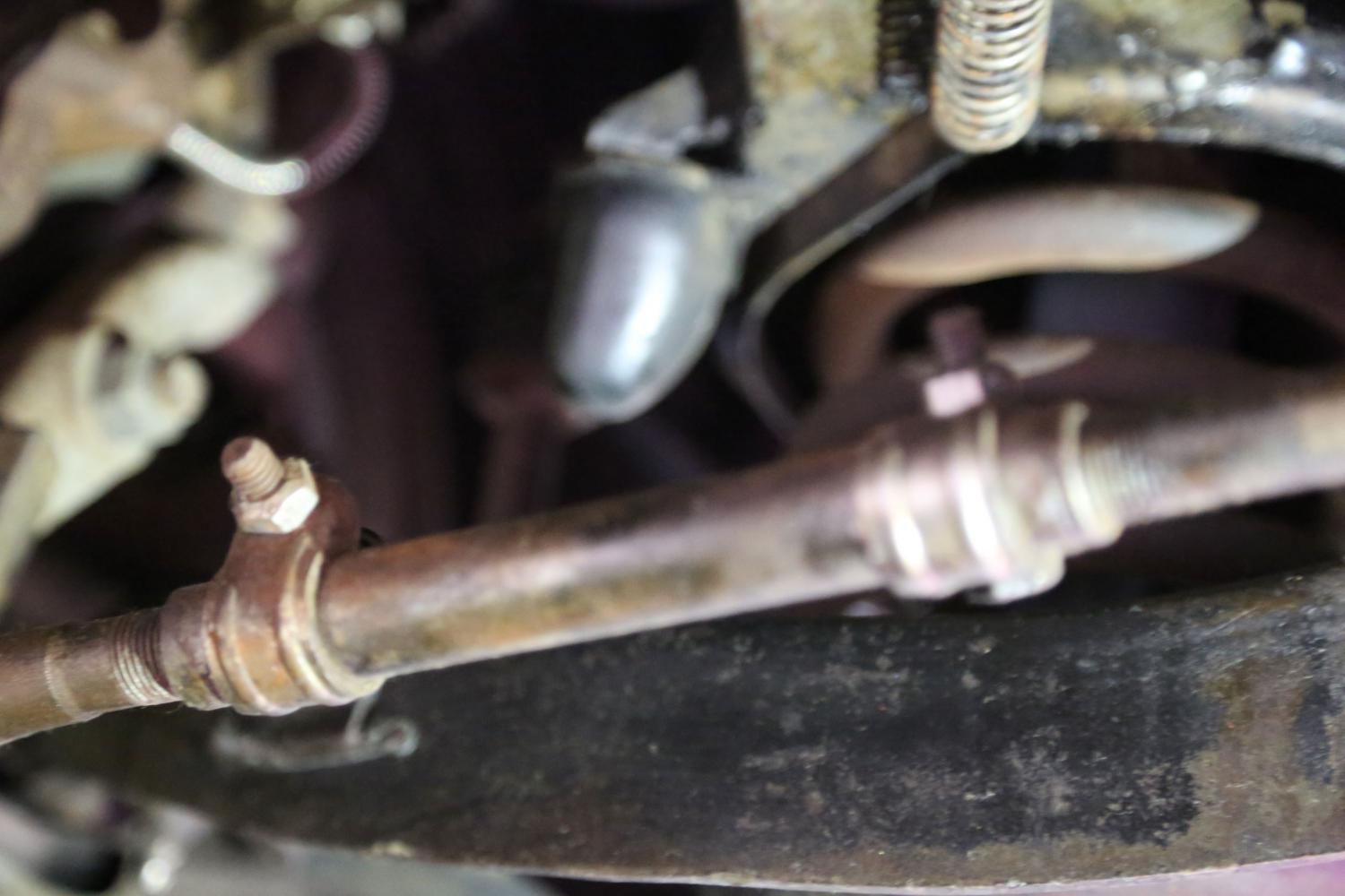

A few more pics

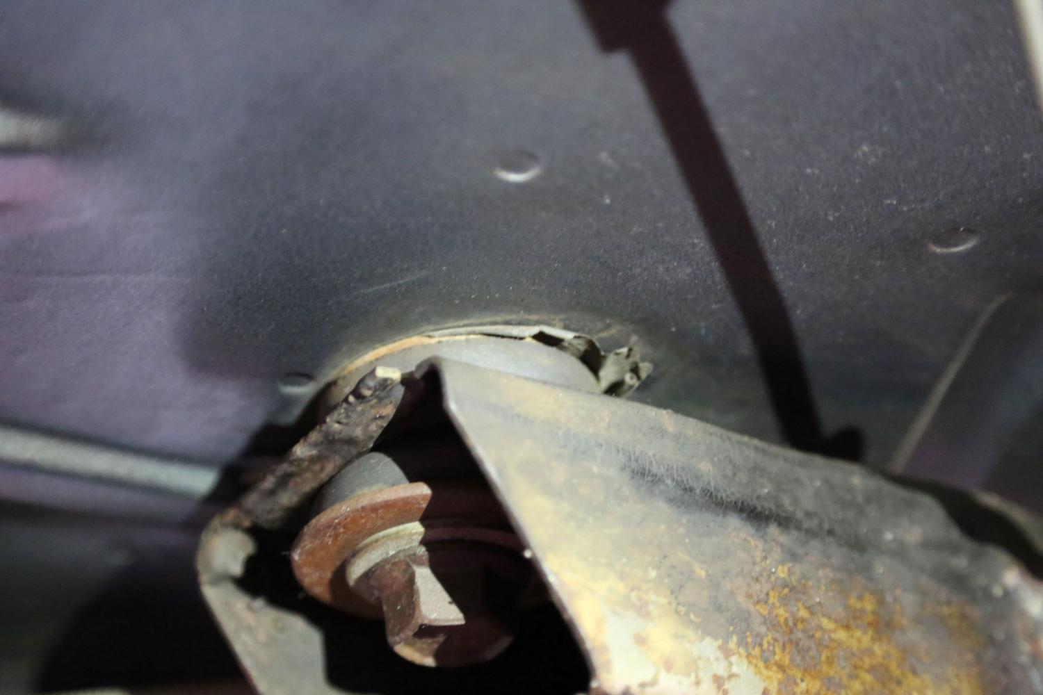

Steve, amazing pictures! Do you have a picture of the header/exhaust connection?
Photos of the original exhaust manifolds including the heat riser and head pipe cut offs that were in the trunk when we inspected the car. They were likely delivery date take offs as the they showed no signs of any wear, dis-coloring or carbon accumulation. Note the original white-asbestos donut and (correct) clocking of the heat riser valve. I may have photos of the installed headers, will have a look.
